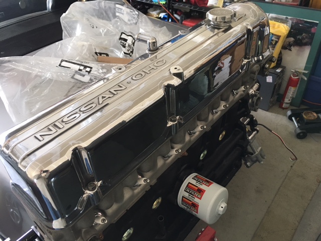

The engine builder for my Datsun says it’s a 10/10ths thing. He said only do it if you’re going for the championship or your budget is unlimited.
This makes 300HP where the original engine only made 150.
