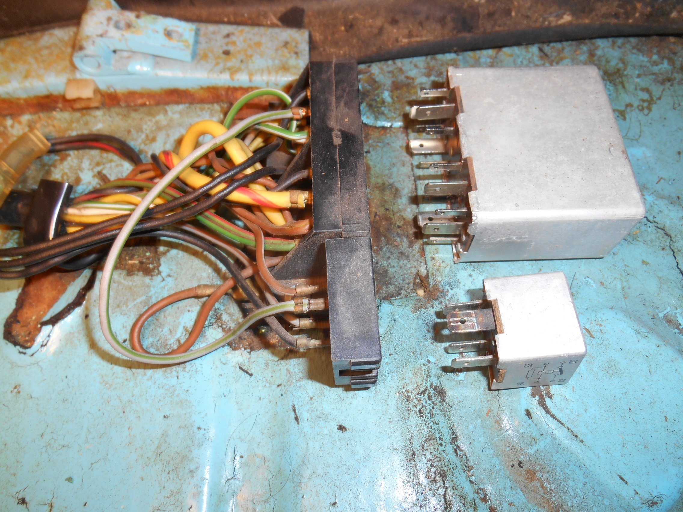

Hello my 1974 914 DOES start right up without buckling the seat belt, why? These parts shown are both connected and the two yellow wires are as the factory plugged them in. I do have a hot start relay installed would that help to bypass these connection so it starts?Attached Image

Both seats have a seat pad sensor...are yours both unplugged?

Someone probably bypassed it
