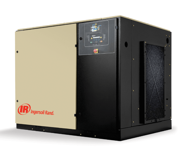

Doing heavy work, blasting, big paint jobs, entry level shop, etc 220v, 5hp, 80 gal, minimum. My compressor is 7.5/120 gal.
Smaller use I'd still get as big as I could afford.
post Dec 26 2019, 05:41 PM
914-6 GT in waiting
Posts: 19,963
Joined: 19-September 09
Member No.: 10,825
QUOTE(Mark Henry @ Dec 26 2019, 06:15 PM) *
We have a commercial screw compressor at the shop. No air issues.
