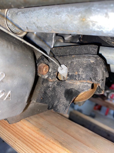

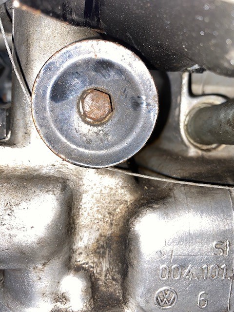

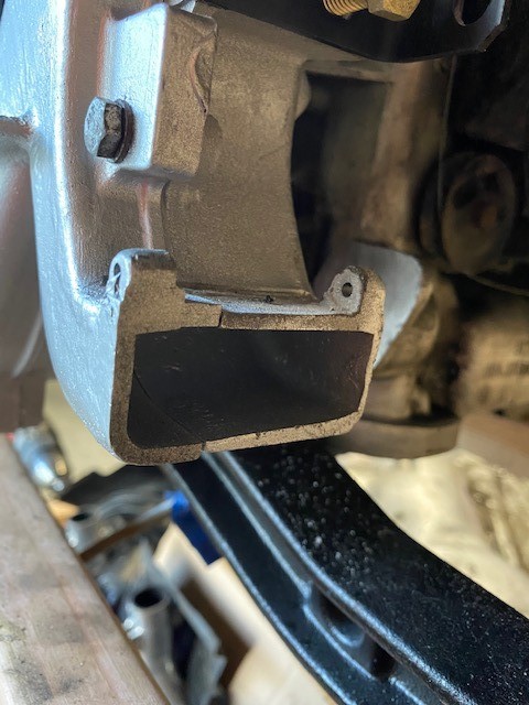

So to make sure I'm clear.....
Block this.
Leave these alone.
My thought was if I deleted all of that, the engine would actually run cooler and take longer to heat up. I live in Miami Fl so don't think I need to worry about warm up time. Is that not the case? Wouldn't the engine tin keep all of the circulation contained? These items seem to be blocking the airflow at times.
School me please. (IMG:style_emoticons/default/confused24.gif)

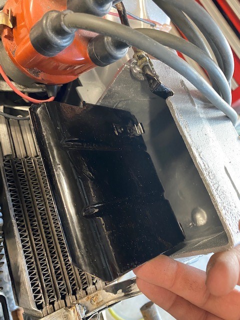

If you remove the flaps, the engine will run hotter. When the flaps are open, they divert air through the oil cooler. When they are closed, the cooling air bypasses the cooler to allow the engine to warm faster. If you remove them, you also mostly bypass the oil cooler. If you delete just the thermostat but leave the flaps, it will operate like you describe (maximum cooling all the time but take longer to warm up). The only reason to do that is if you want your engine to wear out faster. So yes, leave all the engine cooling stuff alone. Good call @porschetub !
I'm actually not sure if blocking the outlets in the first pic is good or bad. The heater flapper boxes allow air to flow through those outlets regardless of whether they are open or closed. Not sure if that flow is important for cooling air flow or not. My hunch is that blocking would be better but I don't like to second guess the engineers.

The cooling flaps warm up the engine in a controlled manner it has little to do with the climate in your area,make sure it all works correctly,none of these parts removed will improve cooling.
Porsche never installed spare parts on motors that were not needed regardless of model.
Try to find the little alloy flaps and pivot pins to block off the heater ducts,on my last build I just installed some small alloy tabs to hold them closed.

BTW, I notice you are missing the linkage that pulls the flap over the oil cooler up. You'll want to make sure that is installed.

QUOTE(bbrock @ Dec 28 2019, 05:52 PM) *
Thanks @bbrock
Yep didn't install the linkage for the photo op. I'll get it installed and follow what you and @porschetub said.

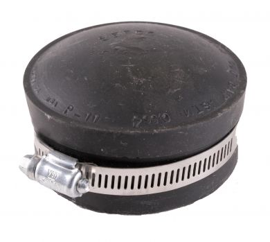

QUOTE(Steve @ Dec 28 2019, 01:03 PM) *
Just cap off the long tubes in the engine compartment. I used hose clamps and thick plastic like a tarp.
These work great also. Available in the plumbing supply section of your hardware store...
