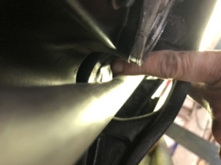

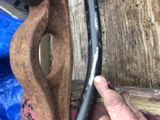

Hey guy, I have found the problem. I removed the long shift tube and conspired to another one, much different when laid side by side. I think it could have been twisted some. Install the other one, have plenty clearance at the motor mount bar and 4th goes in easily now. I’ll try to send picture showing new tube and good clearance, also the bad where it was rubbing the mount bar hole.
Maybe the pictures will explain all my rambling earlier.
