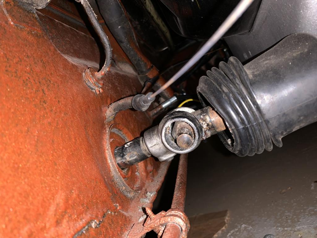

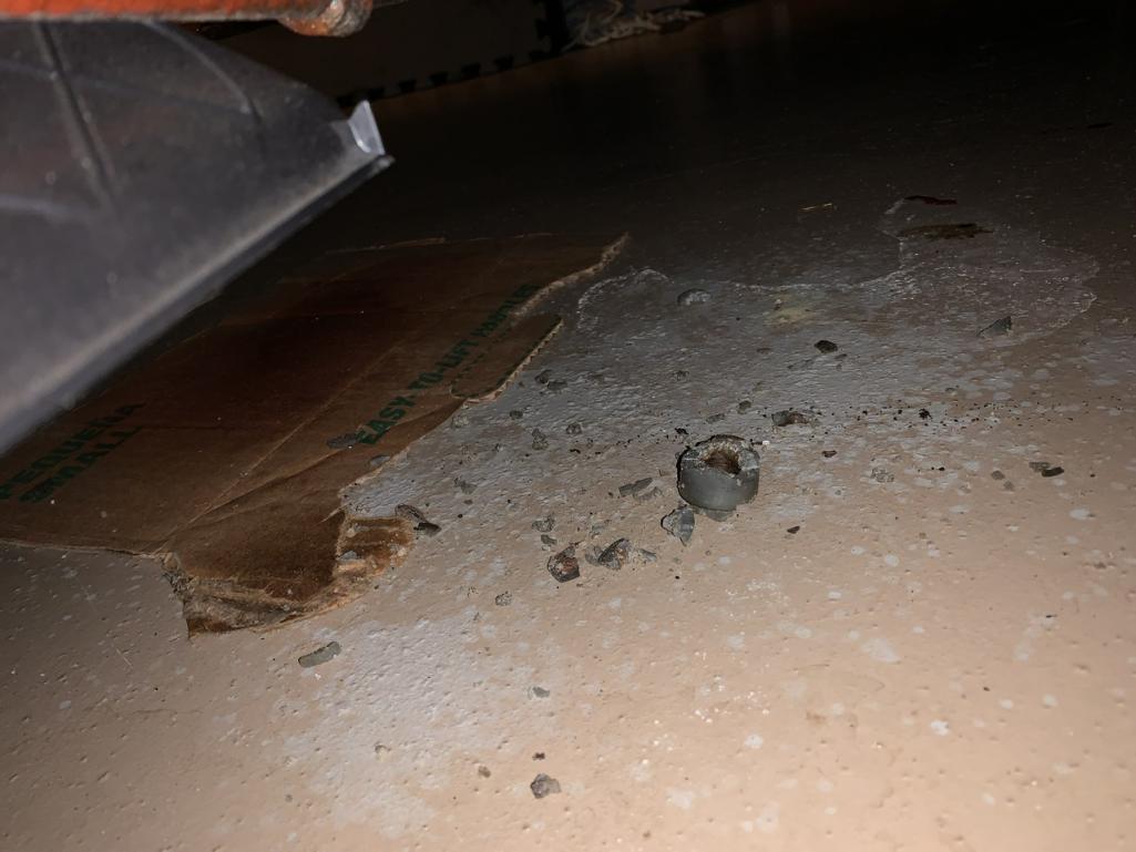

I have been driving the 914 this week to work , perfect weather and better gas mileage than truck, anyway sudden loss of all gears but 2&3, had just left neighborhood so put car back in garage and last night I found that the shifter coupling bushing was completely gone, all the parts still inside the dirt boot cover, and of course this is a bushing I overlooked last time the motor and trans were out of the car!
It may be the original one . At first I thought I had a cone screw back out but on further inspection found this to be the culprit.

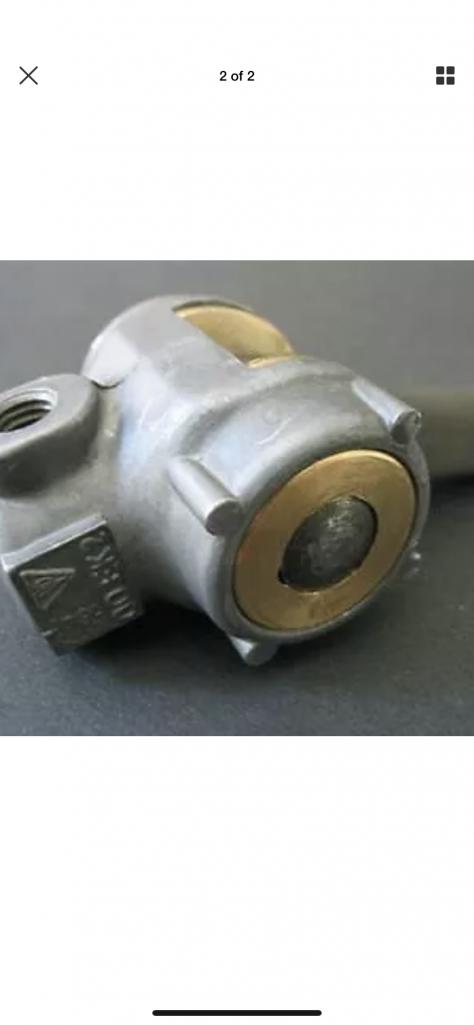

So I see that there are 3-4 variations of these from bronze to stock to poly.
I am wondering if it’s worth spending the extra $25 for the brass ones? Seems there are not any available that I can get over night to get car back on road before next weekend which is a bummer. So any money have suggestion are appreciate, also do we use any lube on installation.
Phil
This brass one looks pretty good how do the work?

They're awesome. You won't regret buying them. And you'll notice the difference immediately. (IMG:style_emoticons/default/beerchug.gif)
914Sixer
post Jan 10 2020, 10:06 AM
Posts: 9,179
Joined: 17-January 05
From: San Angelo Texas
Member No.: 3,457
BE Careful when buying bushings. There are TWO types. One is an OVAL and the other is ROUND. Do not get the oval one. I prefer the bronze.

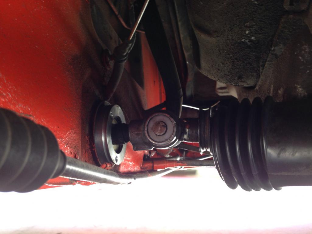

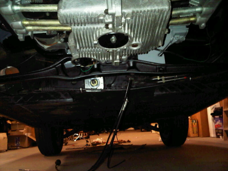

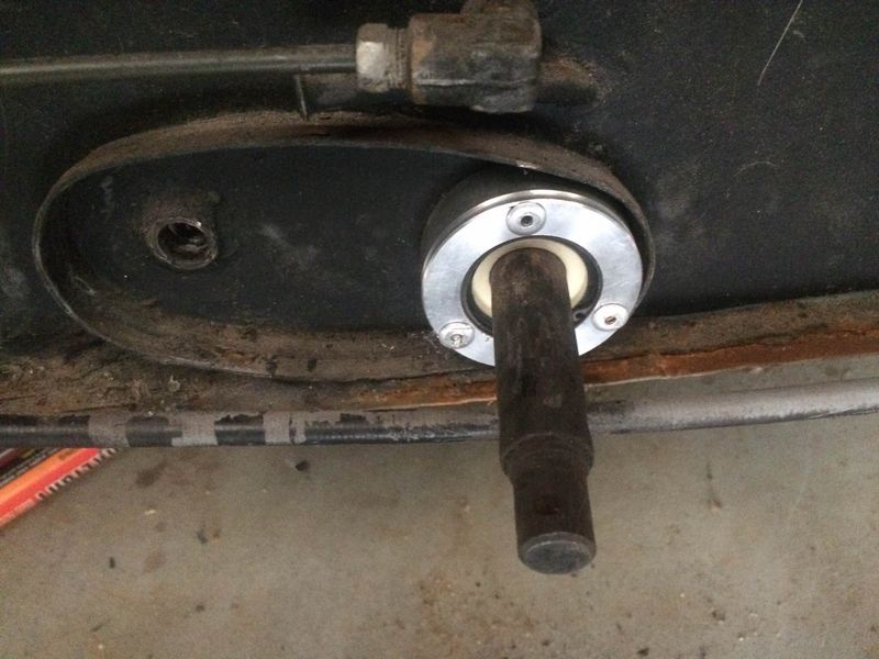

Dr. Phil, since you will be replacing the coupler bushing, you might want to replace or add the improved firewall bushing like this.
edited:
@DrPhil914 this one I installed for a friend and member here also.

Is that one Chris Foley’s or Rixx914parts?
GregAmy
post Jan 10 2020, 01:07 PM
Posts: 2,504
Joined: 22-February 13
From: Middletown CT
Member No.: 15,565
Tangerine Racing (Chris Foley). Installs in minutes.
http://www.tangerineracing.com/transmission.htm
If you really want a nice shifter, get his whole kit, which replaces that goofy plastic thing with a full U-joint. I have it on the race car and it's choice.
http://www.tangerineracing.com/shiftlinkage.htm

I installed one of Chris' spherical bushings on my '75 (the 'BB') and it really improved the shifting (along with bronze coupler bushings and a bronze shift console bushing).
Due to special circumstances, I had to modify the bushing's housing a tad to inset it into the firewall, as I was unable to engage all gears, and didn't want to go through the process to move the motor and trans rearward.
YMMV ... in normal instances, you should be able to bolt (or rivet) it to your firewall without modifications ... especially on a late model's firewall.

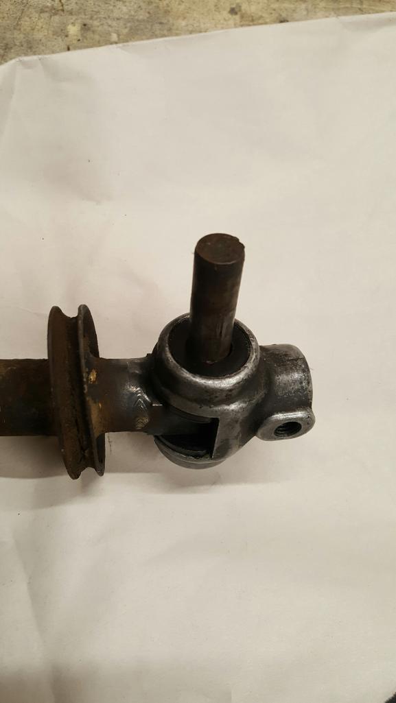

I would use a steering shaft U-joint, and figure out the spline on the shift rod. Tangerine's kit makes a huge difference.

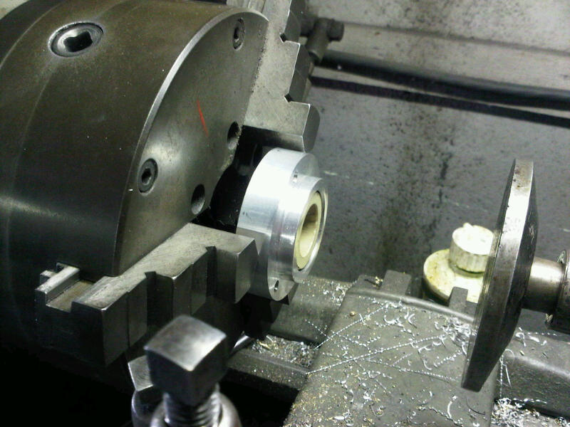

I actually designed mine specifically cor the application. Yes there is a problem with some that the hole for the pin is way to big. Mine is slightly elliptical, but not as exaggerated as the one you speak of. It allows for the pin to stretch the material slightly during installation. My arguement is if you are making an improvement, replace with a steering knuckle.
https://www.summitracing.com/parts/sum-7606...jRoCykEQAvD_BwE
Summit has them for about $45.
The question is how far fro. Stock you really want to go?
If you can easily(relative to the other option) replace a stock failed bushing for under $10, that you will probably not have to replace in you lifetime,.
Or
Put in something that will call attention to itself as a non factory modification. Some may value this, some may pay to swap it back.
I'm not planning to sell my car but I kind of look at my choice that way.
Brass or oil bronze is the next choice, but your looking at an "upgrade" that really only will cost more, as you will not recoup the cost in your lifetime.
That's my logic when I made these. It's a simple process to make in oil bronze.
If I'm wrong in my assumptions and enough folks want them, you know me, I'll make them.

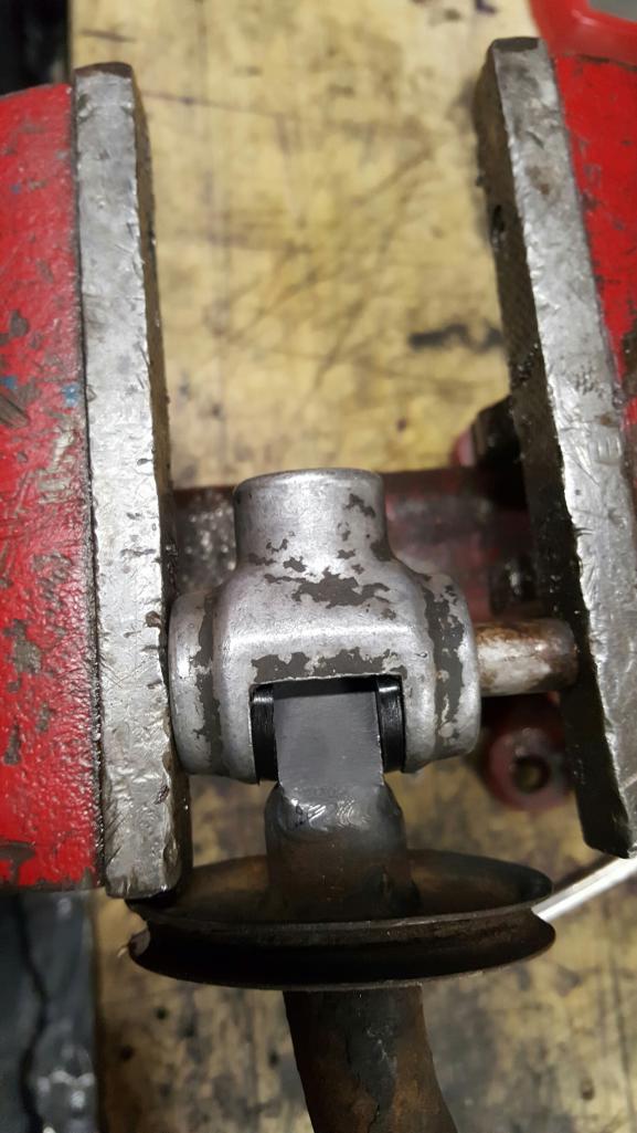

So my question then regarding using a steering knuckle, is I’d you use a stock porsch 914 knuckle? And I have 2 newly zinc plated from BD Stone, does the alignment matter.
No cost just- is it plug and play.
Phil
Mikey914
post Jan 13 2020, 01:03 PM
The rubber man
Posts: 12,772
Joined: 27-December 04
From: Hillsboro, OR
Member No.: 3,348
Post up a pic.
I think you have the steering knuckle, as I know he plated them. The knuckle used should be on the shaft as the pin hold it on the knuckle. The aluminum will not plate (unless you add copper), so I'm wondering what ya got.

And these easily pres in with a bench vice
