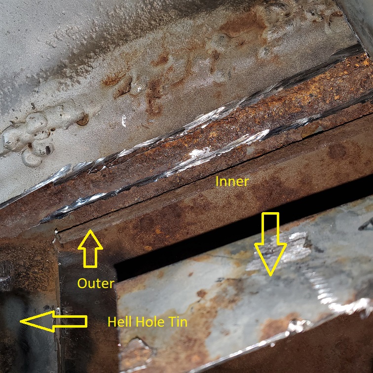

I’ve shared some pictures here before but want to get going on this area repair and was hoping for some been there / repaired that.
I have Maddog’s patch panels in hand.
Start by stripping to bare metal in this area?
Thanks and hope everyone had a good weekend.

rjames
post Jan 13 2020, 01:17 PM
I'm made of metal
Posts: 4,454
Joined: 24-July 05
From: Shoreline, WA
Member No.: 4,467
Yup, it’s the only way to see what shape the metal is in around the rust holes. Looks like the PO did tried to repair it, but they must not have prepped the area properly given the rust holes around where the welding was done.

TargaToy
post Jan 13 2020, 02:39 PM
-NONSOLIS RADIOS SEDIOUIS FULMINA MITTO-
Posts: 714
Joined: 26-March 10
From: DelMarVa Peninsula
Member No.: 11,509
I do not wish ill on anyone, nor do I want to imply there's more trouble there than meets the eye... however... With those gaps between welds, there's a good chance water has continued to make its way inside your long. You may want to cut the bad patches out and have a nice look-see before continuing with repairs.
Do you have access to a borescope? That would minimize the cutting.
bretth
post Jan 13 2020, 03:02 PM
Posts: 899
Joined: 23-June 15
From: Central TX
Member No.: 18,882
It looks like it is only tack welded in. Worried about the structure of it.
jimkelly
post Jan 13 2020, 07:00 PM
Delaware USA
Posts: 4,969
Joined: 5-August 04
From: Delaware, USA
Member No.: 2,460
i was thinking the same thing?
QUOTE(bretth @ Jan 13 2020, 02:02 PM) *

Thanks for the responses and considerations, this is a southern California car that I believe was garaged after the repairs were made, so it may not be that much worse. In other news pigs fly.
The borescope is a good idea, let me get that out and see what it looks like. The suspension consul is good and I’ve got good door gaps still at least.
Thanks again.
cary
post Jan 13 2020, 09:37 PM
Posts: 3,900
Joined: 26-January 04
From: Sherwood Oregon
Member No.: 1,608
I think what you'll find is they laid new metal right over the original hell
hole metal. I've seen it about 10 times.
Now the issue is the cut out. You need to peel back the onion.
Don't cut thru the stiffener tops on both the inner and outer walls.
aggiezig
post Jan 13 2020, 11:27 PM
Porsche Wannabe
Posts: 321
Joined: 13-January 16
From: Austin, TX
Member No.: 19,557
Like cary said, start peeling back the onion layers... Godspeed & keep us posted!

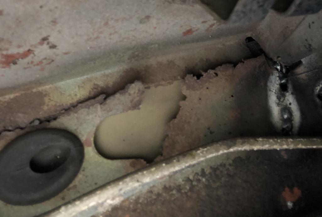

Tdskip
post Jan 14 2020, 03:07 PM
Posts: 3,783
Joined: 1-December 17
From: soCal
Member No.: 21,666
Underside looking up.
They patched right over old metal.
post Jan 14 2020, 03:13 PM
Resident German
Posts: 42,483
Joined: 21-January 03
From: Oakland, Kalifornia
Member No.: 179
QUOTE(Tdskip @ Jan 14 2020, 01:07 PM) *
(IMG:style_emoticons/default/icon8.gif)
burton73
post Jan 14 2020, 03:14 PM
Senior member, and old dude
Posts: 4,025
Joined: 2-January 07
From: Los Angeles
Member No.: 7,414
This is why we have to assume that most 914 for sale that have been fixed have been patched like this. That and they NEVER have under 100,000 on them inless there is proof.
Cars for sale that have shiny paint need proof of rebuilt body as far as rust goes.

post Jan 14 2020, 03:22 PM
Posts: 714
Joined: 26-March 10
Member No.: 11,509
Looks like they patched right over the shelf attached to the upper long in that latest pic from the bottom side. I'd still send that borescope into the hell hole in the top of the long itself just to see how bad what else they covered up might be.

post Jan 15 2020, 08:56 AM
Posts: 8,239
Joined: 3-January 07
From: atlanta georgia
Member No.: 7,418
its ok for a patch job and you can grind the areas with holes and fill with. bit more weld and seam seal.
Of course that said, it will never be correct looking , and if you want it that way it is a lot of work, but at least the correct parts are available. I would start with sandblasting to see exactly what you have. Grinding may distort things too much, and maybe hurt some original metal

Chi-town
post Jan 15 2020, 10:17 AM
Posts: 851
Joined: 31-August 18
From: Disneyland
Member No.: 22,446
Cut it completely out. As you've shown there's rusty metal underneath and it will just continue growing. Do it once, do it right and you'll be much happier in the future.
