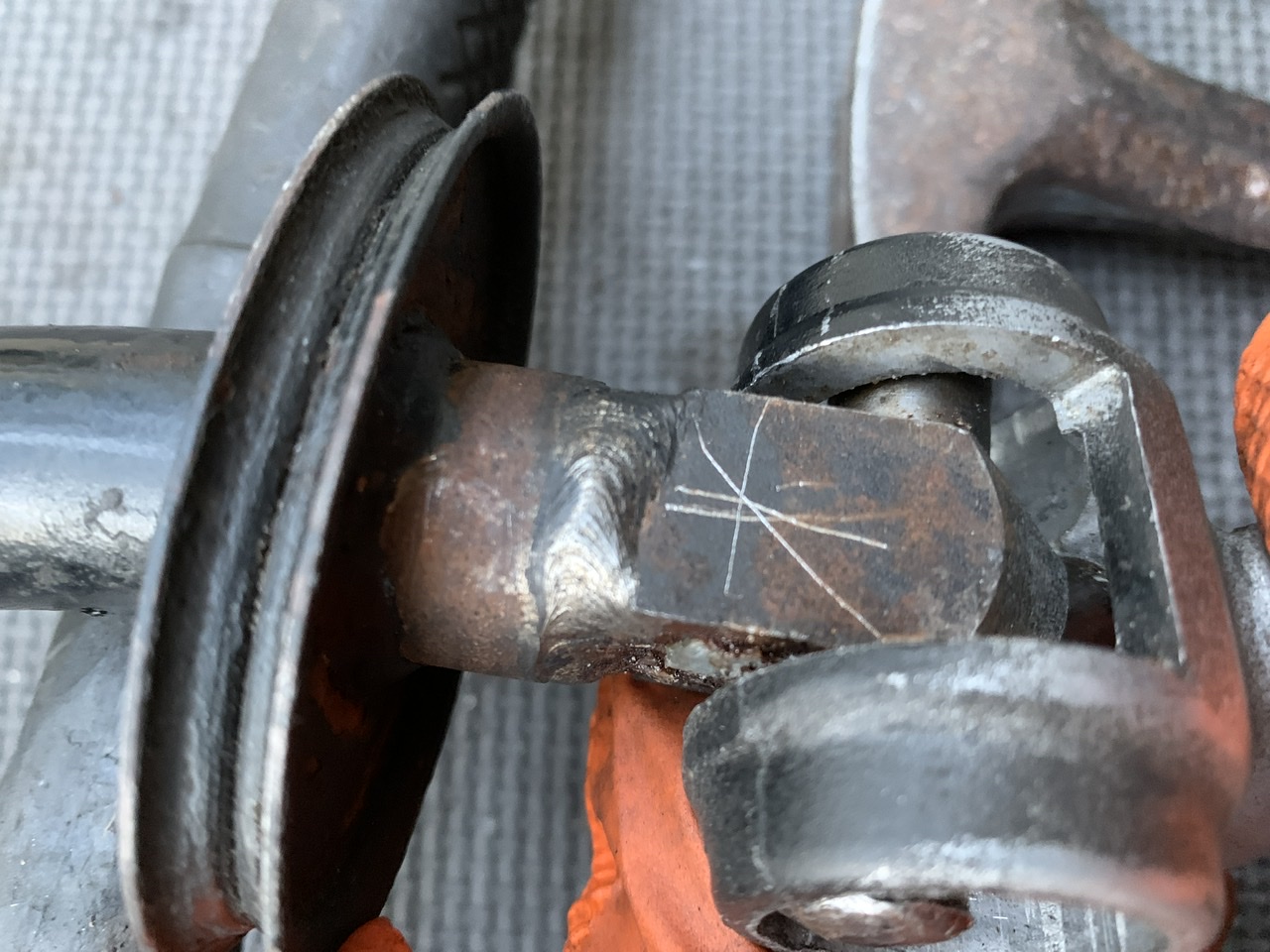

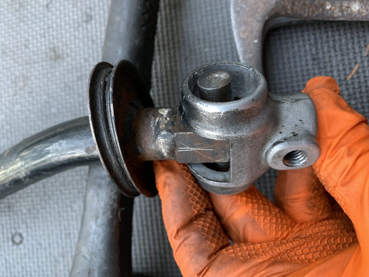

> Shift rod - Update- new brass bushings, and another option-a 911 coupler from Rauch & Spiegel, Is this a normal looking rod? And how the heck do I get the pin out?
DRPHIL914
post Jan 16 2020, 04:57 PM
Dr. Phil
Posts: 5,907
Joined: 9-December 09
From: Kennesaw, GA
Member No.: 11,106
A few issues here , after the bushing disintegrated I ordered new stuff, a new firewall bushing from RIX914PARTS and other goodies from 914rubber.com, and a new brass bushing for the coupling, however I can’t get the pin out, and I’m going to mess up the pin end and it’s not going to slide thru if I do that- so I’m going to have to find a press I guess somewhere?
1. Should it be that tight ?
2. Is this a normal weld end?

dr914@autoatlanta.com   lube the pin, support the coupler in a vice with w...   Jan 16 2020, 05:25 PM

Chris914n6   2. Normal The coupler is not that strong. It...   Jan 16 2020, 06:36 PM

IronHillRestorations   I've done a bunch of those. I use two sockets...   Jan 16 2020, 11:04 PM

rhodyguy   From the pictures the pin ends look pretty distort...   Jan 18 2020, 11:32 AM
IronHillRestorations   From the pictures the pin ends look pretty distor...   Jan 18 2020, 12:14 PM
DRPHIL914   From the pictures the pin ends look pretty disto...   Jan 18 2020, 03:21 PM

Mark Henry   Six inch vice, the two socket method....and that w...   Jan 18 2020, 07:29 PM

DRPHIL914   Ok tried getting the pin to move with clamp press ...   Jan 20 2020, 08:01 PM
mepstein   Ok tried getting the pin to move with clamp press...   Jan 20 2020, 08:06 PM
DRPHIL914   Posting an update! I had given up after taking...   Jan 30 2020, 11:52 AM
