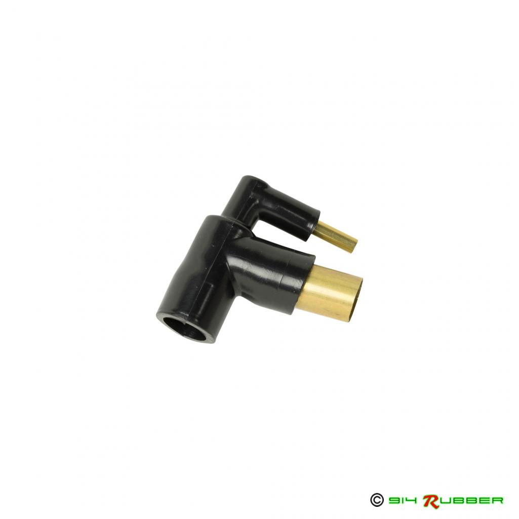

Mikey914 Is this what you are looking for?
https://900desi... Jan 20 2020, 04:28 PM

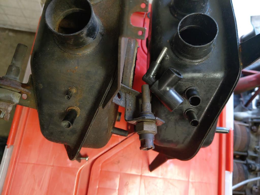

914Sixer Easy spot, the one on the left is a 75-76 because ... Jan 20 2020, 05:28 PM
JamesM
Easy spot, the one on the left is a 75-76 because... Jan 21 2020, 09:32 AM
914Sixer 70-74 uses a single pole switch. Jan 21 2020, 10:35 AM
JamesM
Correct. I h... Jan 23 2020, 10:25 AM

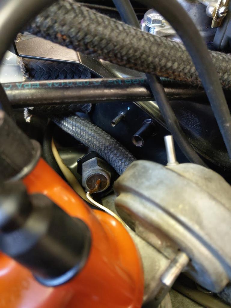

Mikey914 We have an unmolested LE Bumblebee, I will have to... Jan 21 2020, 12:20 PM![]() ![]() |
