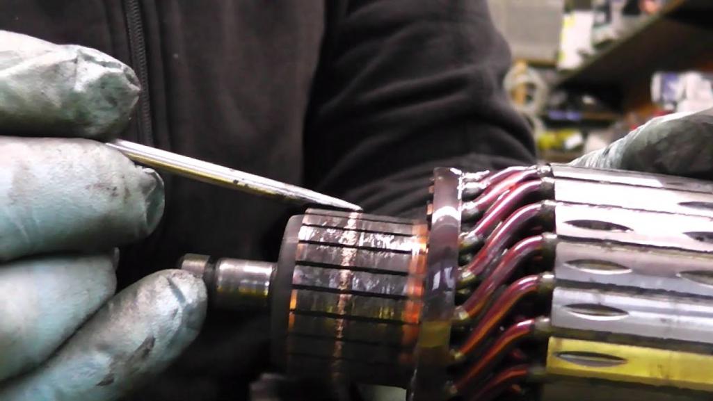

Ok, so I changed out the starter in my 6 with another starter I had collecting dust. Now upon turning the key there is a "delay" of a second or 2 before the car turns over. So when I turn the key I can hear the fuel pump come on, then the delay, then the car will crank. did i put the wrong starter in? Or do I need a high torque starter or??

Tdskip Odd - maybe a lot of resistance in the wires? Jan 25 2020, 08:03 AM

Tom The easiest way to determine if it is the starter ... Jan 25 2020, 12:58 PM
porschetub Sounds like its just dirty inside,they can be slug... Jan 25 2020, 01:14 PM

Spoke Sluggish turn-on could be a gummed up bendix. The ... Jan 25 2020, 04:10 PM
jrblackbox Thanks to all that responded to my issue. It was t... Feb 6 2020, 06:05 PM![]() ![]() |
