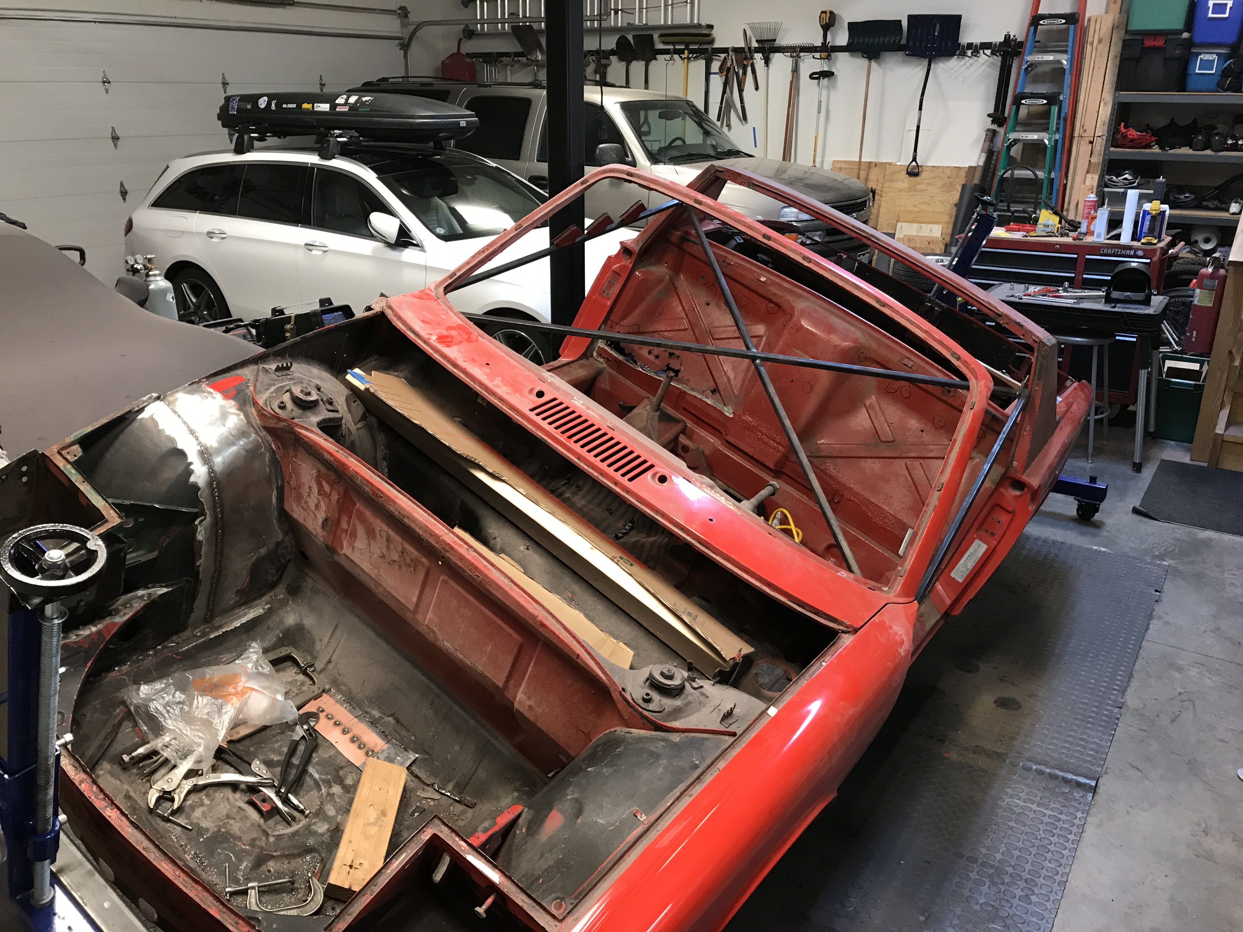

bkrantz
post Feb 1 2020, 10:40 PM
Posts: 8,827
Joined: 3-August 19
From: SW Colorado
Member No.: 23,343
Thanks, everyone. Glad there are some others the paranoid club.
Here's a view of my braces. I mounted the front connection to the hinge bolt holes, so I can't mount the doors. I do have reference measurement points marked and so far I see no change. My longs are very solid on both sides, as are the rear door columns so I feel slightly less paranoid.
The seem across the car between the remaining floor and the new panel will be a butt weld.
