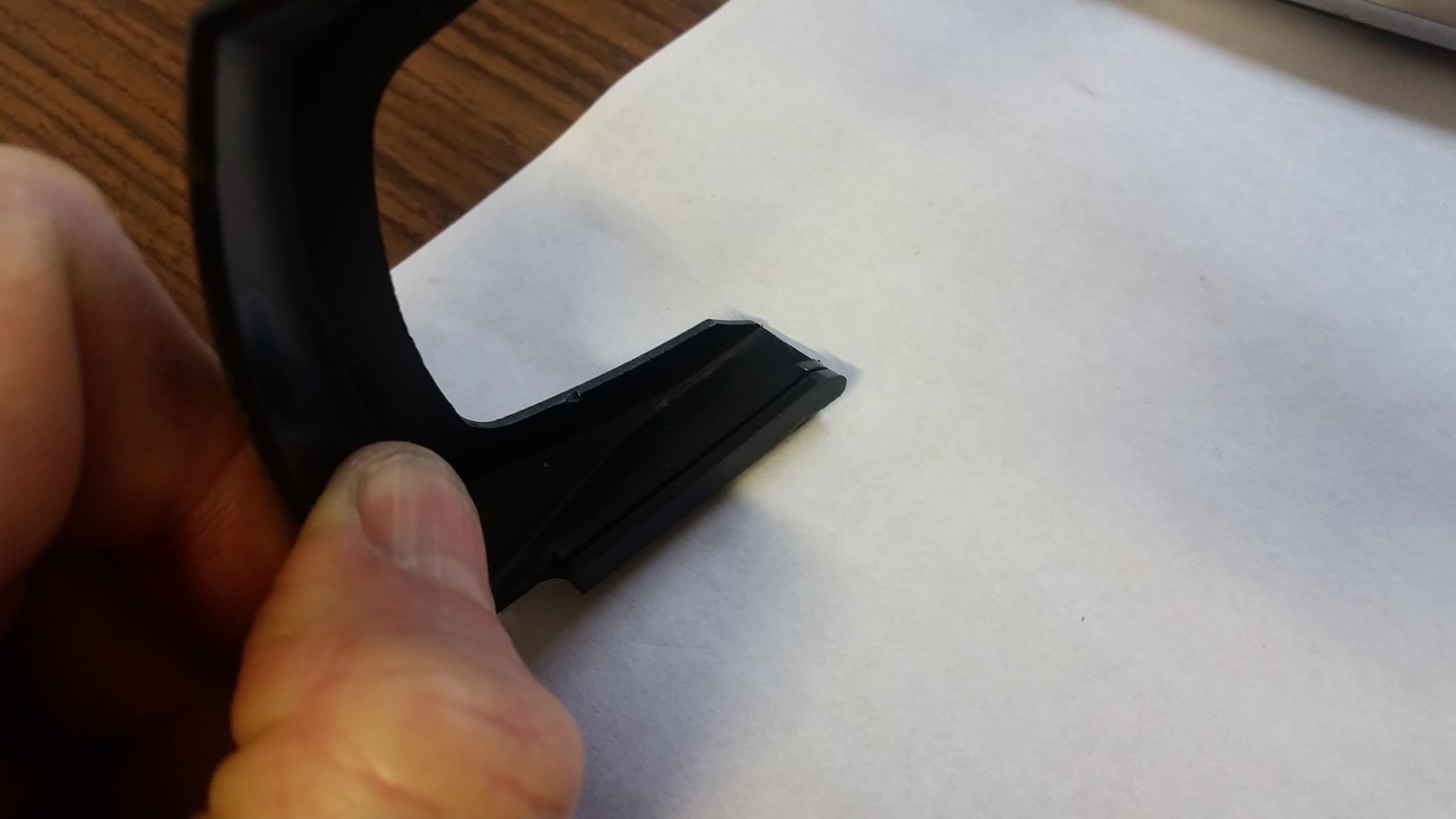

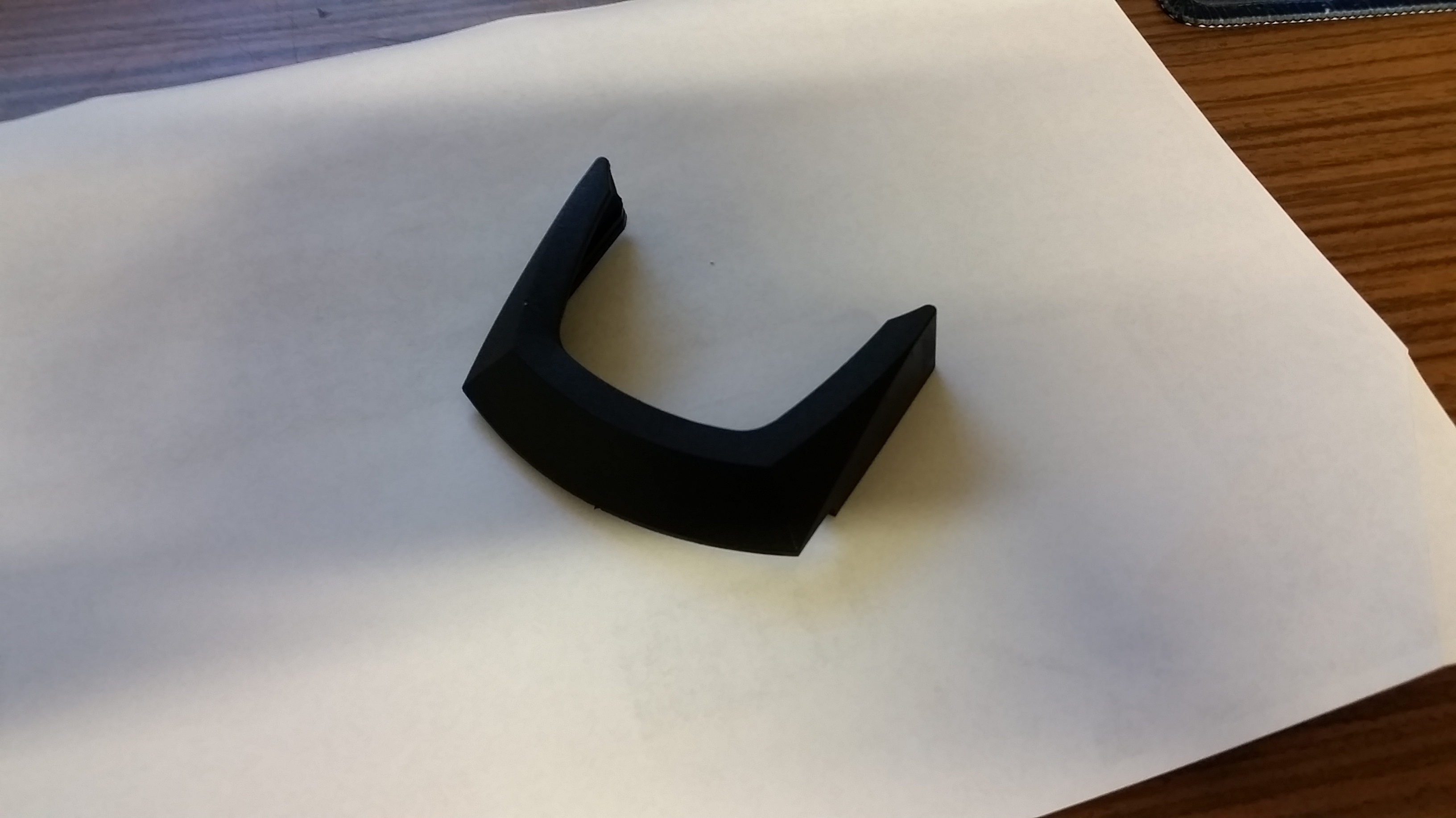

Hi,
has anyone Picture how these eye brows are mounted to the column or the dash face of a 6steering column?
Regards Michael

The trim pieces mount/slide onto another metal trim part that's under the basketweave material. If you look at the backside of your column trim you will see where it would slide into. I have some pics let me see if I can find them.

luke hit it on the money, and of course the 914-6 dash face metal is a different shape than both the 70-71 four cylinder, and the 72-74 four cylinder, so you MUST have the specific dash face for the "C" trim to work

Hi and Thanks for your Replys.
I am a Little confused abaout that Little grove on the inner side.
I expected it on the outside so it coult slip ober the sheet metal.
Michael

That's the groove I'm talking about. It slips into the metal portion of the 914-6 dash
tins. Check the link I posted and you can see where that groove goes on the tin.
That's the only thing holding it in place.

Hi Luke,
now i found the solution. Thanks for the link.
