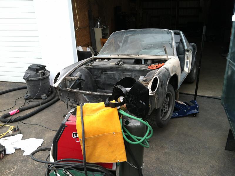

Getting started, one of the only early pictures of the car:

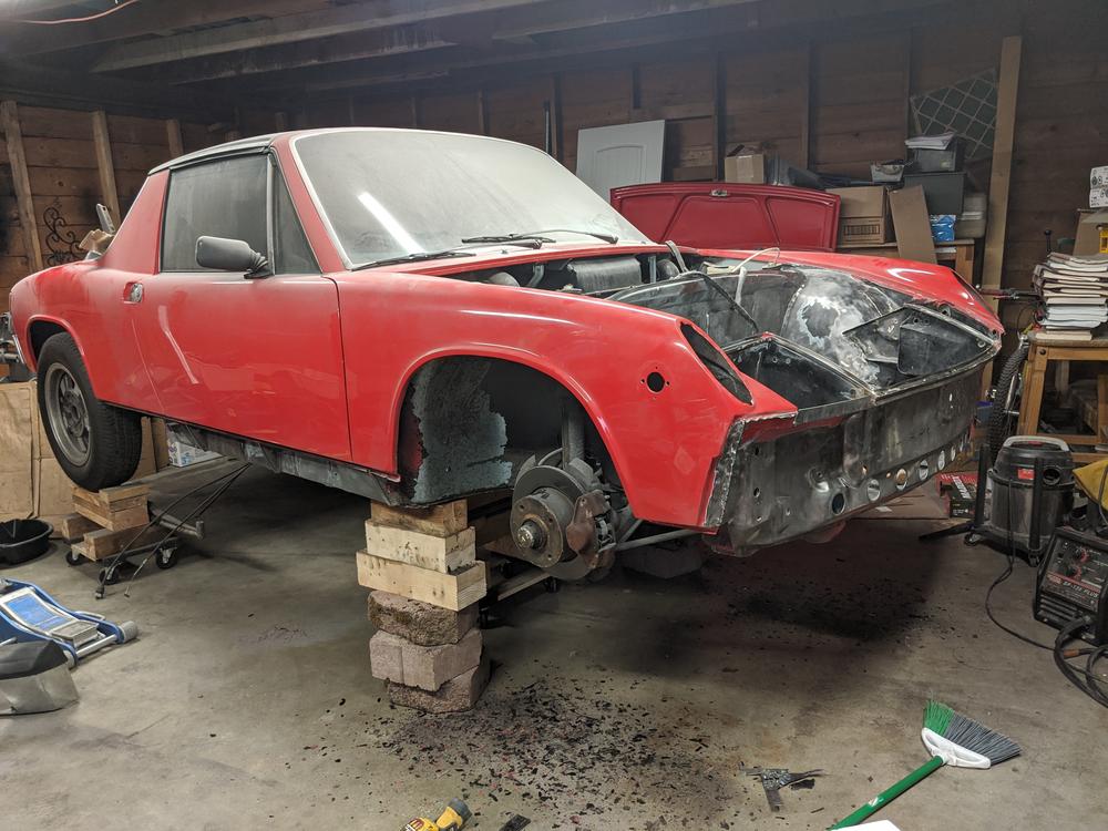

Second attempt (2020ish):
It had been almost 15 years since I bought the car. I had moved many times for school, military, more school, and then more military. The car mostly lived at my dad’s house during this time, but I now had a small garage I could park it in. I brought it home and got to work.
It quickly became obvious (thanks to browsing 914world!) that the rust problems were not minor, and would require significant work to repair before anything else. I decided to move front to back. The bottom of the car was coated with a thick bed-liner type coating that I removed from the bottom of the floor pans and much of the front trunk. You can see some of the original paint in the wheel well where the coating was removed with a putty knife.
As it sits today:

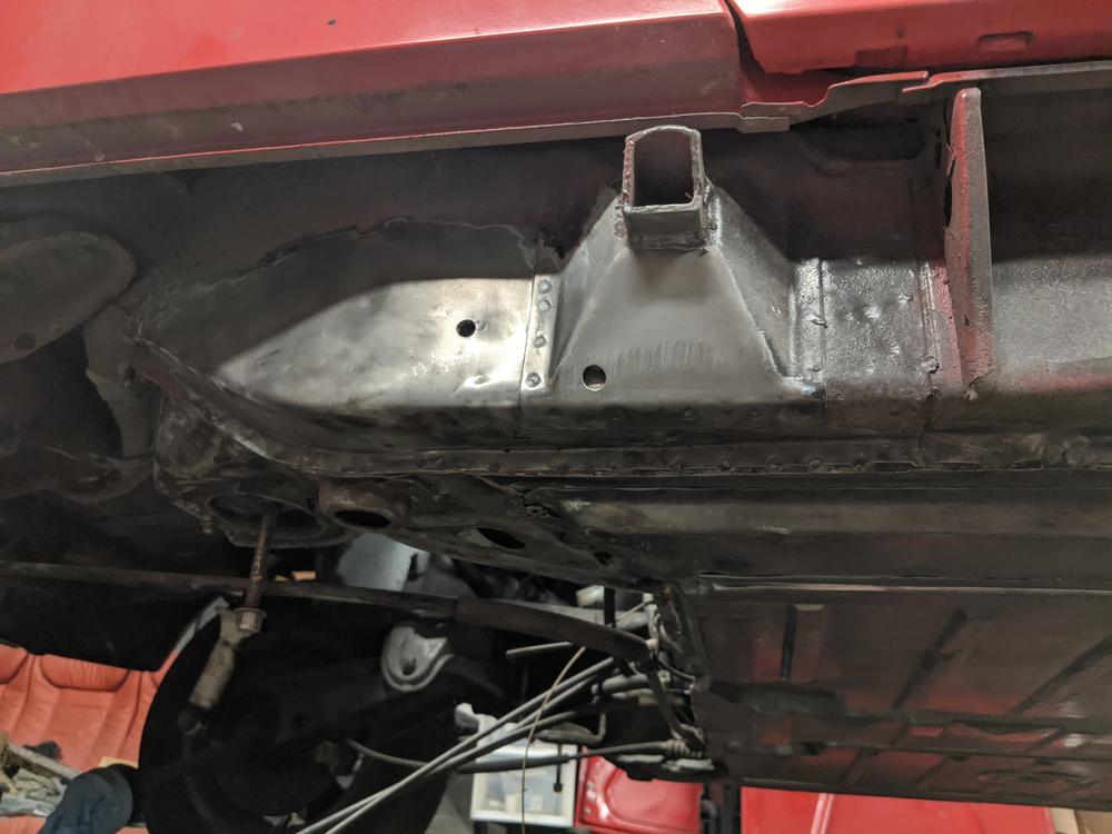

(IMG:http://www.914world.com/bbs2/uploads_offsite/i.imgur.com-23821-1581113672.2.jpg)
Passenger long, looks fairly solid from the outside. The hole is where I used a cheap endoscope to look at the inside (lots of rust).

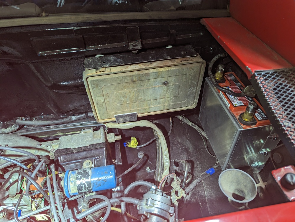

The 1.7L motor. Not sure why it's blue, definitely needs some help.

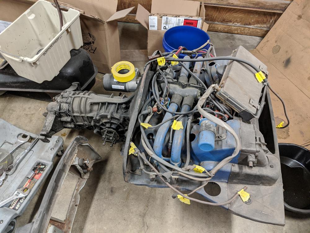

sreyemj   I purchased a large lot of parts with another car ...   Mar 30 2020, 10:33 PM

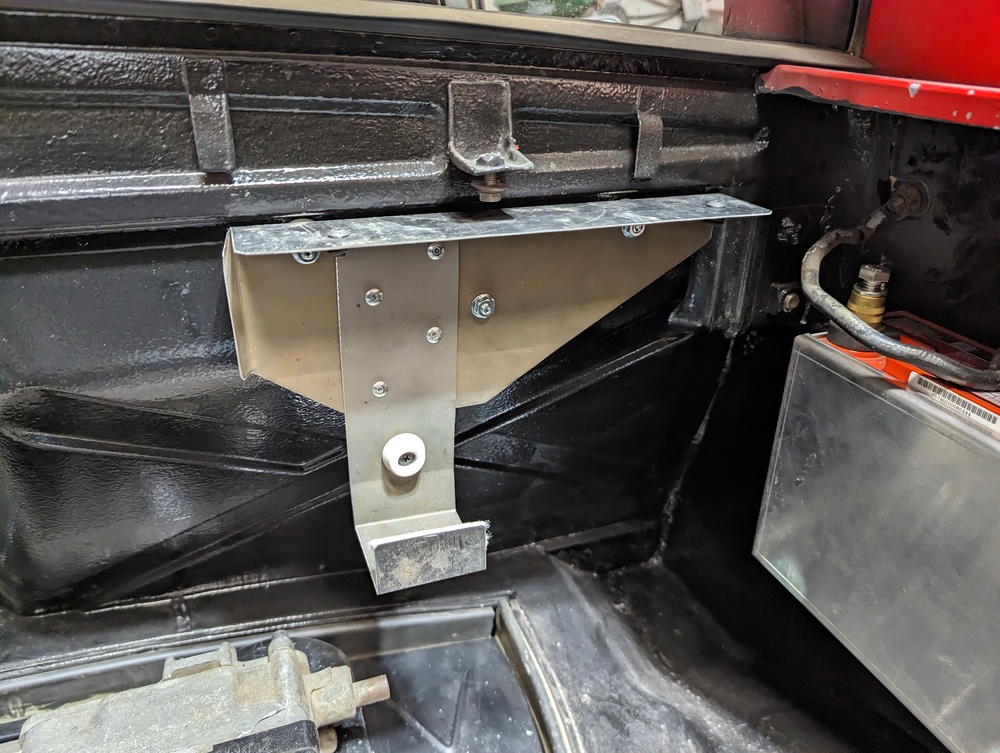

sreyemj   Tried making a front firewall mount to relocate th...   May 1 2020, 02:01 PM
