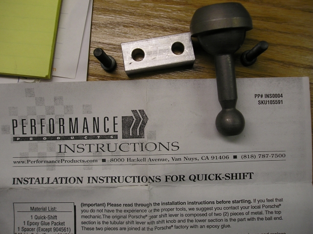

post Jul 5 2005, 07:40 AM
Incontin(g)ent Member
Posts: 5,785
Joined: 24-July 03
From: Westlake Village, CA
Member No.: 943
Here ya go. Not sure what I've got here.
rhodyguy
post Jul 5 2005, 08:01 AM
Posts: 22,252
Joined: 2-March 03
From: Orion's Bell. The BELL!
Member No.: 378
i believe the one howard has pictured is for a tailshifter. note the ball on the bottom that goes into the ballcup bushing on the front shift rod. for a sideshift trans, the front rod connector found on the stock shifter is used. i noted the effort to shift increased when i went to the wietmiester, which fyi, requires no cut-epoxy-etc. as stated, if the bushings are bad, a shortshift conversion is no cure. check the springs on the R/1 indent plate (you have to remove the shifter), usually they are loaded with grease, dust/dirt, and gunk. spray them down with carb cleaner or berryman's to clean them.
