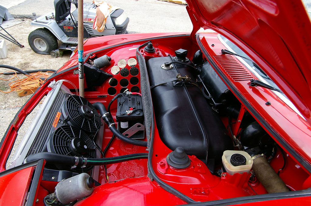

dbledsoe   Radiator and fans installed, although I still have...   Oct 4 2005, 09:36 AM
dbledsoe   another   Oct 4 2005, 09:37 AM
dbledsoe   another oops!   Oct 4 2005, 09:37 AM
dbledsoe   a real another Still some clean up work to do on ...   Oct 4 2005, 09:40 AM
dbledsoe   another   Oct 4 2005, 09:42 AM
jimkelly   I wonder what percentage of air is gonna be able t...   Oct 4 2005, 09:45 AM
dbledsoe   <...   Oct 4 2005, 09:49 AM
914GT   Nice clean radiator install Don. I was thinking of...   Oct 4 2005, 09:50 AM
dbledsoe   I have other images to upload but for some reason ...   Oct 4 2005, 09:54 AM
dbledsoe   lines beneath the car   Oct 4 2005, 09:56 AM
dbledsoe   Another beneath   Oct 4 2005, 09:56 AM
dbledsoe   Expansion/fill tank   Oct 4 2005, 09:58 AM
dbledsoe     Oct 4 2005, 10:02 AM
dbledsoe   I mounted the coil to the old heater blower mount ...   Oct 4 2005, 10:05 AM
dbledsoe   A tad short on carb to engine lid clearance thanks...   Oct 4 2005, 10:07 AM
dbledsoe   I can close the engine lid but I had to cut out th...   Oct 4 2005, 10:10 AM
