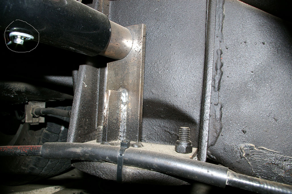

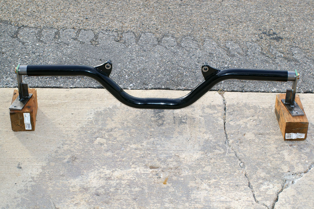

Phillip, below is a close up of one end of the mount I made and the photo below that is the same end of the mount as installed in the 914. I hope they give you a better idea of how I mounted my engine. The circled item in the upper left corner of the second photo below is the 1/4" quick release pin that keeps the mount from moving side to side when bolted in place in the car. Attached thumbnail(s)

Installed
| 914GT |
Oct 5 2005, 09:52 AM
#90
Senior Member ![]() ![]() ![]() Group: Members Posts: 1,101 Joined: 11-October 04 From: Tucson Member No.: 2,923 Region Association: Southwest Region |
It would be interesting to apply this motor mount bar concept to a V8 - to improve the ground clearance and eliminate the need to notch the shift rod. Maybe the next conversion project....

Guy, It's a pretty simple design but appears that it will work just fine. It defintely gives a lot more ground clearance and leaves plenty of room for shift rod clearance. Don |
