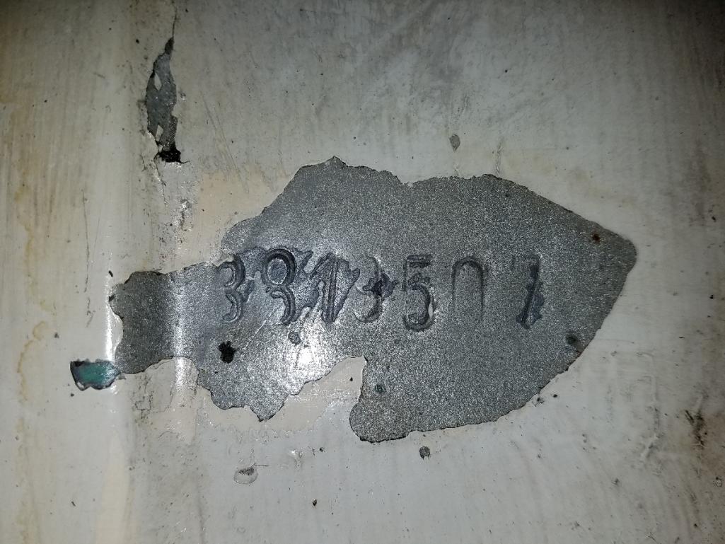

Can anyone tell me the size of the numbers stamped in rear trunk.
The numbers on mine are rusted away and I wnat to stma some new ones.

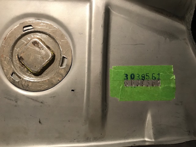

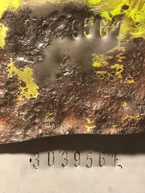

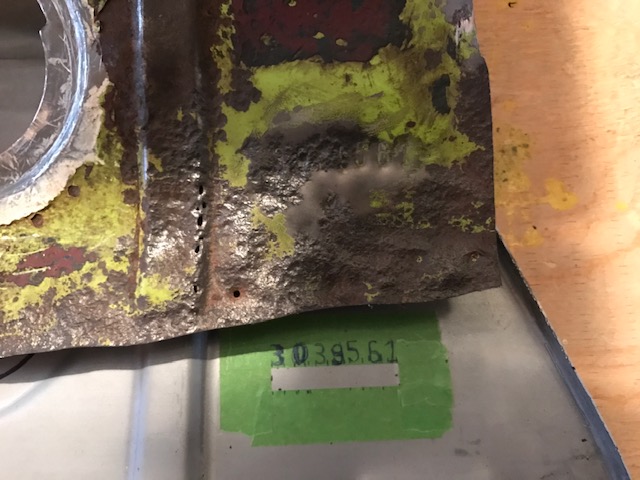

I found that 3/8" (9.5mm) are very close (see pics below). I cut the old floor piece and overlayed it on the new one and then measured to get the stampings in the same location as they were originally.

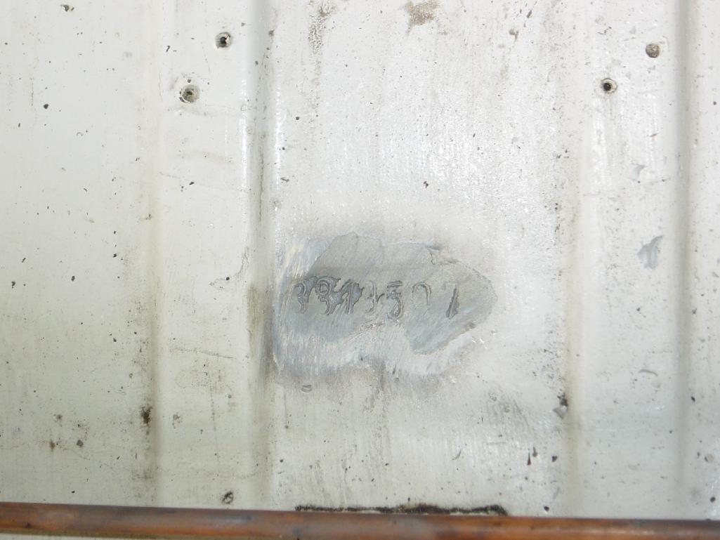

70 six karmann numbers were in the middle of the rear trunk floor, but 71 and 72 sixes were in the right rearAttached Image
