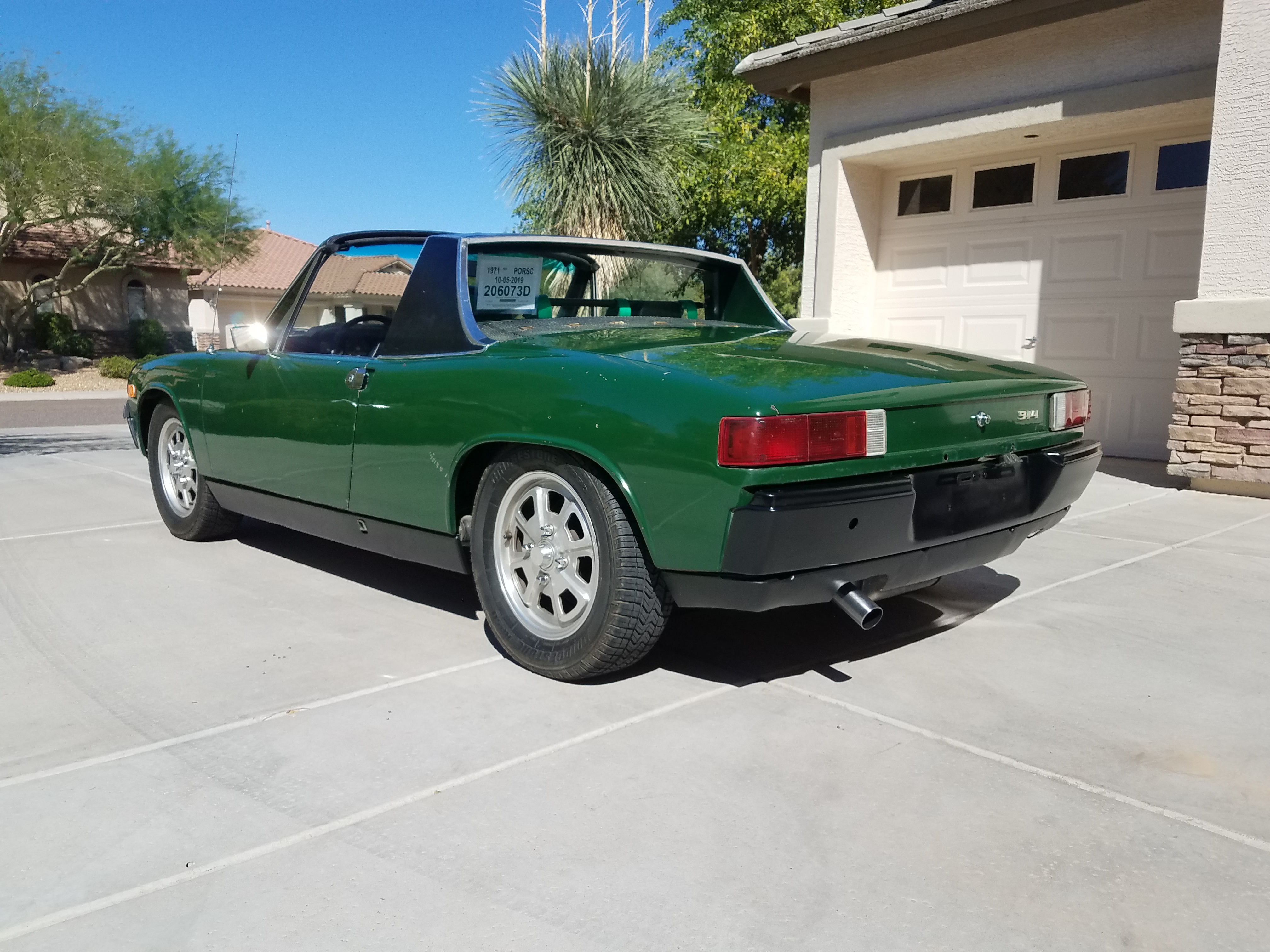

This is what it would look like with a black bumper.
