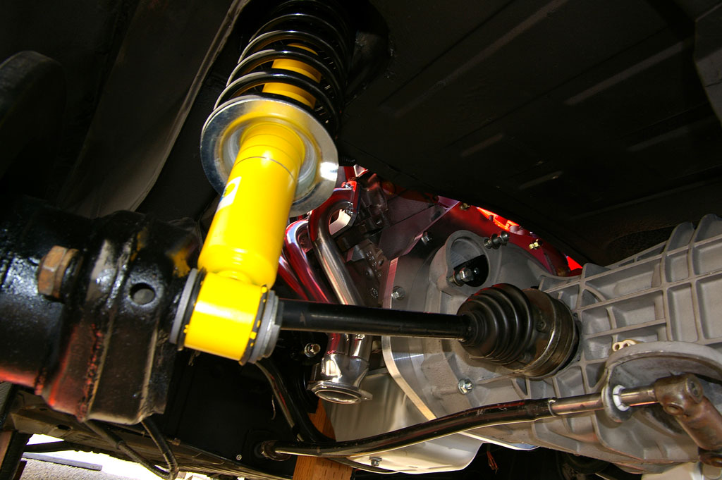

Here's a pic of two IMI starters purchased from the same place. They are clocked different but both worked in my v8 conversion.
I'd try to reclock.

This is about the worse configuration you can have but still gives about 1/4" clearance with the v8. The transaxle is dropped 3/4" and moved back 1-1/2" for the 8. Maybe the 3/4" drop is helping here........but then again, I'm not familar with what is done as far as moving the transaxle in a v6.
John

Mine looks the same as yours John. About 1/4" clearance.
