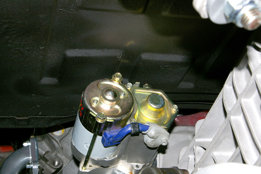

I repositioned the starter. There seems to be a choice of stock configuration (as shown in my photo) and a 90 degrees left configuration of that. Rotating the starter 90 degrees left on the starter mounting flange cured my problem. In that configuration there is tons of room when the starter is bolted up. Only concern is tight quarters to get a wrench on the lower starter bolt (a socket would not work). That's no big deal other than I prefer to torque stuff to proper specs but don't have the tools to do so when an open end wrench is the only thing that works.
But hey, it's in there with no dimpling of the trunk underpan. (IMG:http://www.914world.com/bbs2/html/emoticons/beer3.gif)
A photo tomorrow evening.
Best,
Don

Bill,
I hope you'll keep us posted on the JLO conversion as it goes.
Here's a picture of my starter in place after changing the orientation.
Don

That 3/4" drop would have been sufficient for the starter in the upright configuration to clear. But my V6, and all the V6 Buick conversions I'm aware of, mount the tranny in its original location i.e., no setback and no down set. Changing the starter orientation cured my problem.
