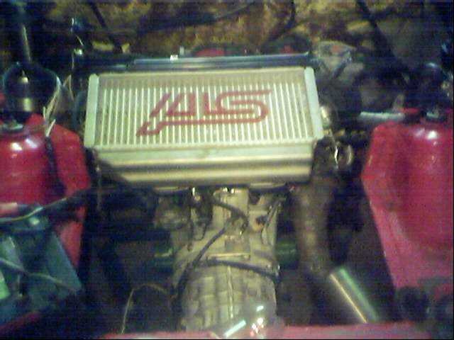

more subaru (IMG:http://www.914world.com/bbs2/html/emoticons/smilie_pokal.gif) the engine ej20t will fit with NO body mods whatsoever, engine and gearbox will also go, disengaging the rear drive clutchpack which are electronically controlled and placing a welch plug into the the rear output stops the oil problem ,
i hope that somone in the us builds a kit for these soon so the mounting is made simple for the average joe.
we have done two diffrent wiring styles one was a graft of an aftermarket ecu to the suby engine loom this was on a 94 model the other has been a complete ecu flying loom which comes with its own sensors on an 05 sti corsa bitumen motor and six speed cost of computer is approx aus$1600 and comes with hand controller also maybe this is an option that tony could look at.
my biggest consern is the drive shafts any ideas ,we have a hybrid 914suby setup but strength ???????
