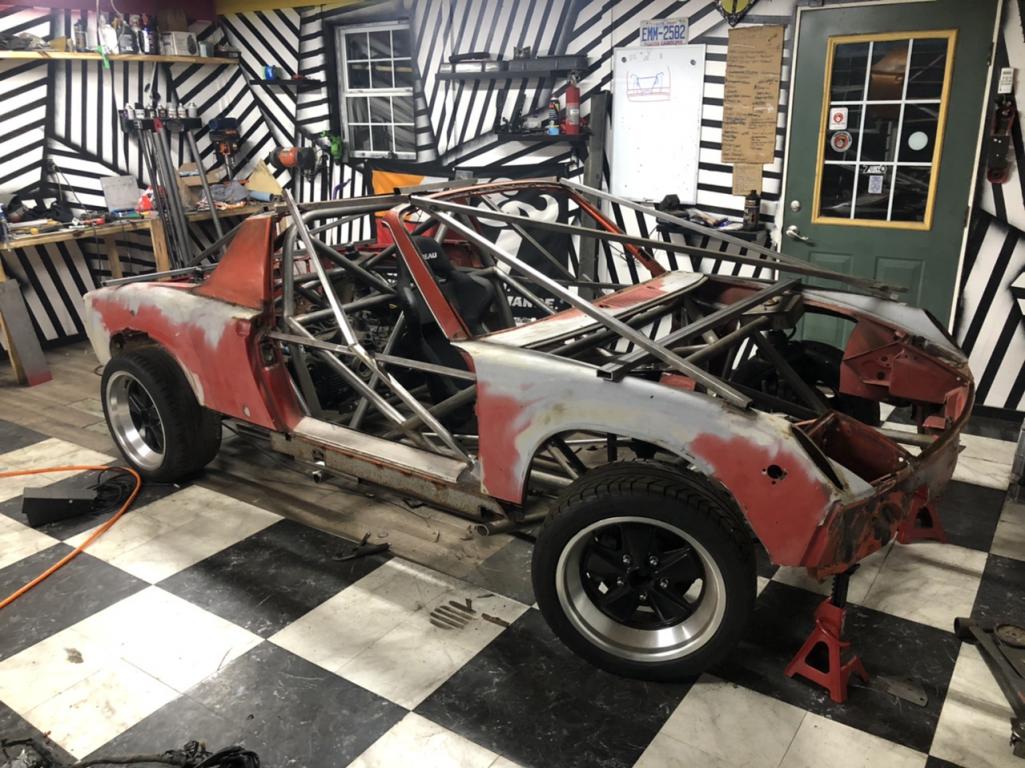

Body is about to go on! I think im going to try setting it on tomorrow. It drops directly down on to the chassis, and by our backstrain-o-meter we figure i got the body down to about 120 lbs. Its really no problem for two guys but we will see how that goes. Im glad i got this car instead of anyone else because i would NOT want to restore this. It had rust everywhere from hell hole, to driver speaker pod of all places. I was the perfect guy for this car because i kept none of that gross orangy brown stuff.

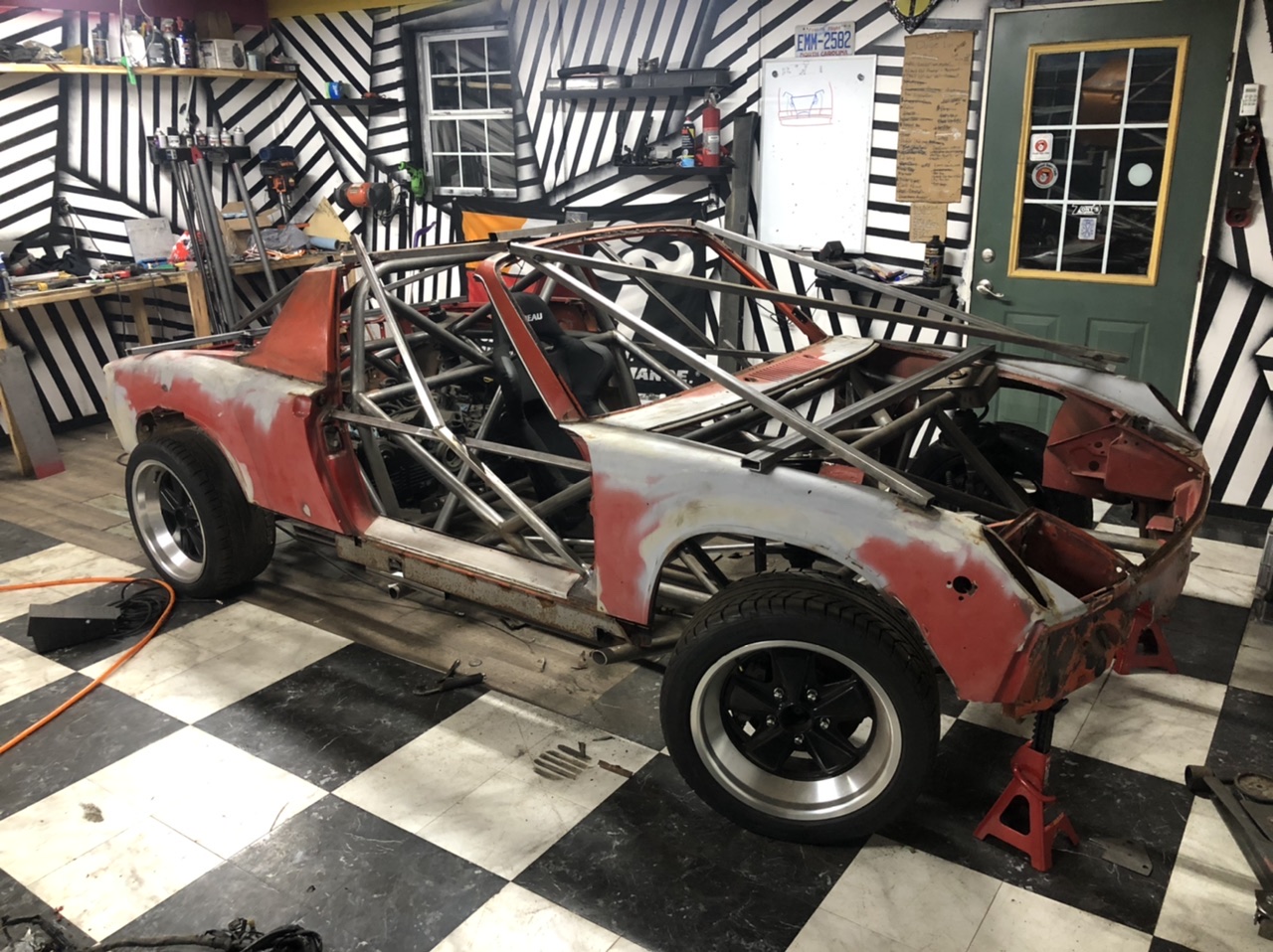

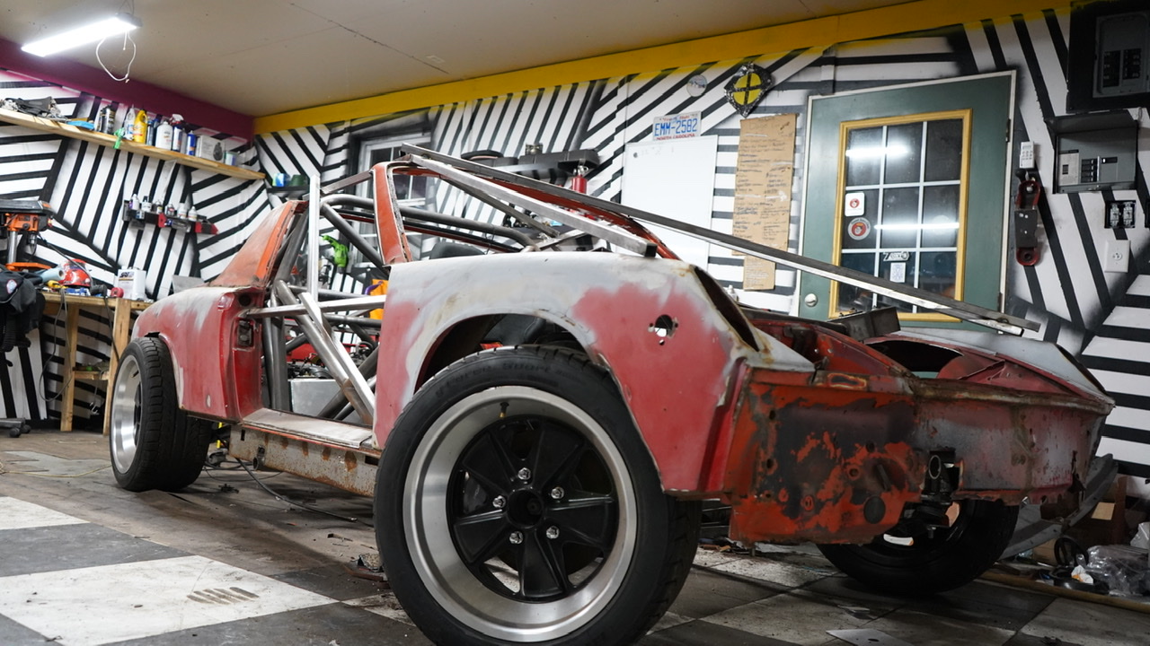

The Body Is On! ....kinda. i finally got a couple people together to set the body on top. it is neither mounted nor sitting in the right spot. it needs to go forward 2.5” it should fit up very good! obviously there are a couple “visual issues” the strut tops certainly poke through but i think it will just add to the crazy look!

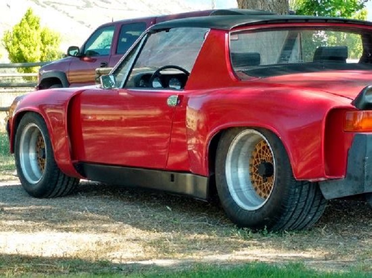

And a bonus, to whoever wanted to know what a 914 gasser looks like, here you go:Attached Image

Great work. More pic's. (IMG:style_emoticons/default/beerchug.gif)

Keep on trimming!! You've got a good 50lbs of excess 914 there you can cut out (IMG:style_emoticons/default/smile.gif)

This is an awesome creation, I love it. (IMG:style_emoticons/default/first.gif)
You are a fabrication genius!
You have made a lot of progress in a short time.

Forget Gasser - too easy. You need to go full Funny Car and make it so the whole body tilts up.
(Follow me for more great design and fabrication ideas! (IMG:style_emoticons/default/laugh.gif) )
Seriously, you're making great progress. I hope I get to meet you and see your mad creation some day.

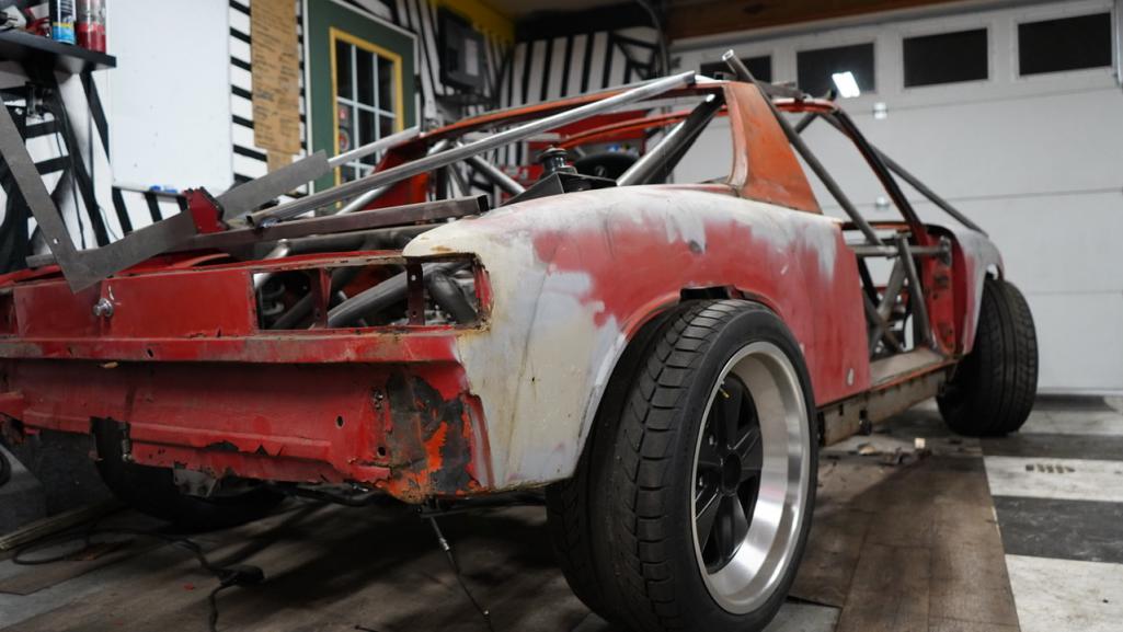

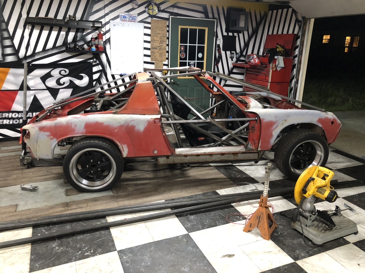

Just got some nice pictures, i have a video coming out on it today!Attached Image

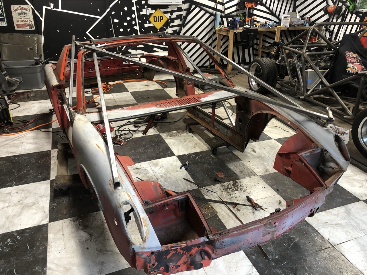

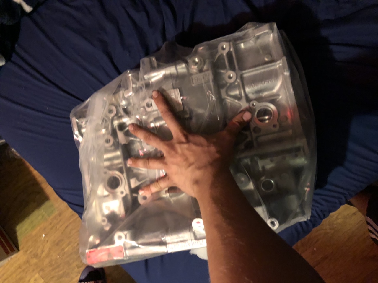

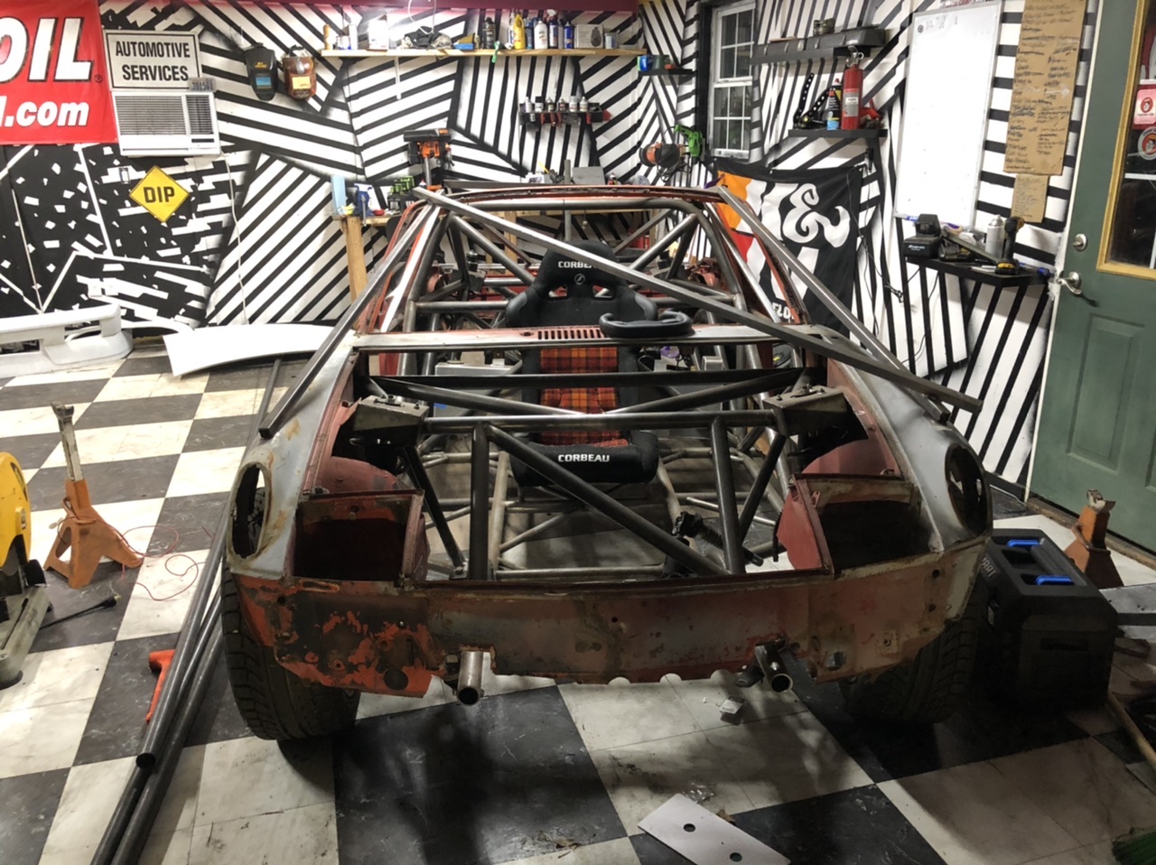

Long time no see! racing season is in full swing and i havent been home for more than a couple days at a time. But things have happened; First i bought my engine! (IMG:style_emoticons/default/cheer.gif) (IMG:style_emoticons/default/piratenanner.gif) Its an ej25 from iag. Its their stage 2 tuff block. Its a brand new block, sti crank rods, pistons rod bolts. Its been honed and balanced, along with all the good stuff! All in its good for 675hp but it wont see that much... yet. Its a pretty piece and ive already got some goodies for it hiding around here.
Always impressed how much power you can get out of something so small:

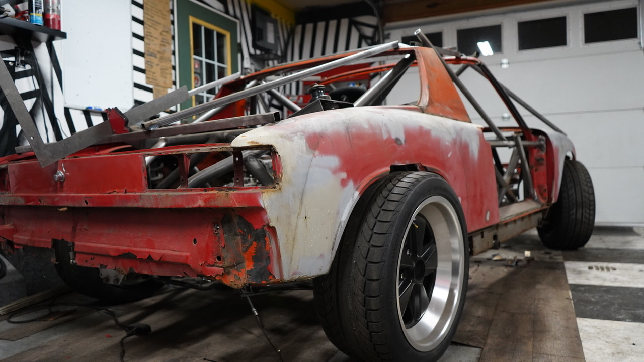

Today i leveled and aligned the body so i can work on mounting it finally. of course it took way longer than it should but it is done. Tomorrow is a big day!

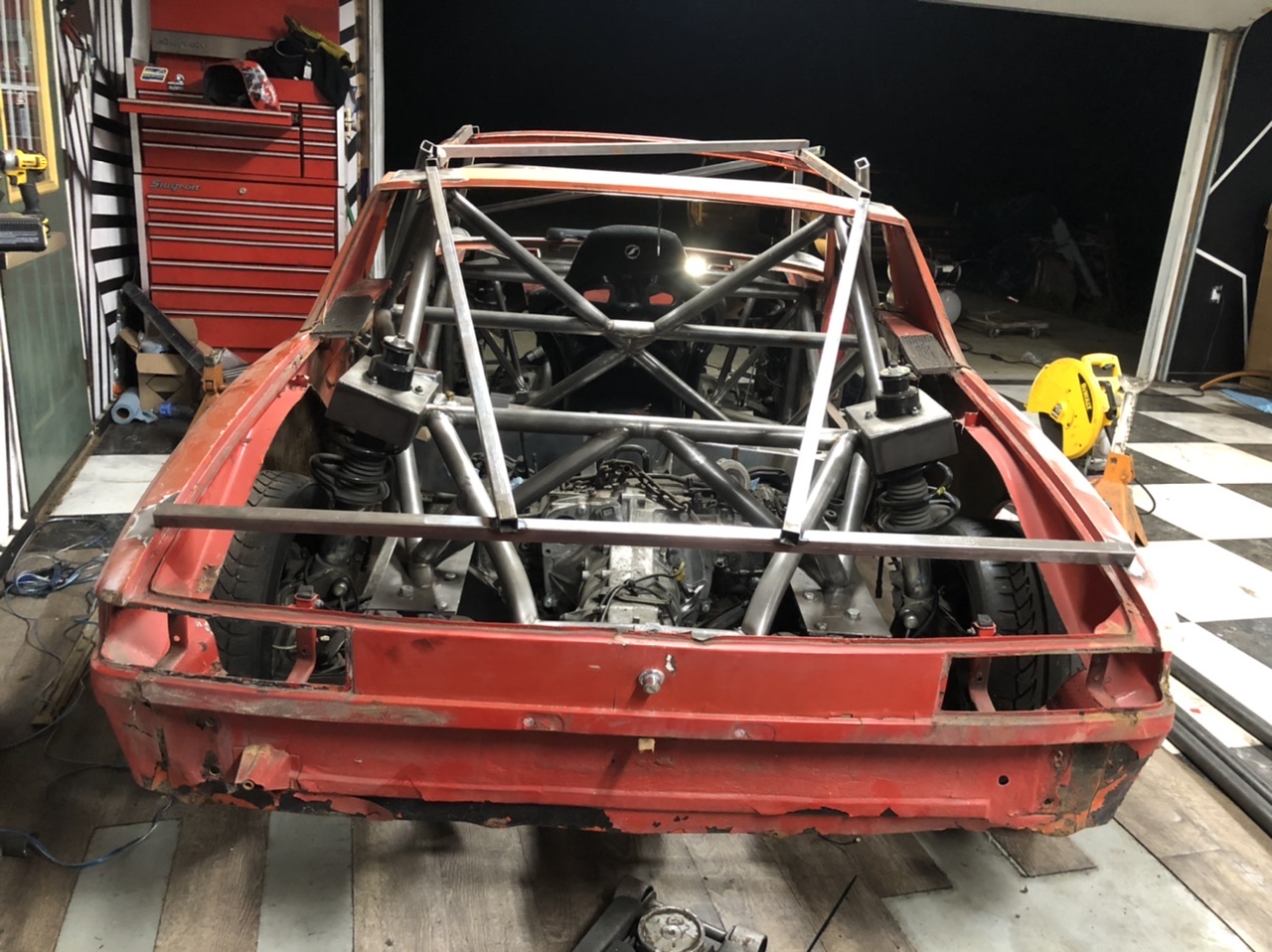

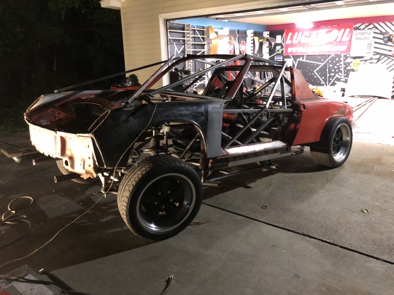

Started working on mounting the body, made a rear bumper bar. I took a piece of 1-1/4” tube and slip rolled it to about an inch of deflection so it sat fairly nice under the tail lights. Added tabs and presto! A little job but it came out good. Tomorrow should see loads of work.
Ps you can see how rusty this thing is oh well it doesn’t trouble me
