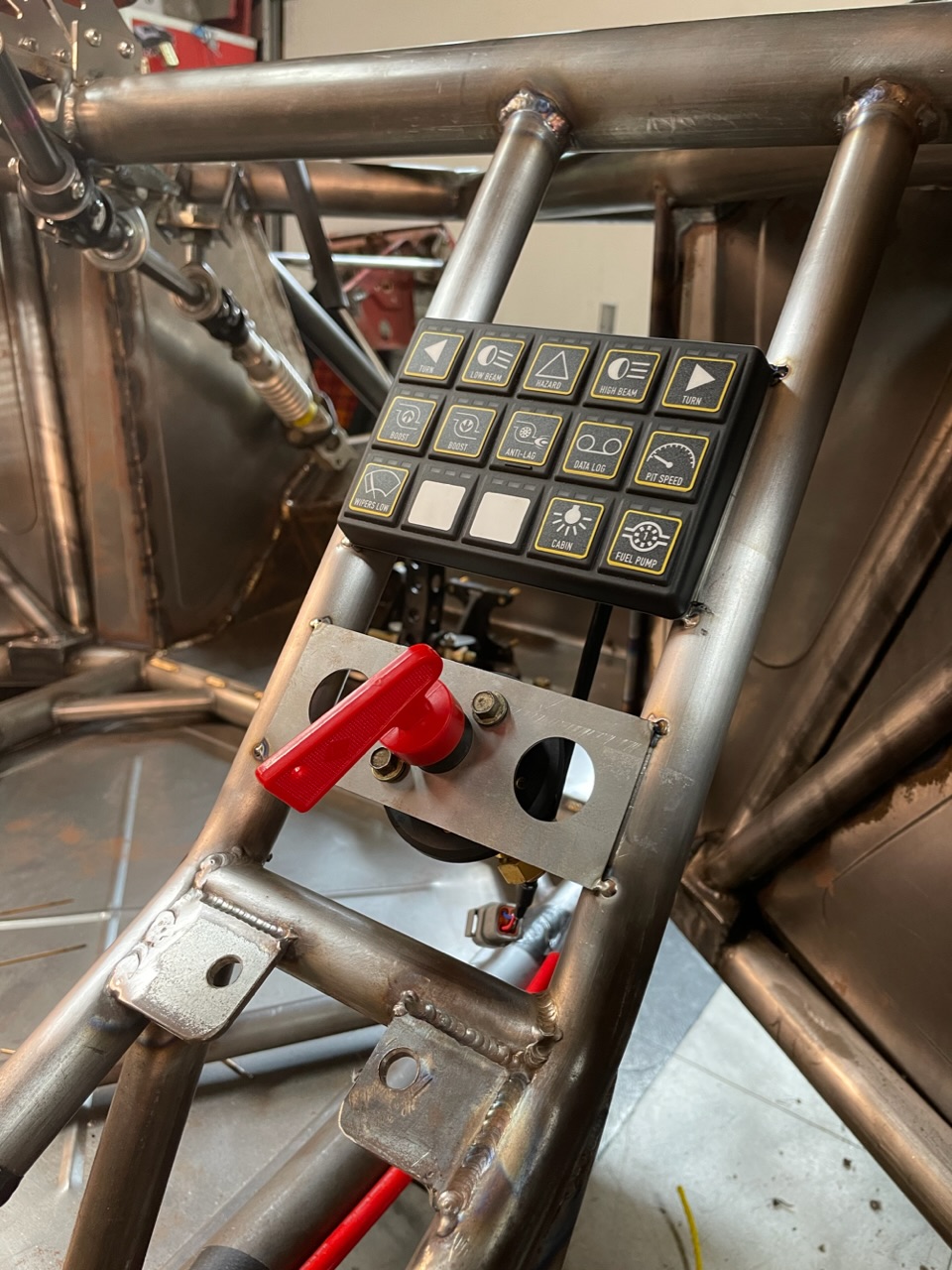

tazz9924
post Aug 11 2023, 03:35 PM
Post #344
Posts: 755
Joined: 31-May 15
From: Mooresville NC
Member No.: 18,779
I added controls to the center stack, including kill switch and a haltech CAN keypad. The key pad is absolutely sweet! With 4 wires i could control anything on the car. Ive chosen 13-15 inputs so far but i see it as a chance to expand a bit.

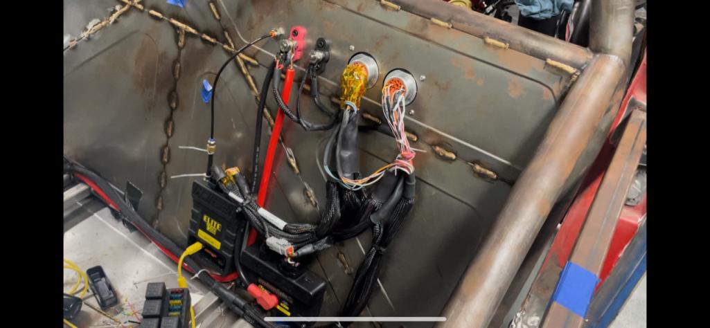

tazz9924
post Aug 14 2023, 02:42 PM
Post #350
Posts: 755
Joined: 31-May 15
Member No.: 18,779
Got a lot of the interior harnesses pinned and protected. There are a ton of wires between the pdm and ecu and going all directions its hard to keep it clean looking but as far as start up goes this is good for now. I may further reduce and what not from here but at the very least it will get a couple 90 degree heat shrink boots. The wire covering here is expandable braid, and i can definitely say you can see a difference between cheap and quality braid. The quality stuff stays together and doesn’t fray as easily. Burning the ends on either gives good results though!

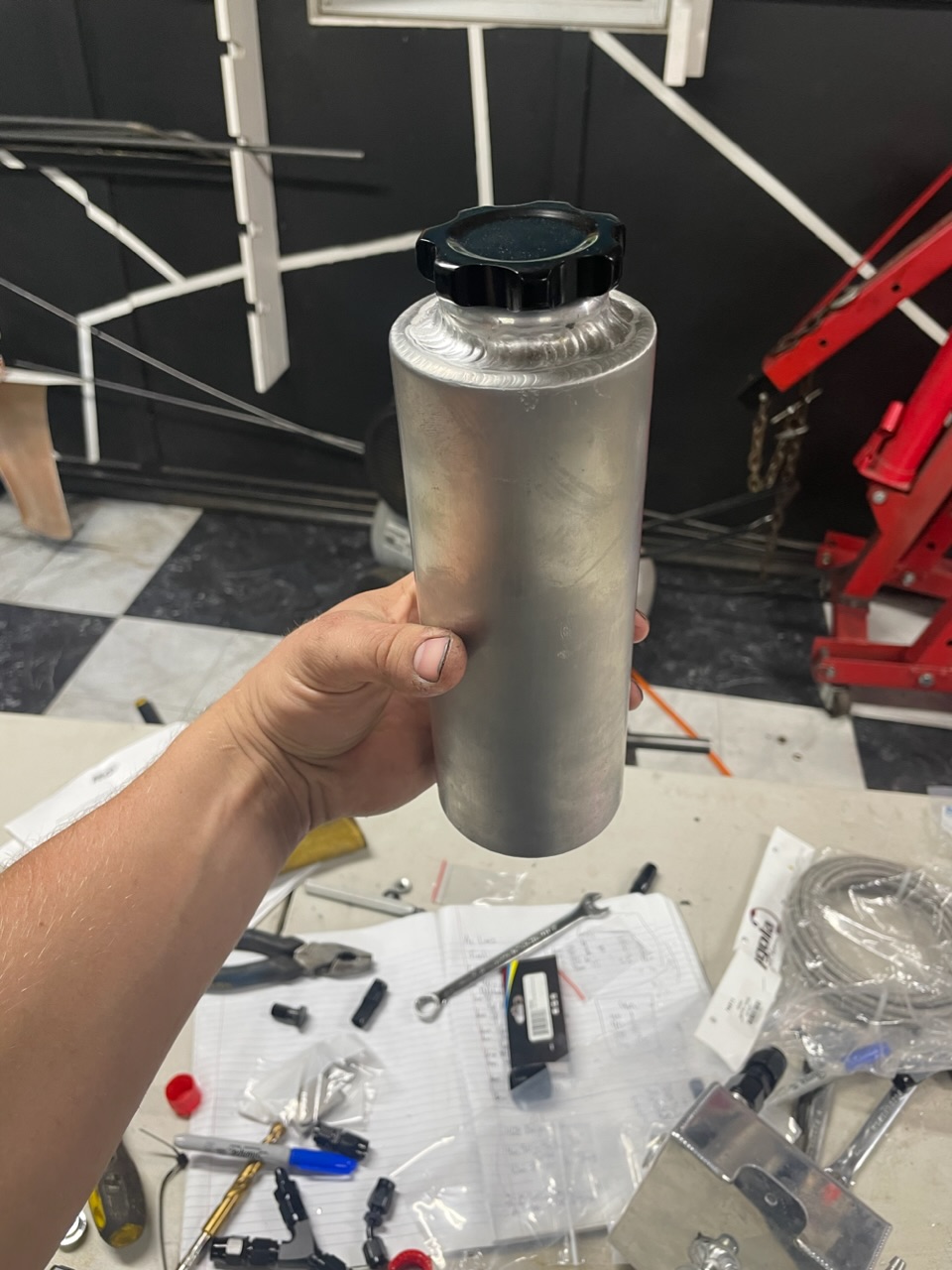

tazz9924
post Aug 17 2023, 12:37 PM
Post #351
Posts: 755
Joined: 31-May 15
Member No.: 18,779
Small bit but i like the result; i took an old catch can that had only pipe threads cut into each end. So i cut a major hole in the top and welded in a screw on cap. It went from beat up old catch can and gave it a new lease on life. It will be the fill point for ghe radiator up front.
76-914
post Aug 17 2023, 04:17 PM
Post #352
Posts: 13,996
Joined: 23-January 09
From: Temecula, CA
Member No.: 9,964
That looks great. Nice job and great welds. Now stop posting pics of your Al welds before I convince myself that I need a TIG set up. (IMG:style_emoticons/default/sad.gif)
