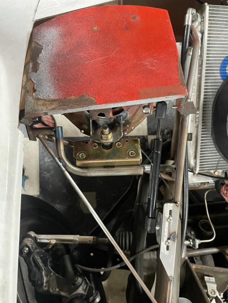

Progress has been… bumpy lately. Since my good friend past away, and racing two cars at the same time at Sebring my motivation to do anything tanked. With that being said i have done many good things to the car, starting with headlights.
I used a very short gas strut to lift the light itself and i used a door latch catch to keep the lights down. I used laser cut parts to slot everything and leave everything totally adjustable. It will eventually be activated by a pull cable but that gets to wait till after powder coat. Its just one of those things that make me smile
The door latch was a clever idea. Sorry about your buddy passing. Did you make a new video update yet? (IMG:style_emoticons/default/beerchug.gif)

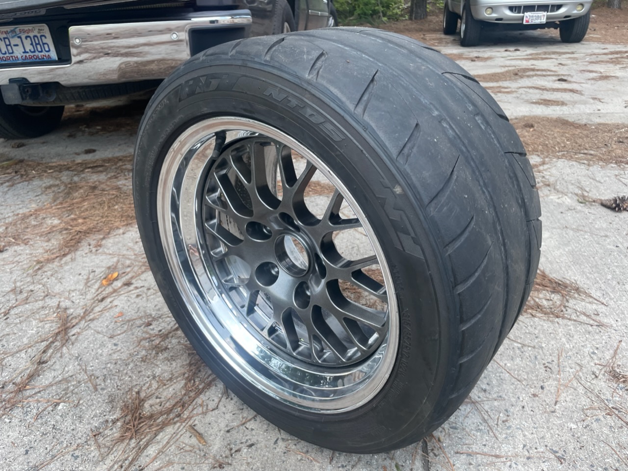

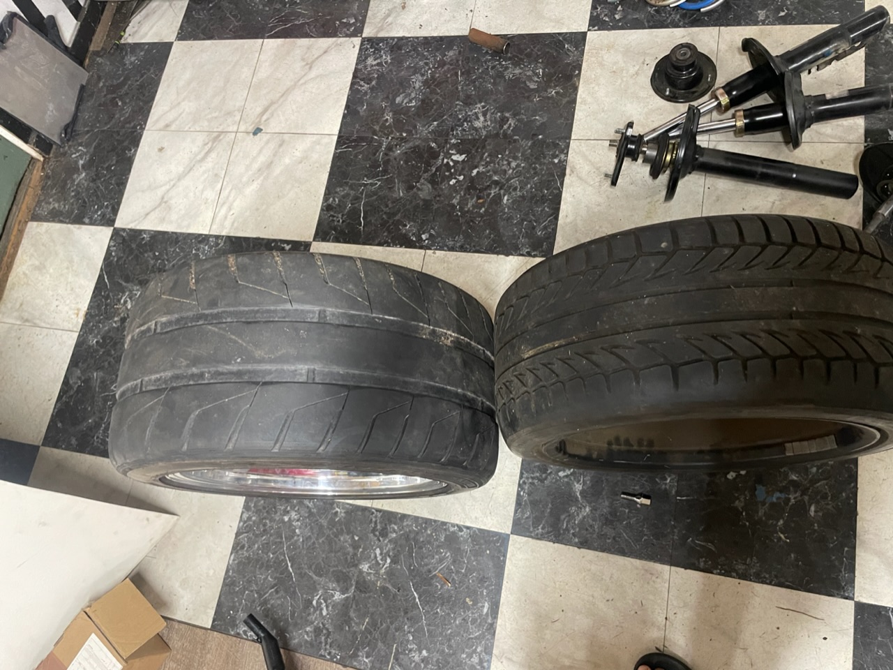

I also got some used tires to mount up on my fikse rims. Amazingly i bought a set in the exact sizes i wanted so its a perfect mock up. 275 fronts 315 rears. Meat. Neat. Attached Image
Comparing old rear 245s to 315, this is a comically big tire.

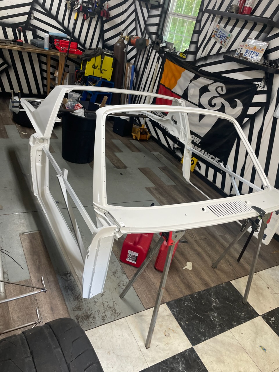

Got the body sandblasted and epoxy primed. It seems odd because now i have to repair the rust, but in North Carolina the humidity is so high it will flash rust. So now i get to hate life haha
