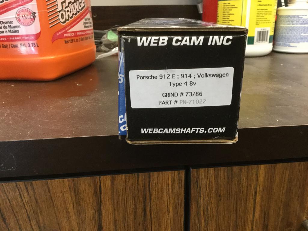

1) If in my shoes would anyone not change the cam? My consensus from searching this forum is that the 73 is the grind to go with for injection and 86 is for carbs. But the conversations are usually had while someone is doing a rebuild anyway and looking for the optimal cam.
2) Is there a minimally invasive way to get to the cam, or should I just follow engine rebuild instructions and pull everything apart? Haven't found anything in my searches on this or other forums to suggest there is any option here.
3) Should I really just have a shop do this? The warranty on the rebuild has long expired. But the possibility for mistakes that could take down the otherwise good rebuild abound (or so I fear). Are there any steps in this process that require experience or special tools that someone who is book taught on this process is likely to mess up?

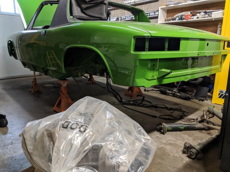

Here's a picture, because walls of text are boring:
(IMG:http://www.914world.com/bbs2/uploads_offsite/www.thesamba.com-14259-1587828462.1.jpg)
Thanks!

The labor would be more of a bite, but if you are doing it yourself Id consider selling the Web 86 (shouldnt be too hard) and consider the Dual pattern custom grind cam that Aircooled.net offers. (IMG:style_emoticons/default/smile.gif)

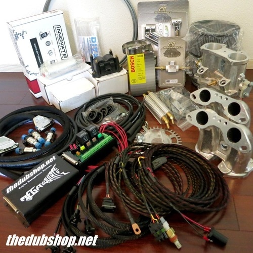

The dubshop kit is a full system with induction which you wont need if you already have the d-jet manifold, throttle body, etc. ECU, wiring harness, crank sensor, possibly injectors are all you really need to convert d-jet to MS.
You never mentioned what d-jet setup you have, or what was done to convert your 1.7 to a 2.0 though. We know the current cam will be an issue with D-jet but there are other potential hiccups as well depending on the details. If you dont have a stock motor, and the correct matching d-jet system for that stock motor I probably wouldn't mess with d-jet. Im sure you can make it run, you might even make it run "ok".... I wouldn't expect more than that though.
