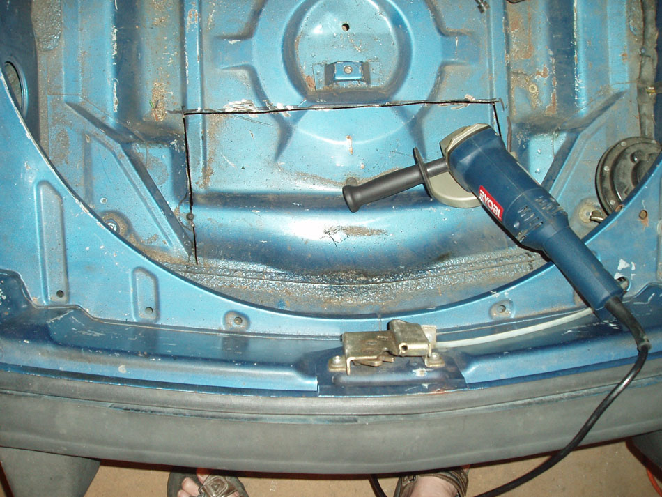

Sharpie and an angle grinder with a cutting disk.
Quick and easy.
If it's good enought for the boys at "OCC" then it's good enough for me. (IMG:http://www.914world.com/bbs2/html/emoticons/biggrin.gif)
I strongly suggest actually following your lines unlike I did. (IMG:http://www.914world.com/bbs2/html/emoticons/laugh.gif)
