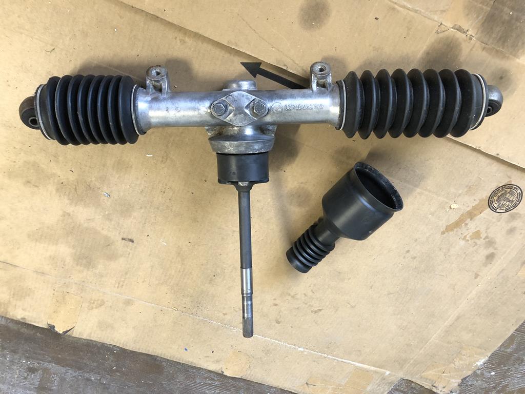

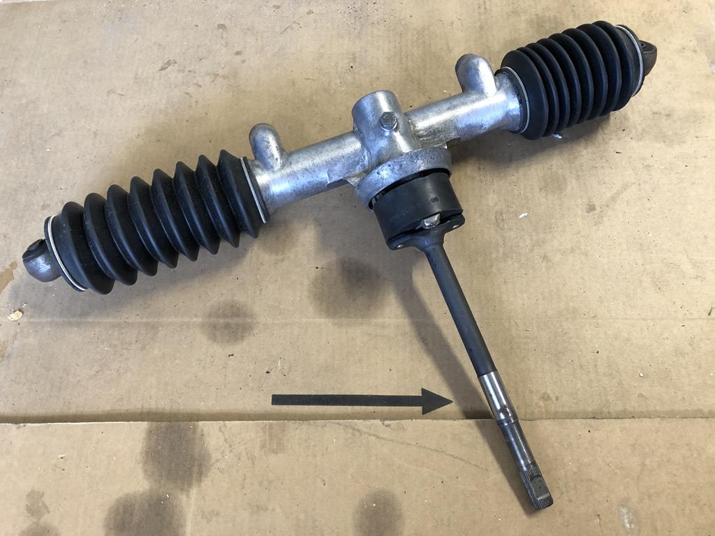

Are the following two steering racks interchangeable -
914.347.014.00
914.347.014.01
I have a nicely rebuilt .00 rack (see pics) that I would like to install in my '74 2.0L.
Research says the .00 is a rack from 70-72. Can I use it in my '74? Thanks.
