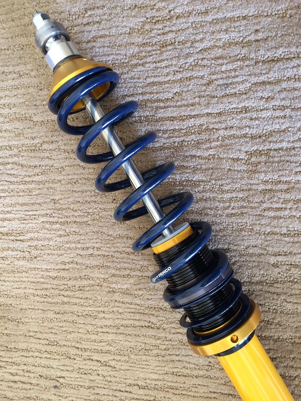

@roblav1 - You can solve for the "loose spring at full droop" via adjustable coil overs with helper springs. I got this set up from Elephant Racing. Works like a charm.
The helper springs (the flat coil spring at the bottom) fully compress as soon as the car is set on the ground but keep the spring seated at full droop.
