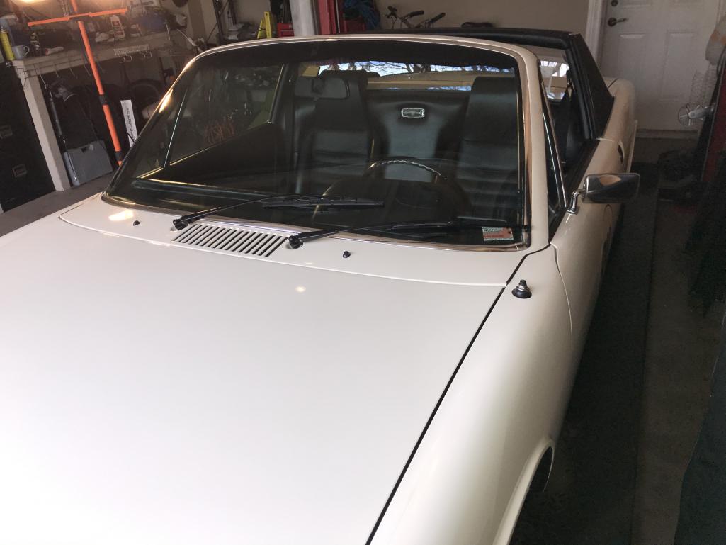

gturner008
post May 14 2020, 09:52 AM
Posts: 127
Joined: 21-April 20
From: Toronto
Member No.: 24,163
Work in progress
