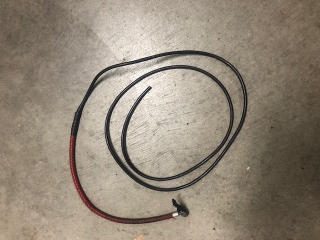

I use a similar system as the post above, but use air from one of my tires, between 20 and 25 psi., and mini garden hose plastic tube connecting tire air to the brake fluid reservoir via the overflow tube, with the filler cap on tight. Here is a pic of my contraption! One word of caution, keep an eye on the break fluid reservoir, and be sure the fluid level does not get too close to the bottom or you will be pushing air into the system and will have to start again!
