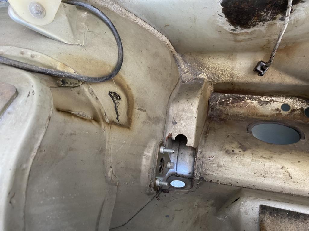

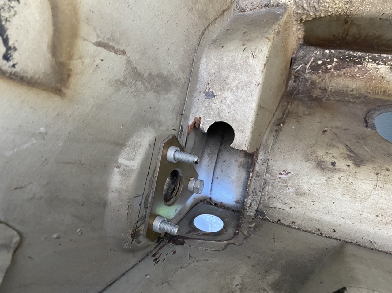

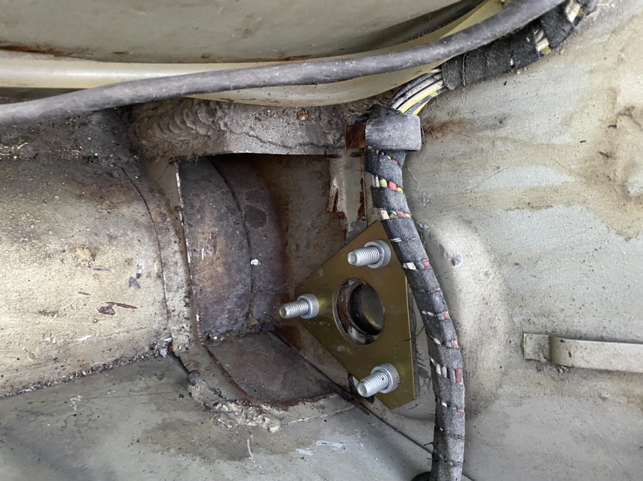

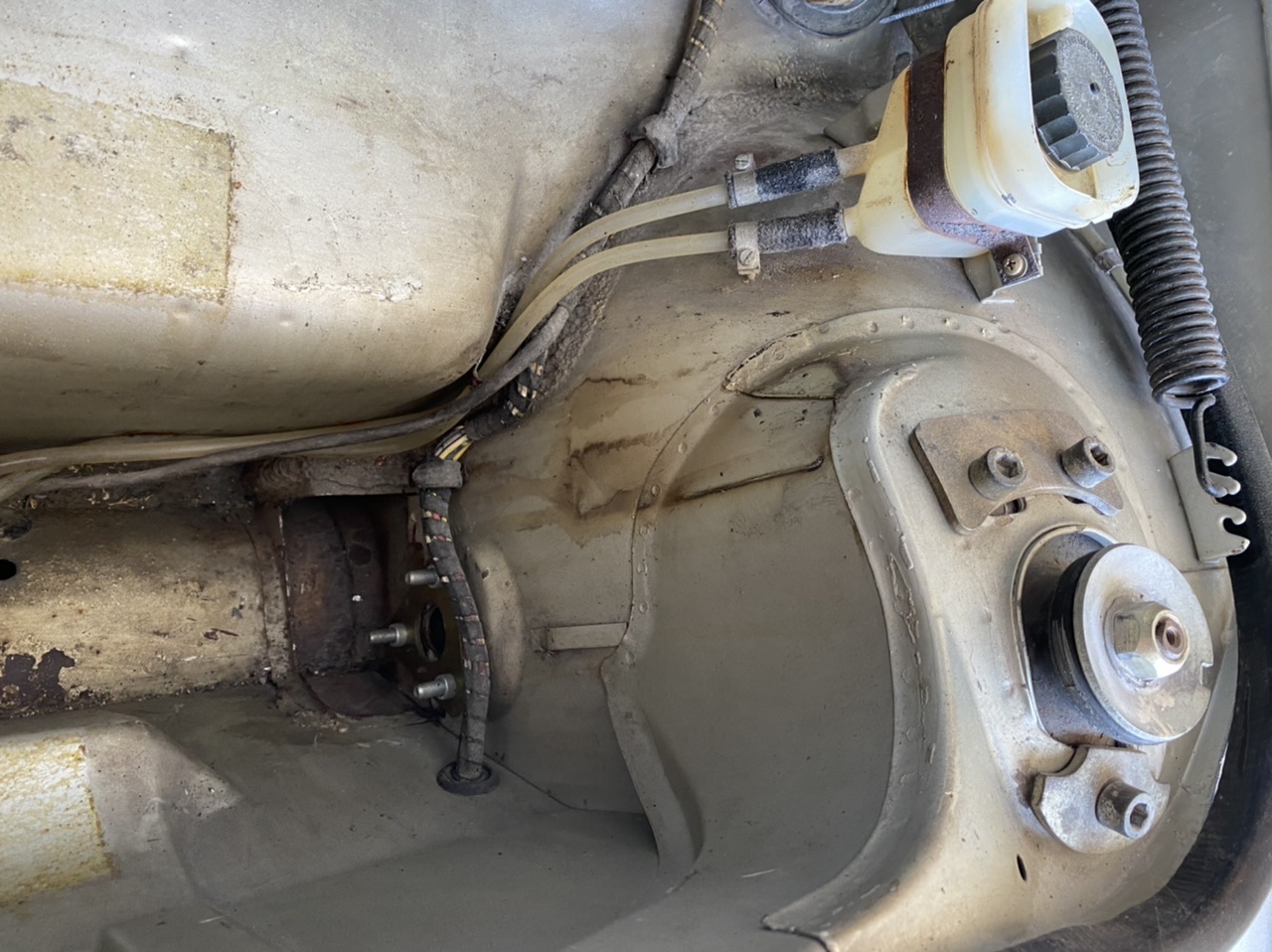

It looks like the PO installed the sway bar too low. And in so doing cut the frame. See pictures.
I’m not worried about installing a sway bar right now. But the frame - should I be worried about this? Drivable as is? Fix before putting it on the road? Anybody have a picture of what it looks like with the proper sway bar installation in this area? Attached thumbnail(s) |

mepstein It looks like the swaybar is in the right place. U... May 23 2020, 09:59 AM

It looks like the swaybar is in the right place. ... May 23 2020, 10:03 AM

Chris914n6 Mounts look about an inch low.
It's there for... May 23 2020, 10:34 AM
mepstein I would drive it until you are ready to go in and ... May 23 2020, 11:36 AM
cuddy_k Yep. Brad's mounts are what I used on my car (... May 23 2020, 12:58 PM![]() ![]() |
