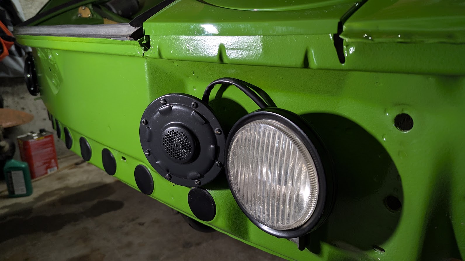

- I re-assembled the horn using slotted screws purchased from zoro. Wish I had started shopping there sooner. Belmetric has been my go-to, but shipping costs are a bit high. Got 100 screws for $5 from zoro. The horn and fog lights were the last of the exterior lights/lenses to be re-installed.

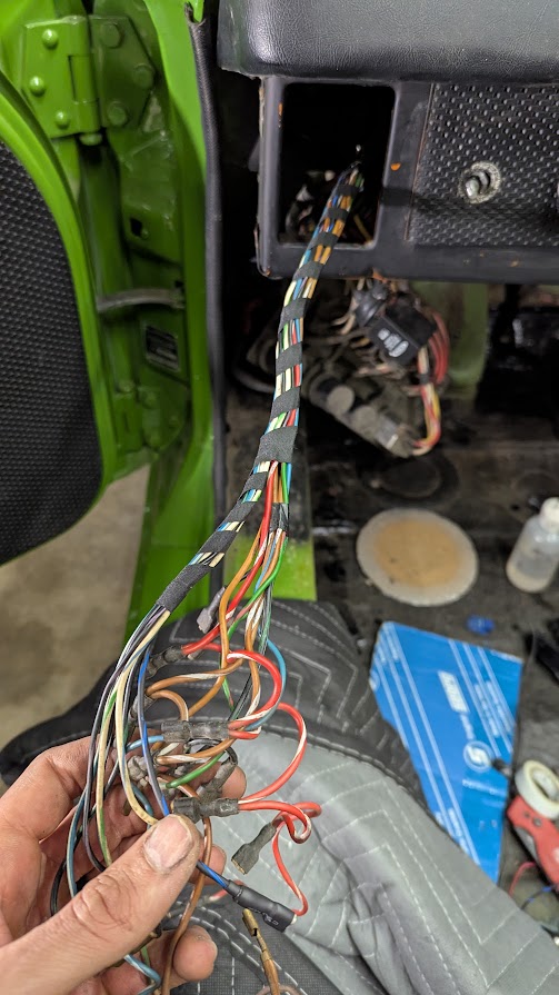

Next was cabin wiring. After viewing a 'Watch Wes Work' video where he re-spliced 40 wires in a wire bundle that someone had drilled through, I was convinced I needed to start using better butt splice connectors. So I got yet another crimping tool and an assortment of non-insulated butt connectors. Really happy with them, the crimps are strong and with just a layer of heat shrink applied after install they are slimmer than anything else I have tried.
There were a handful of wires leftover from a PO radio or security system. In the process of untangling and removing those connections I found that they had tapped into the instrument backlight circuit, which was being powered by a replacement jumper wire from the headlight switch because it looks like the original wire had shorted and melted. I got a short section of black with blue stripe wire and re-ran the wire from the switch to the dash. There were also a questionable repair to another melted wire on the switch that I replaced. I re-taped the bundle and re-installed the headlight switch.

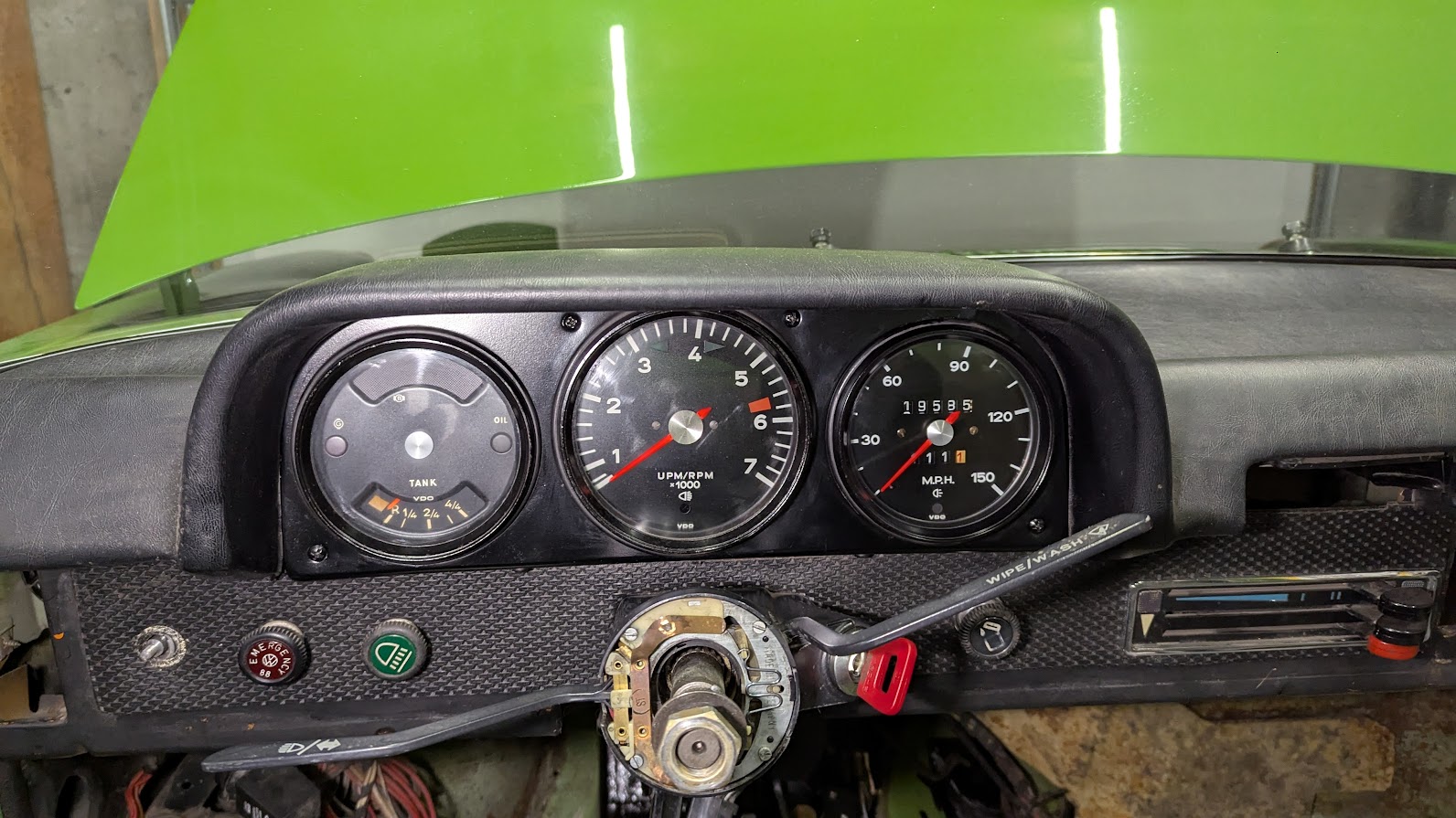

While I had the instruments out, I soaked the instrument panel sheet metal in evapo rust and then repainted it. I am pretty sure I re-painted this back in 2008 after I bought the car. Just goes to show that rust never sleeps. Hopefully by dissolving all the rust and using a good primer I will have slowed it down.
