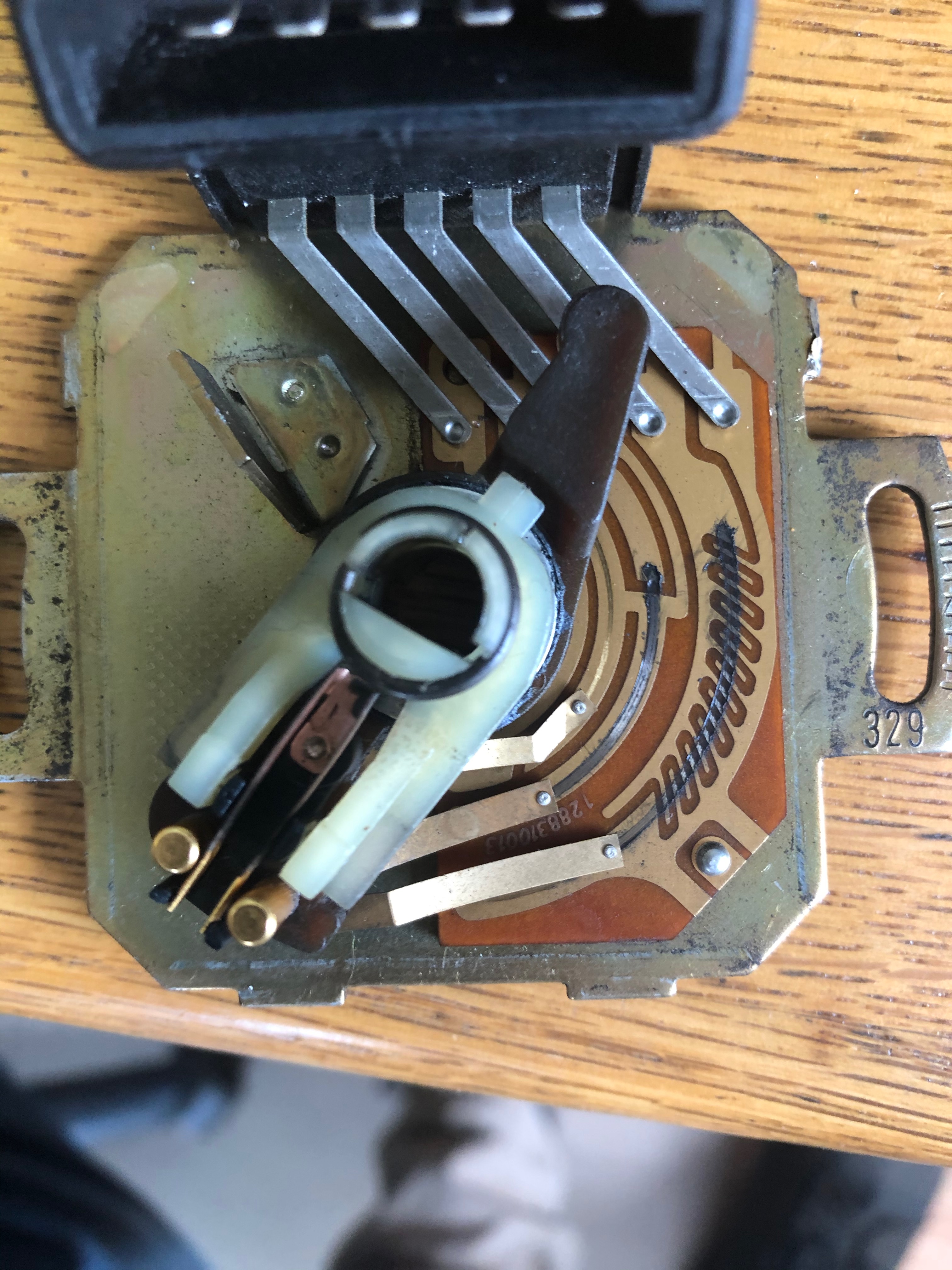

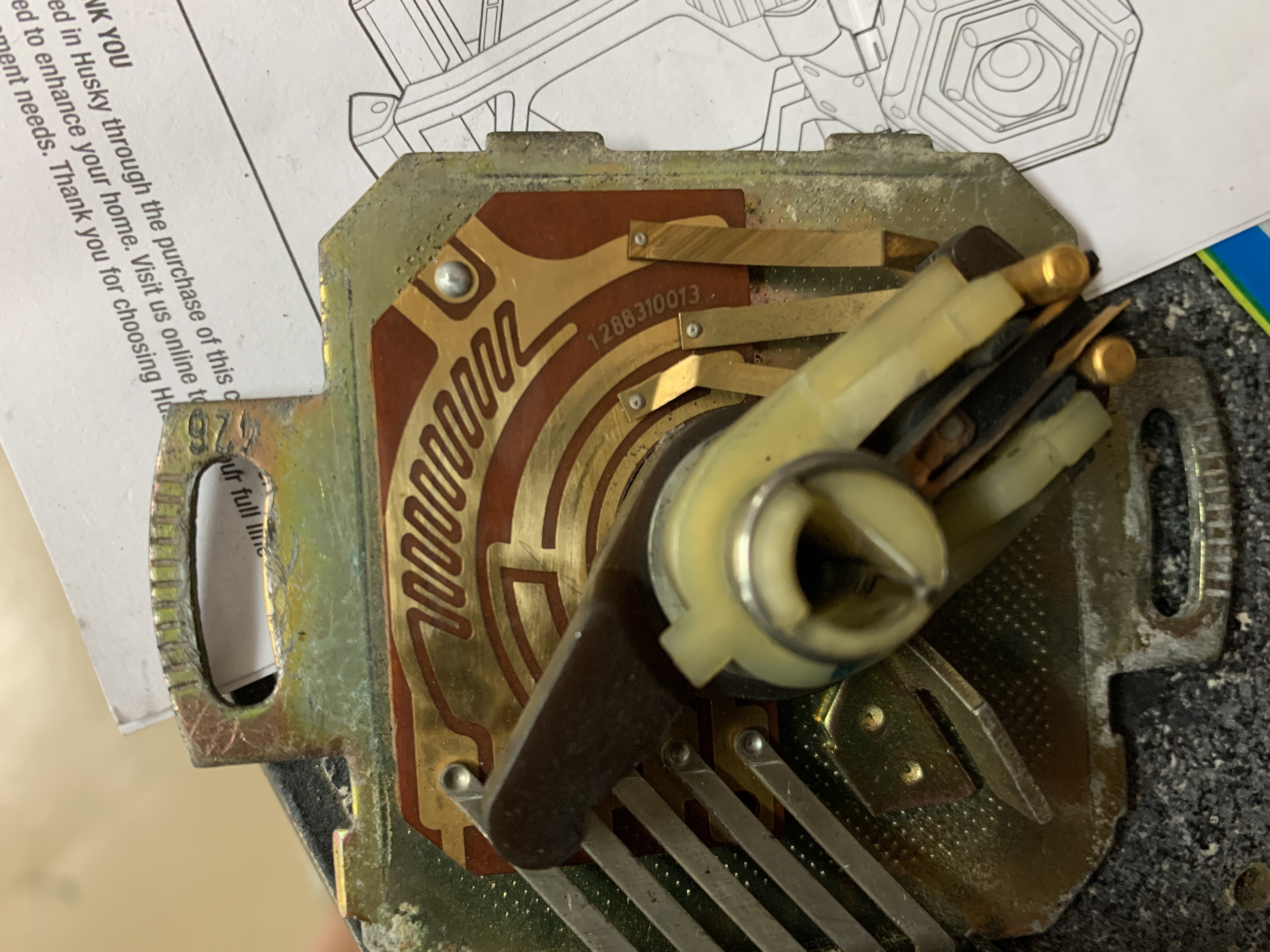

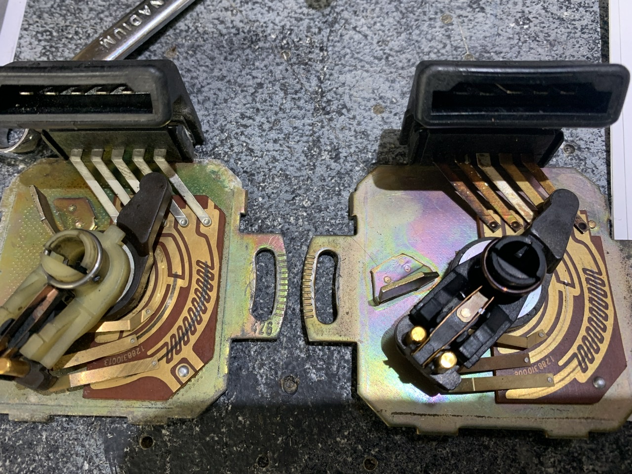

i will post a picture here of 2 OE TPS with part number that cross references to the 75-76 2.0 D-jet cars.
i recently pulled mine due to it bucking badly @ 2800-3400 rpm on part load or mild acceleration.
i also have one from Gatornapper to test for him and he is sorting out his D-jet parts and prepping to eventually going back from carbs to FI.
What i found was that the stop peg is located on a different place. his
essentially stops the tps from going all the way to the bottom at idle but not at the top on acceleration.
mine on the right. stops the pivot of the shaft from going all the way on the top and keeps it from being able to go off track on max, his would not.
they have the same part number. neither had been tampered with.
also i bought mine as an NOS part 7-8 years ago and now may need to be replaced.
his on the left has much more wear, actually live testing it causes same bucking but at a different lower rpm, due to wear pattern.
any thoughts? i will be putting a new board on mine as soon as it arrives
Right now i am running with it unplugged and no skip buck or hesitation now. i had been thinking it may have been an issue with my rebuilt MPS or developers valve set up or a wire shorting somewhere else, but it’s the TPS.

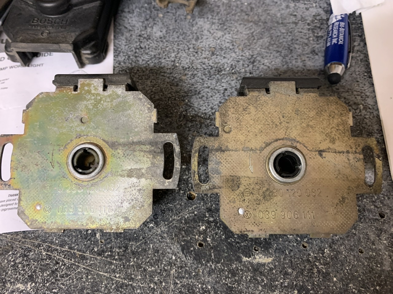

SirAndy   The part number printed on the boards is different...   Jun 8 2020, 10:22 AM
DRPHIL914   The part number printed on the boards is differen...   Jun 8 2020, 10:26 AM
DRPHIL914   The part number printed on the boards is differen...   Jun 8 2020, 10:40 AM

nordfisch   231 is the number on mine, you are saying that t...   Jun 11 2020, 01:23 PM
DRPHIL914   231 is the number on mine, you are saying that ...   Jun 11 2020, 01:30 PM
nordfisch   [quote name='nordfisch' post='2824128' date='Jun ...   Jun 11 2020, 02:25 PM
DRPHIL914   ok update: took advice here and i cleaned the sur...   Jun 13 2020, 02:30 PM
DRPHIL914   thought i’d post a picture after cleaning up the...   Jun 15 2020, 06:19 AM
