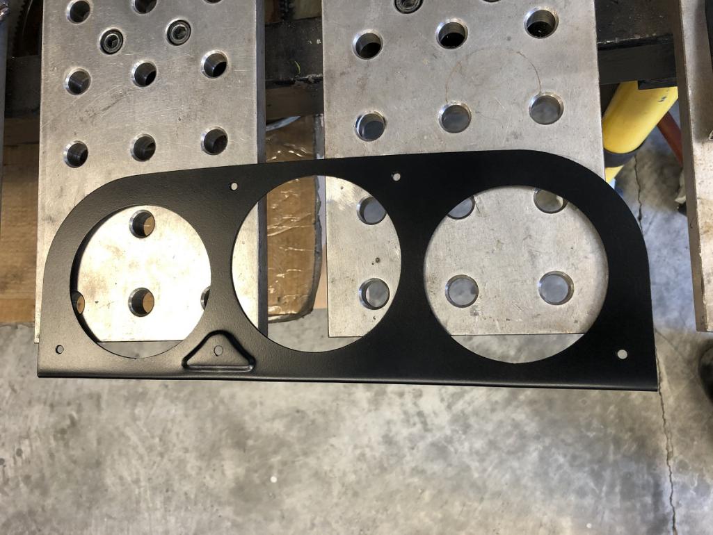

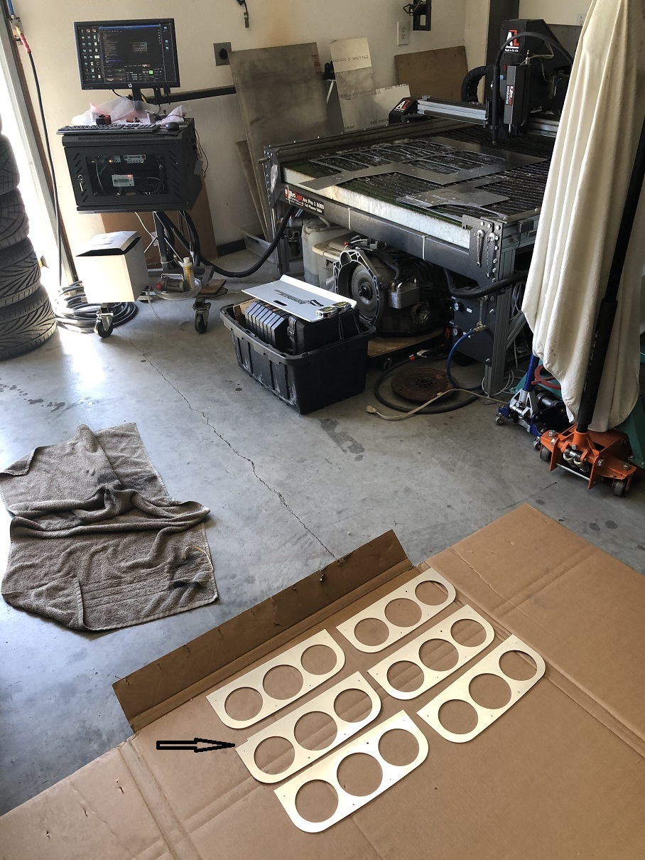

I made 6 SpeedHut gauge panels today. See my post on page 4 of this thread for a "fresh off the plasma table" pic.
If you're still interested, I should have these ready to go in a week or so.
- these are .063 3003 aluminum
- they will not be painted
- they do not have the raised stamping for the dimmer
- they are set up for a 4.5" center gauge, 4" outer gauges
- 3 have holes for the dimmer, 3 don't
$35 plus shipping from 94952.
Yes, I'd said $20 earlier but that was a year ago and I was being too generous with my time and consumables. Just be thankful I'm not making them out of wood. (IMG:style_emoticons/default/laugh.gif)
Let me know if you're interested. I'll probably make more once I get more material.
Thanks again for your patience.

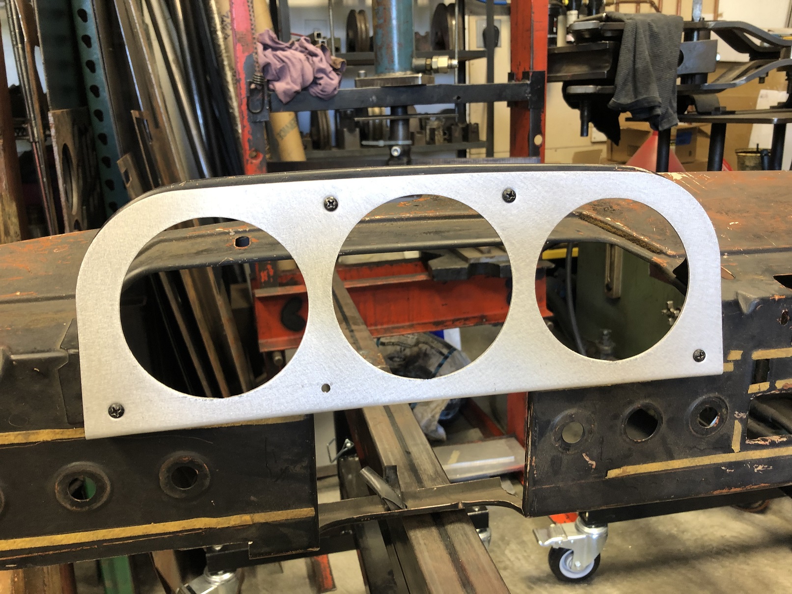

EDIT on 6/24/20:
To the interested parties who've already contacted me or posted here to date:
The plasma table is back in action so now I'm tuning the design. See my post from today (6/24) for the latest updates re: what's new and what I still have to do.

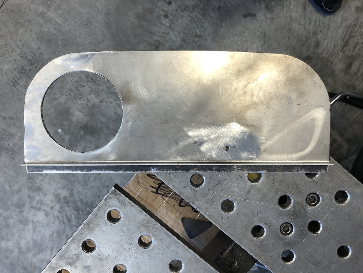

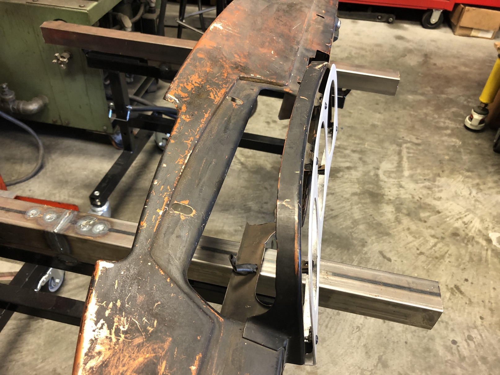

For those using or contemplating SpeedHut gauges, you'll find they are just a bit undersized compared to the stock gauges and require some sort of wrapping or spacer in order to fit well in the stock panel.
I opted to give a go to working up a replacement panel and as I was making it, I thought, while I'm cutting one, I could cut a few more, if there was interest.
This is V1 and it needs a couple minor tweaks, but you get the idea.
Note that it has a 90 degree fold along the bottom edge that I'll stretch so the panel curves a bit, like the factory part.
This one is .060 aluminum but I could do steel, too.
Would anyone be interested in one?

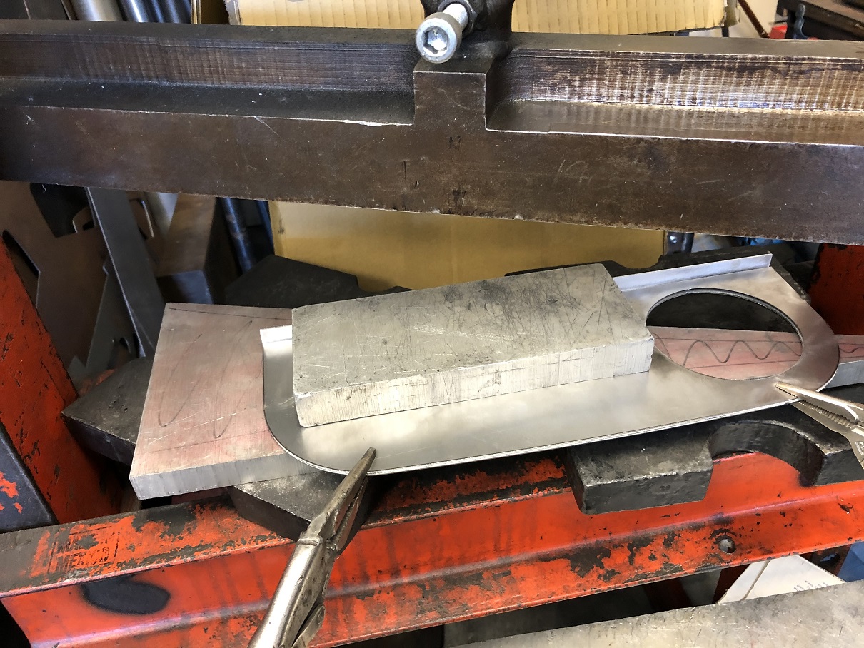

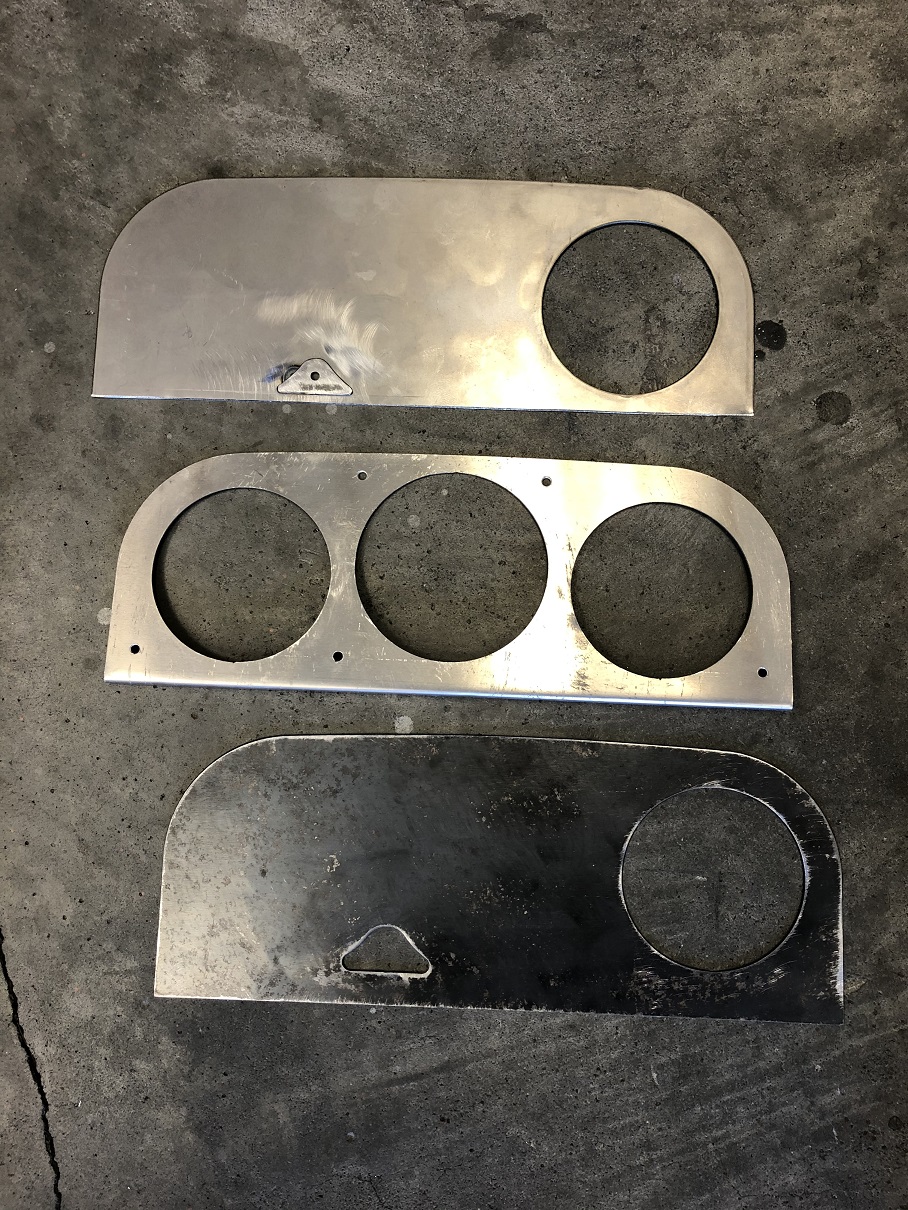

tygaboy   So I went all in and made a stamping die set so I ...   Jul 5 2020, 07:05 PM
tygaboy   Each of these three panels have some sort of flaw ...   Jul 5 2020, 07:13 PM
76-914   Just curious. What stumbling blocks, if any, were ...   Jul 5 2020, 07:21 PM
tygaboy   Just curious. What stumbling blocks, if any, were...   Jul 5 2020, 09:25 PM

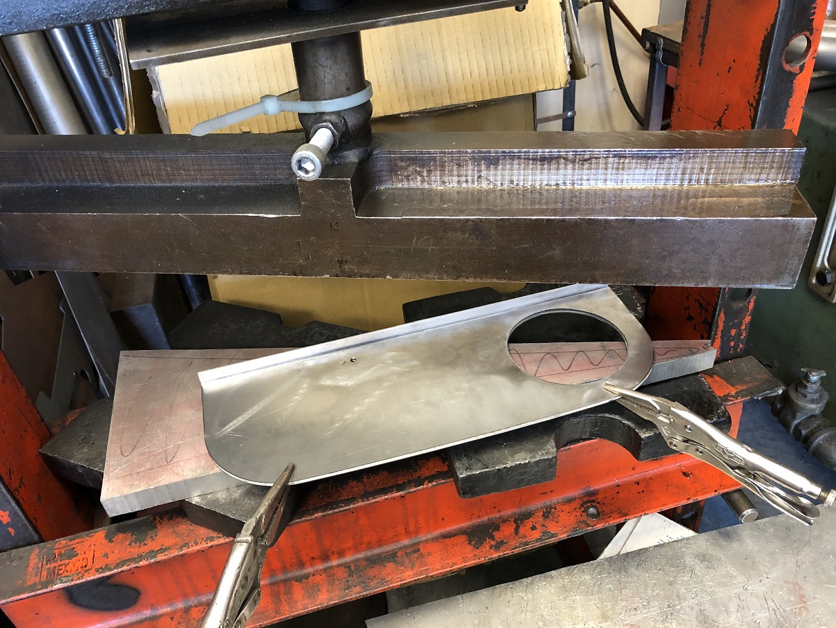

tygaboy   @76-914 - Kent , here's an overview of the pr...   Jul 6 2020, 11:00 AM
tygaboy   For anyone who may be interested, let me back up a...   Jul 6 2020, 11:02 AM
76-914   For anyone who may be interested, let me back up ...   Jul 6 2020, 11:29 AM
tygaboy   I use a couple Vice Grips to hold things in place....   Jul 6 2020, 11:07 AM
tygaboy   Here's the pressing process and the result. It...   Jul 6 2020, 11:08 AM
tygaboy   A trip to the stretcher to get the needed curve so...   Jul 6 2020, 11:11 AM

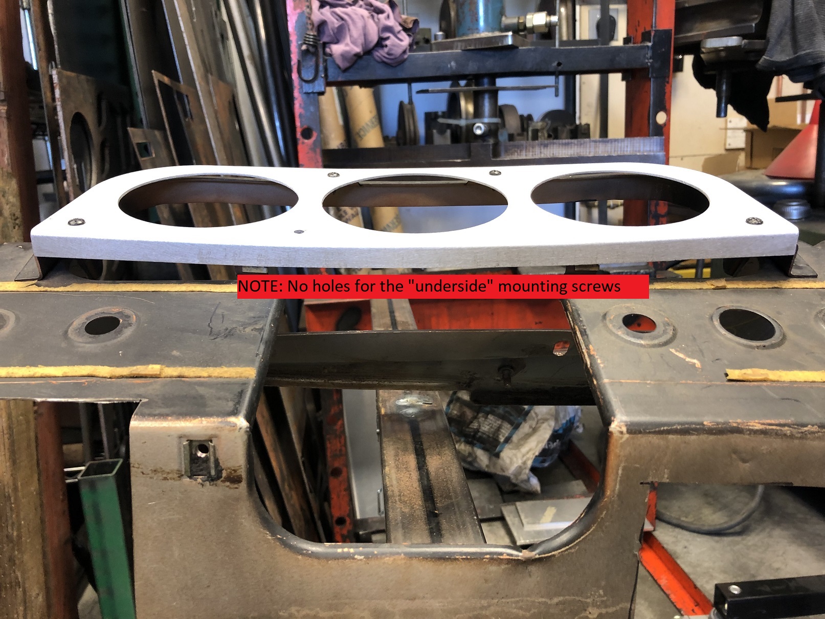

tygaboy   NOTE TO ALL PARTIES interested in one of these pan...   Mar 16 2021, 06:37 PM

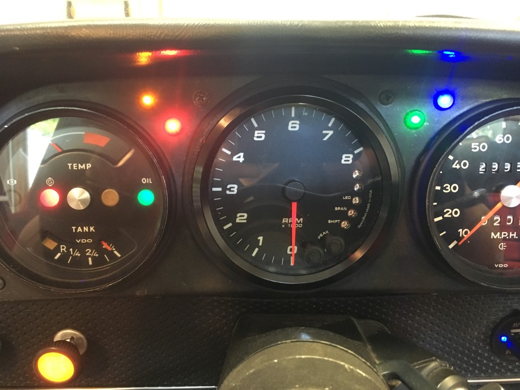

GregAmy   What are you kids doing for turn signal and high b...   Mar 16 2021, 08:09 PM
Chris H.   Hey Greg, The Speedhut speedo has turn signals an...   Mar 16 2021, 08:57 PM
GregAmy   The Speedhut speedo has turn signals and high beam...   Mar 17 2021, 07:43 AM
GregAmy   Quick follow up. I bought some LEDs off eBay and ...   May 20 2021, 03:27 PM

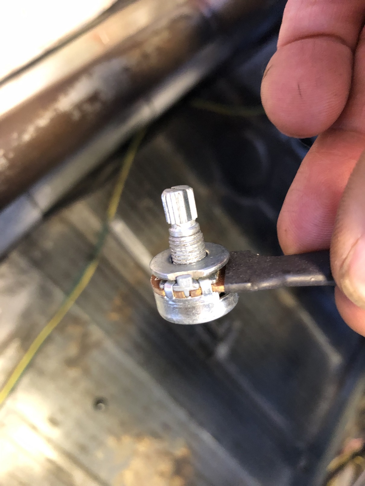

tygaboy   While I had the plasma table fired up to make a ne...   Jun 6 2021, 05:13 PM

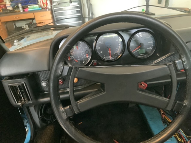

808 WRX   Here is mine in place with some "phantom...   Jul 7 2021, 09:47 AM
