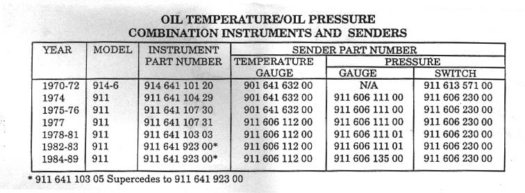

QUOTE(sixnotfour @ Jun 22 2020, 10:20 AM) *
pn on gauge ?? ...then its easy
Thanks Jeff, this will actually come in handy to ensure I'm using the correct sending units!
