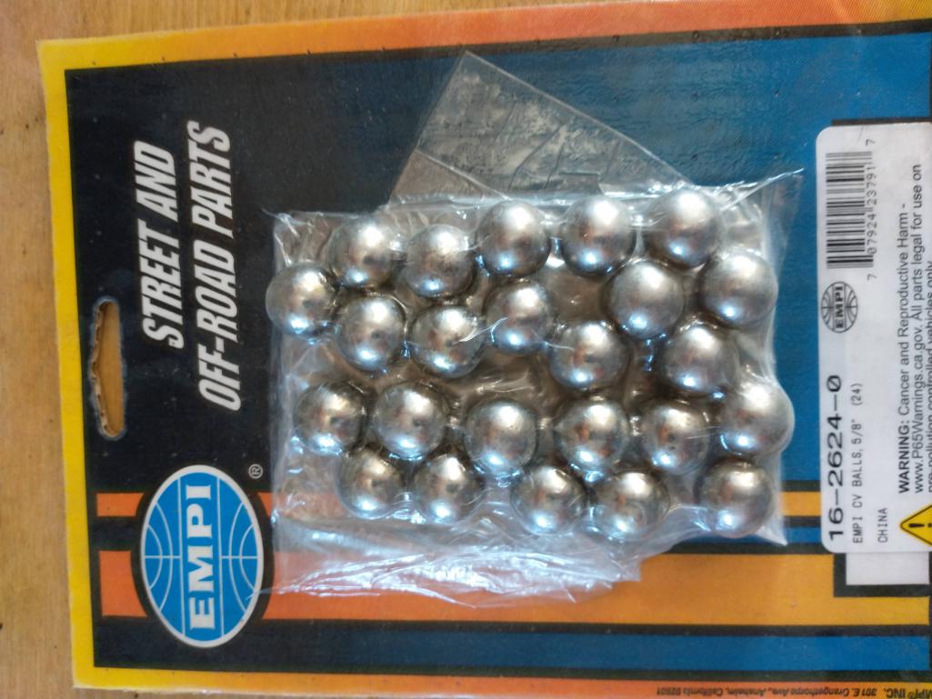

Does anyone have a single "marble"? My CV joint came apart earlier today and has only 5 ball bearings (is this a thing that people put these back together with one missing?) Anyway, WTB one bearing, please.

24 of these arrived today. If you need one please PM me with your address and I'll mail them out until they're gone.

I now have an inkling of why my CV joint was short a ball; with extreme care, you can put this wiggly puzzle together with 5 balls but keeping them all in their channels while placing the 6th is maddening. I watched the Youtube videos for guidance but they were all made on the bench, separated from the axle. Doing so under the car with the race stuck on the end of the axle was an endless game of marbles. Moments after success I quickly bolted it to the transmission flange (with 22ft/lb) and then wept for hours.
