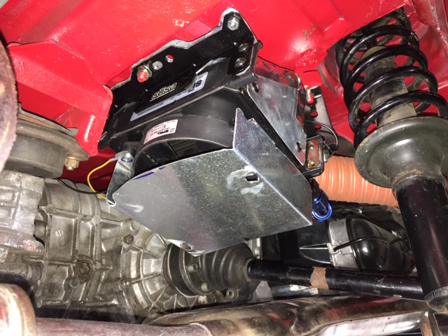

Here's my setup with it angled somewhat down for what I hoped was good airflow: http://www.914world.com/bbs2/index.php?s=&...t&p=2826235
Essentially he says the oil takes "the path of least resistance" which could largely be from the inlet port to the outlet port using few of the cooling rows. I assumed the pressure would fill the cooler, but I can see what he's saying. Any thoughts on that? If that's the case, I really need to completely redo my mounting setup and plumbing.

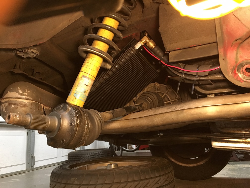

Not using the Setrab sandwich adapter, So I can't help with that issue. (Don't know what brand it is) I am running the Setrab oil thermostat. In that case the oil should follow the path of least resistance and bypass the oil cooler (somewhat) until it hits 180 when all the oil is sent to the cooler.
Mounted my cooler parallel to the trunk floor. that is inclined about 6 deg towards the fittings. both my fittings are on the top.
Another way, and I considered this, would be to mount the cooler with the fittings on the side. Input on the bottom and incline it slightly with the output on top.
I have been driving this thing a lot in the HOT weather we have been having and am really happy with the cooling I see on the Temp gauge.
Where before it would easily hit 250-260 in the heat, Now it rarely gets to 220 and mostly hovers between 200-215

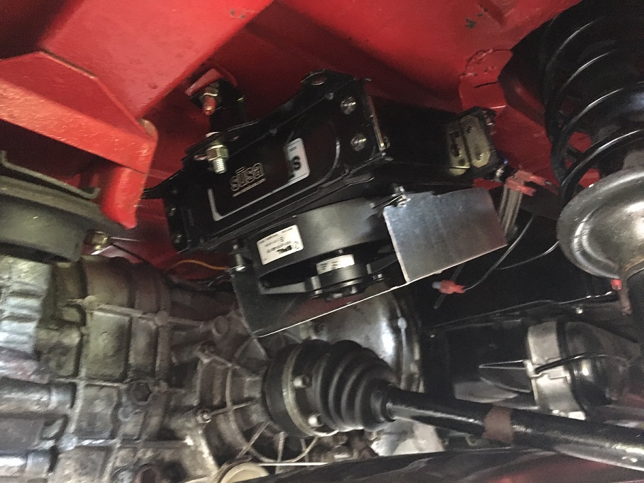

Thanks for the input. I spend a good part of the day undoing my setup from last time (of which I was pretty proud) and then reinstalling the cooler so the inlet/outlet ports are oriented up. It was a bit of a b**** to get the lines to fit, but I got them. I had to swap out the 45 degree AN fittings for some straight connectors. The good news is I can now actually install my grommets where the lines pass through the engine tin, and there's really no change the half shaft is going to interfere with anything.
So much for my shroud and ideal air flow, but air flow doesn't help if it's passing across a largely empty oil cooler with no oil in it to cool.
Here's the current orientation. @Olympic 914 Tom, I know you're concerned about airflow with the fan shroud (as am I). I'm going to see how it works. Good news is it should be pretty easy to remove if needed.
Here's what it looked like originally:
I'm nervous to take it for a ride again in case the seal blows, but you gotta do it, right? Boy it makes a hell of a mess when/if it happens. I'll give it a shot tomorrow. I'm pretty beat right now.

Hey guys, thanks for the interest and input. We had a brief but really intense thunderstorm not long after I posted on Monday evening, and we lost a HUGE branch off our "prized" tree out front. Plus a few Bradford Pears doing what Bradford Pears do. The last two and a half days has been cutting, limbing, loading, and hauling wood. Still not done, but I need to wait for my neighbor with his front loader. I'm absolutely beat from all that "fun."
Anyway, I took it out a few minutes ago. I got it up to temp, and it seemed to peak at around 210 (it's pretty hot out today, too). If that's where I peak, I'm ok with that. Best part is it didn't seem to leak -- I didn't leave a trail of Brad Penn 20W50 on our rural road like I did last week. I still need to take it out some more, as when I've had problems with that seal it's been on the 2nd or 3rd drive. I wonder if it had something to do with the air I was trapping in the system (IMG:style_emoticons/default/confused24.gif)
I kept pulling over to the side of the road and/or turn offs to peak under the car for massive leaks, and at one point to add a bunch more oil that had been pumped into the cooler. As one car was driving by fast in the traffic I heard a guy yell out "NINE FOURTEEN!!!" (IMG:style_emoticons/default/smile.gif)
I do have another issue to address sooner or later -- oil leak at the bottom of the oil pump cover plate. I'm guessing the front seal has given away partly, or perhaps the oil pump cover itself is leaking. Not cool, and either way I'm looking at an engine drop.
