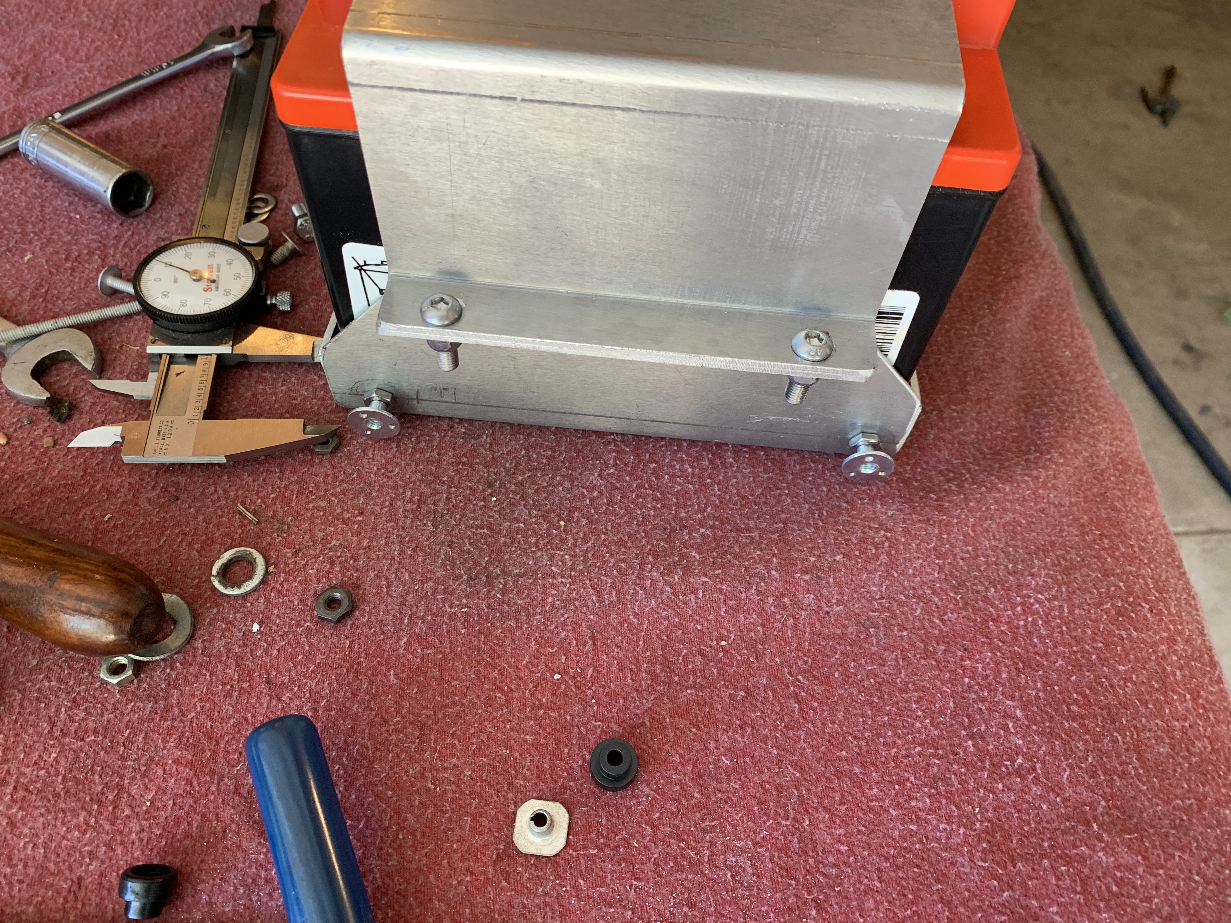

Parts arrived today for the install on my upgrade battery. Odyssey PC924 and Aluminum mount. Just need the terminal kit.
Will post a few pick of the install to follow....

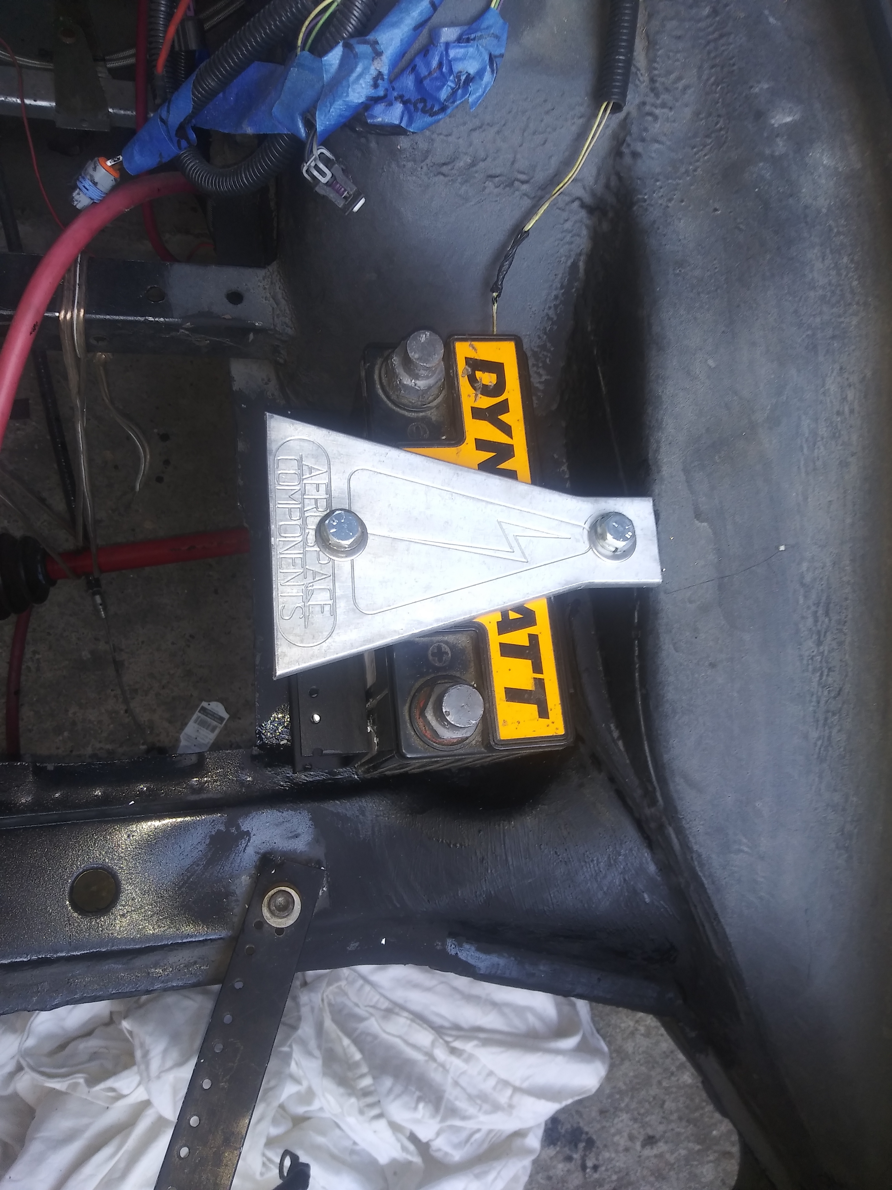

Great Battery 159 bucks 13lbs made my own battery mount using top to old battery mount and aluminum channels. This battery available through summitt racing. Attached Image

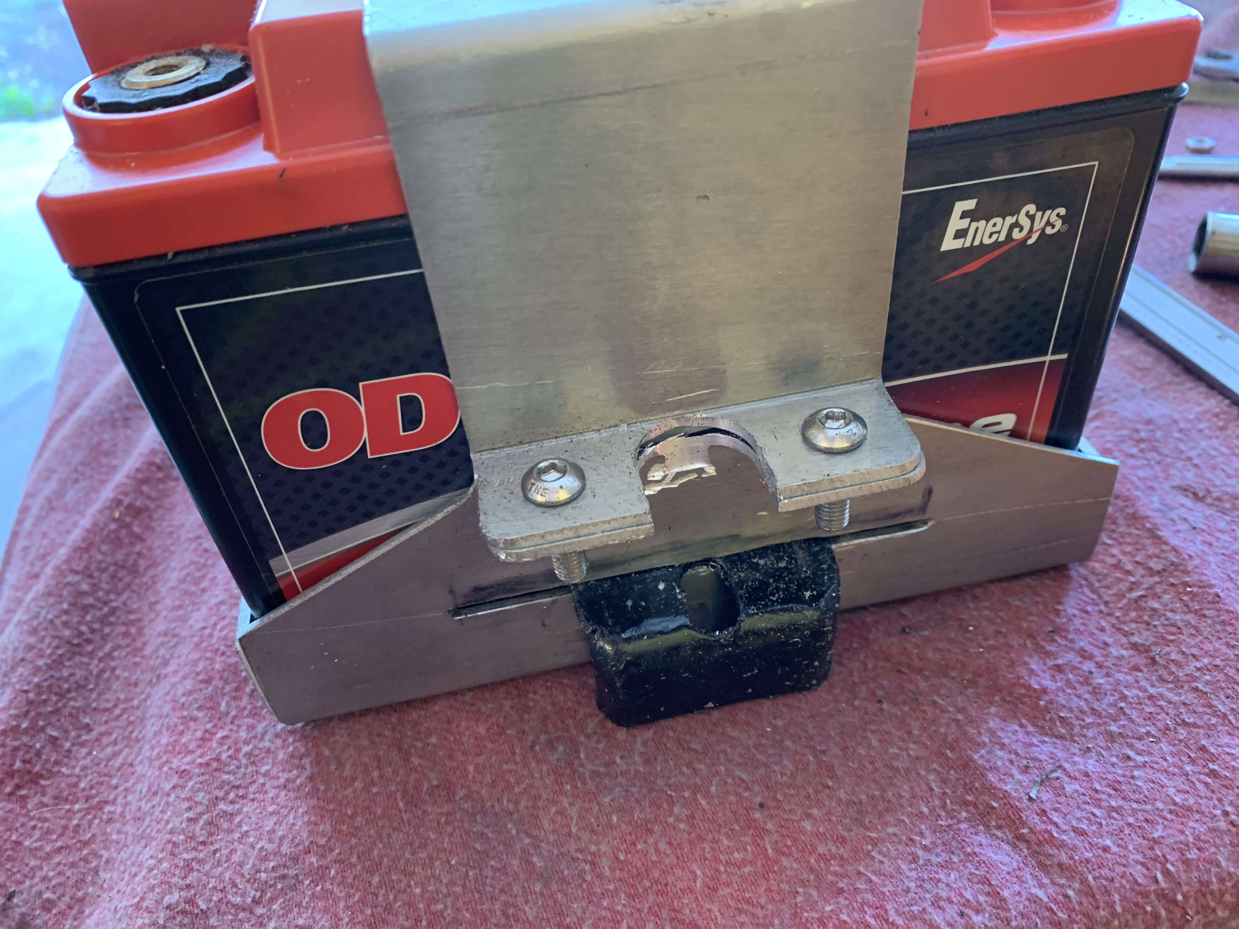

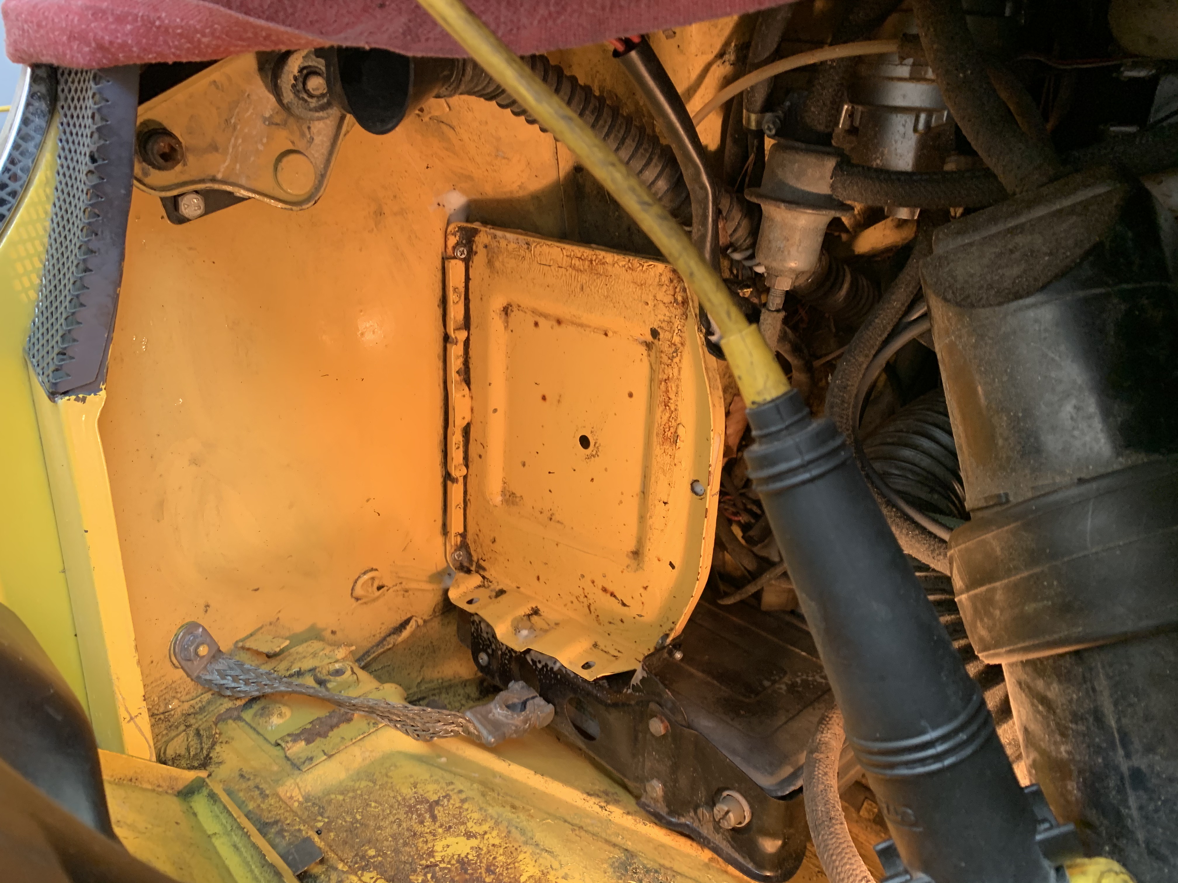

here is the tray ready for the mountAttached Image

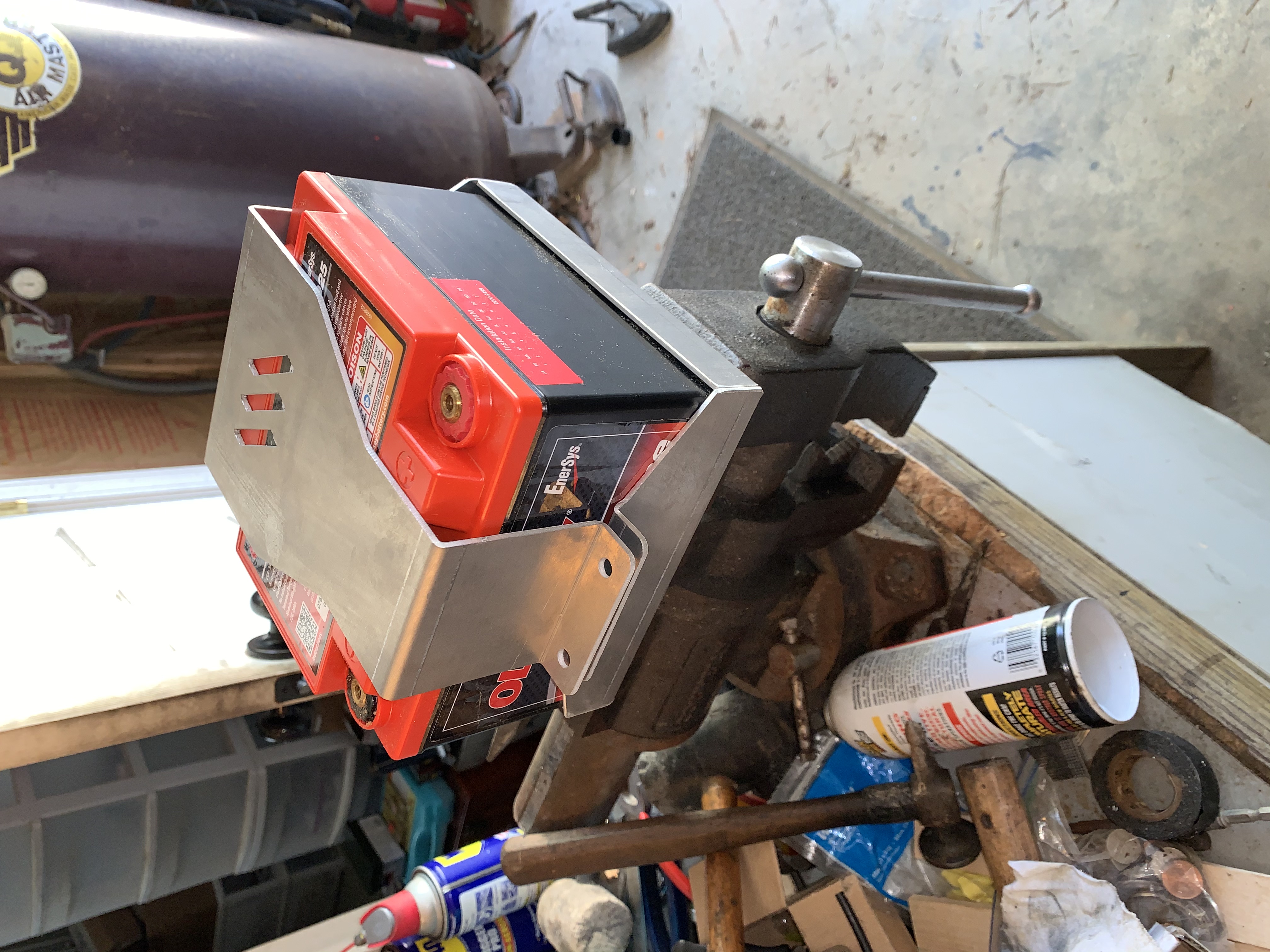

and the battery mount

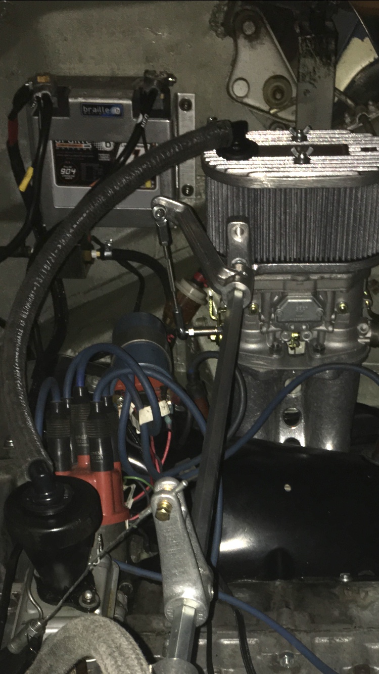

I use an 11 pound Braille battery in my 914.
I also use an 11 pound Braille in my Caterham 7 replica and my boat.
They work great.

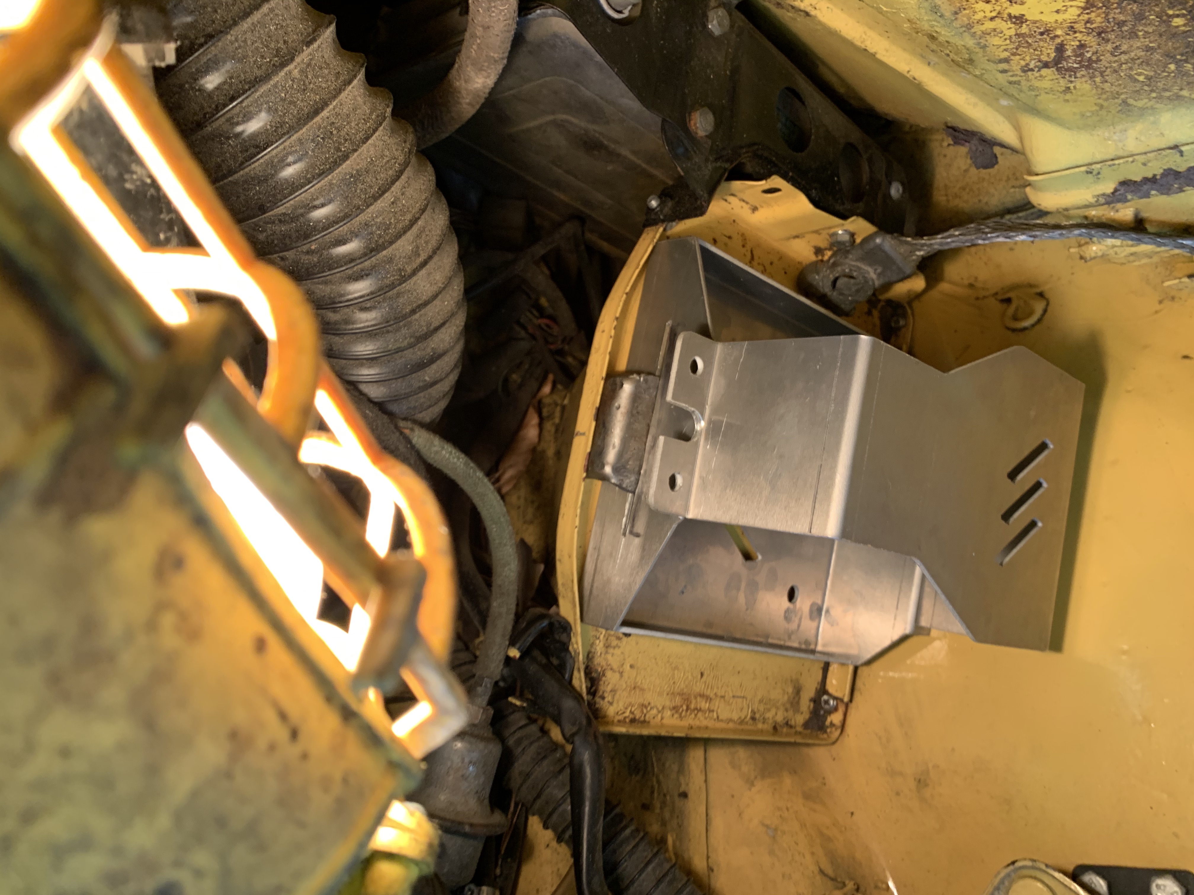

no hole drilling was used to add the mount:

and the hold down side...
