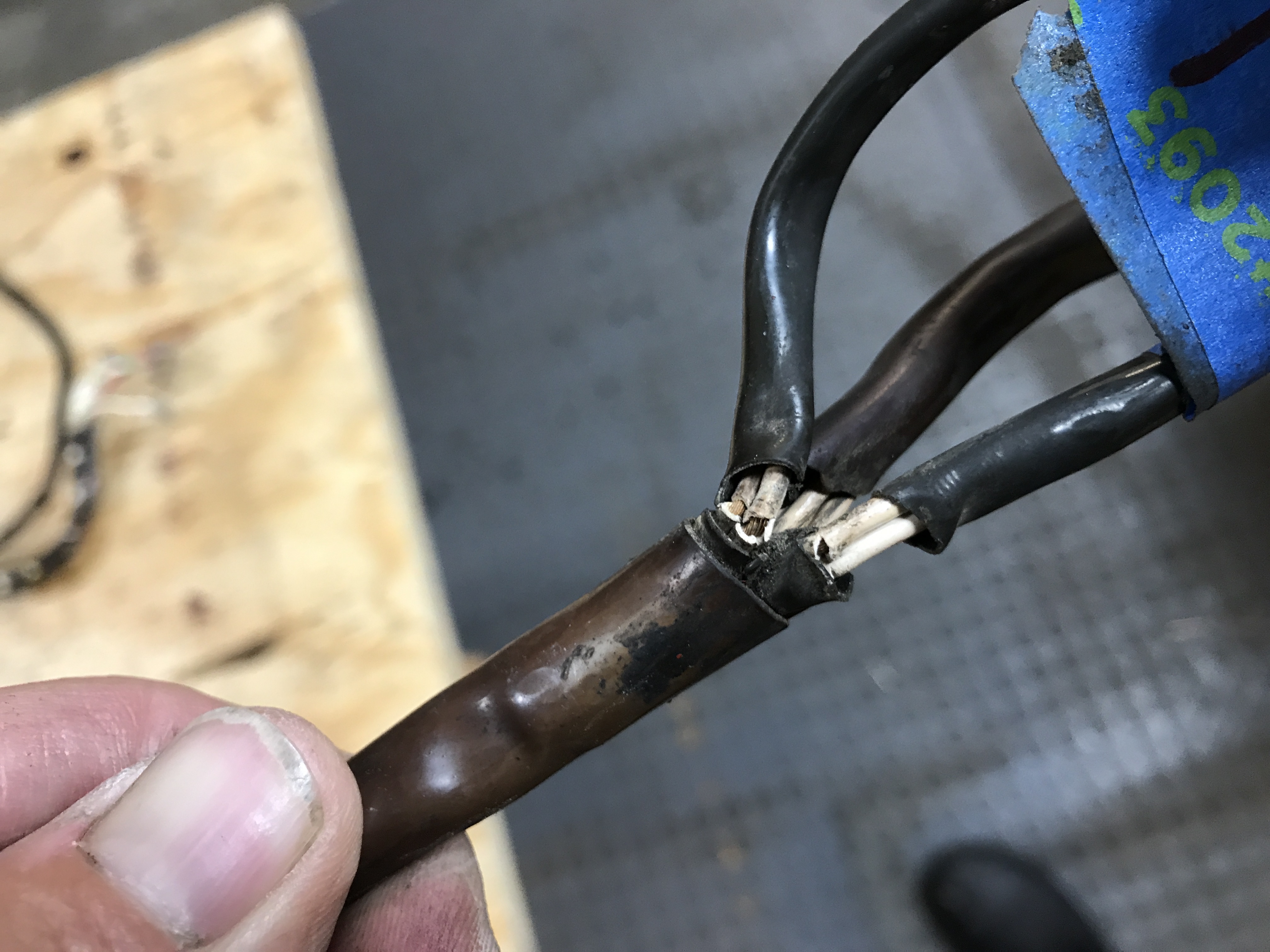

bkrantz
post Aug 2 2020, 08:42 PM
Posts: 8,805
Joined: 3-August 19
From: SW Colorado
Member No.: 23,343
A closer look at some of the wires--not very encouraging.
IronHillRestorations
post Aug 2 2020, 09:25 PM
I. I. R. C.
Posts: 6,956
Joined: 18-March 03
From: West TN
Member No.: 439
Get a new FI harness
