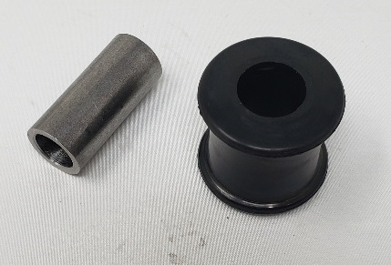

We will be selling a "kit" of 2 new rubber bushings, and 2 new metal shafts for $19.99 on GB

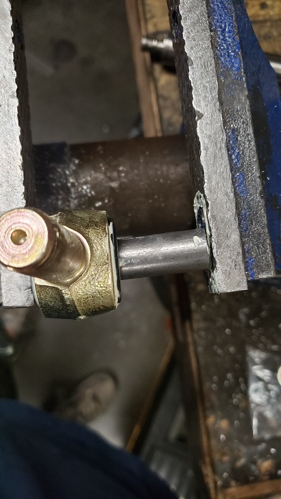

1st you have to press out the old rubber and metal bushing. you can do so using a similar technique to the install using a bench vice and sockets.
The product is designed with VERY tight tolerances. The rubber has to fit securely into the eye bolt casting so it was designed to be a very tight fit. The metal bushing "tube" were actually machined so that once the rubber was compressed they would fit and expand the rubber further locking it into place.

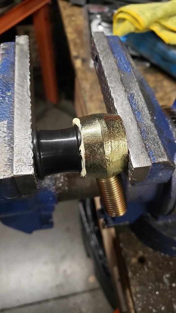

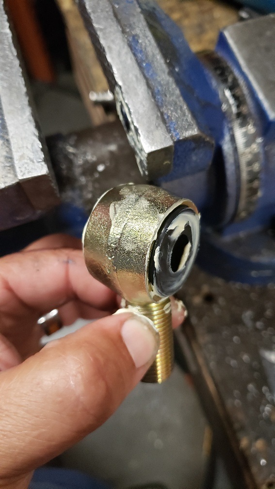

1st you need to lubricate the the bushing and push in using a bench vice.
The rubber has the proper density that it will pop out the back side when released from the vice

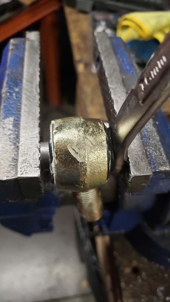

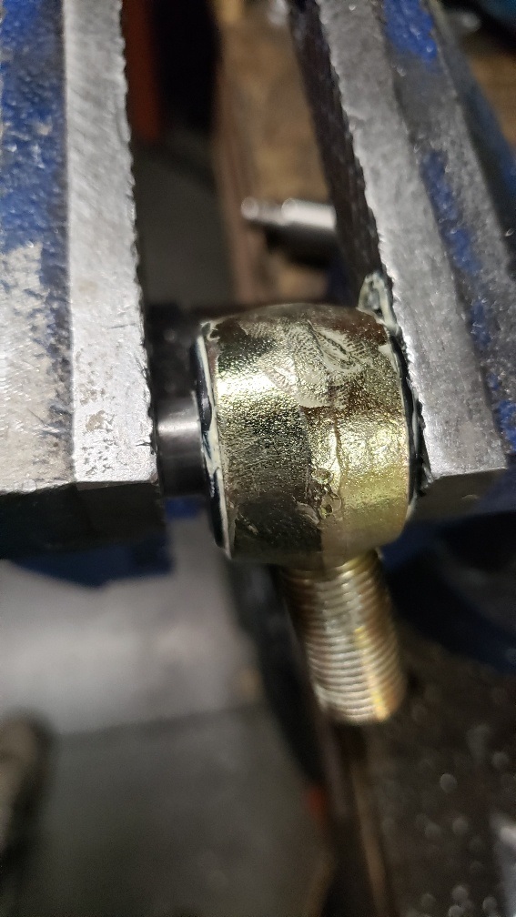

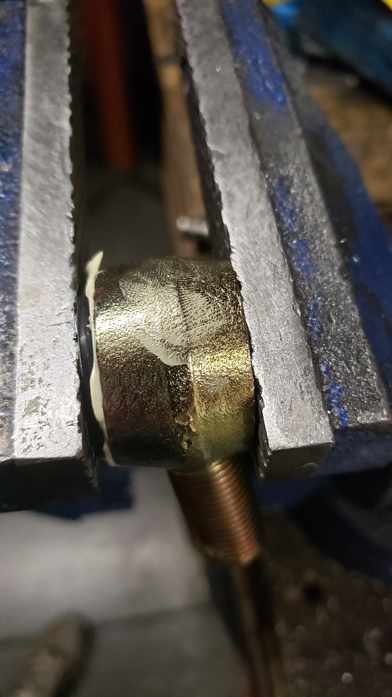

Then insert the tube using the same technique
When it is flush in the vice you can use a wrench to center the tube.

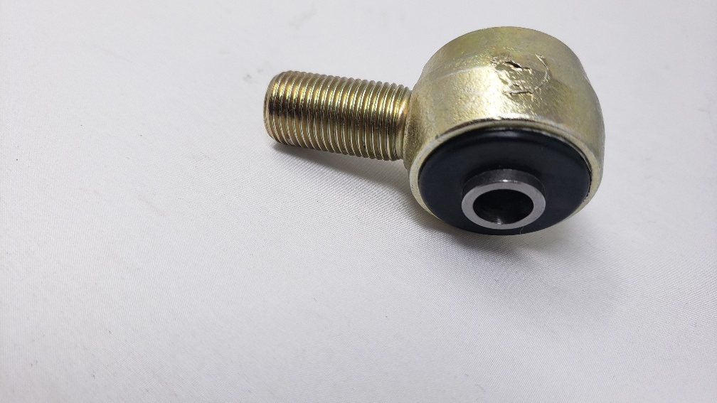

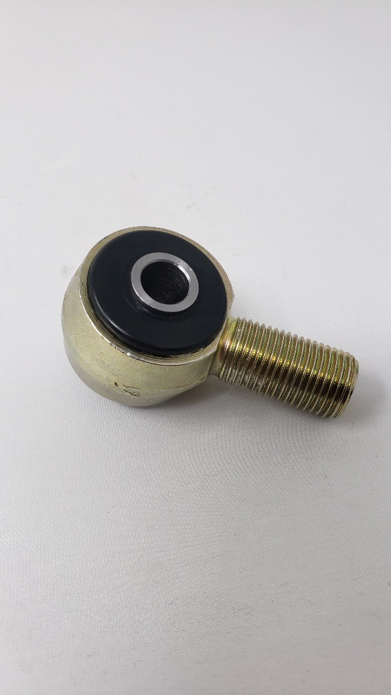

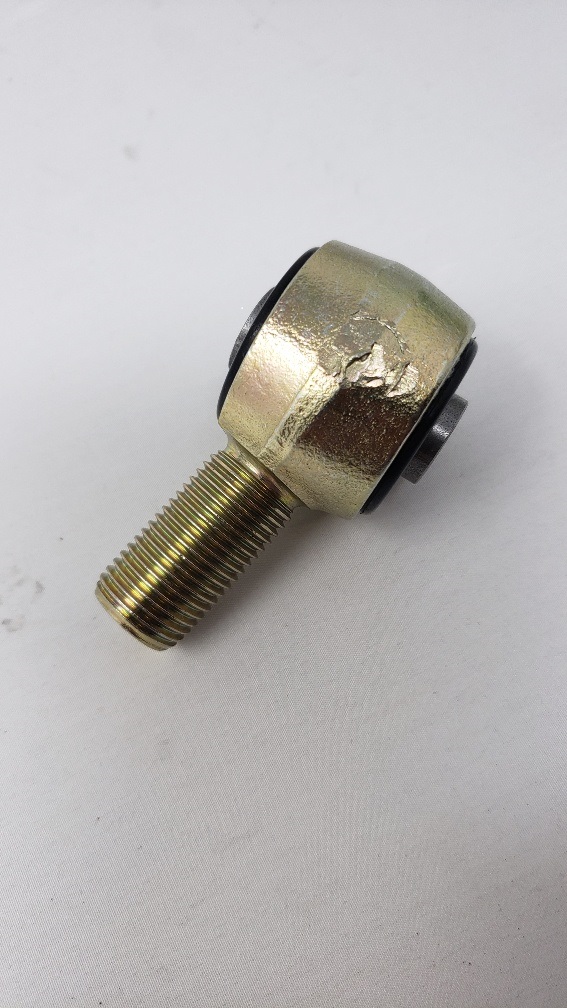

And the finished part
