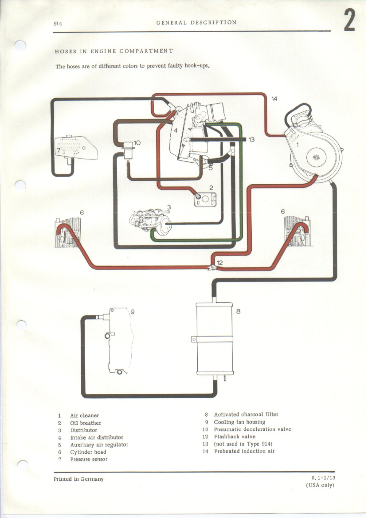

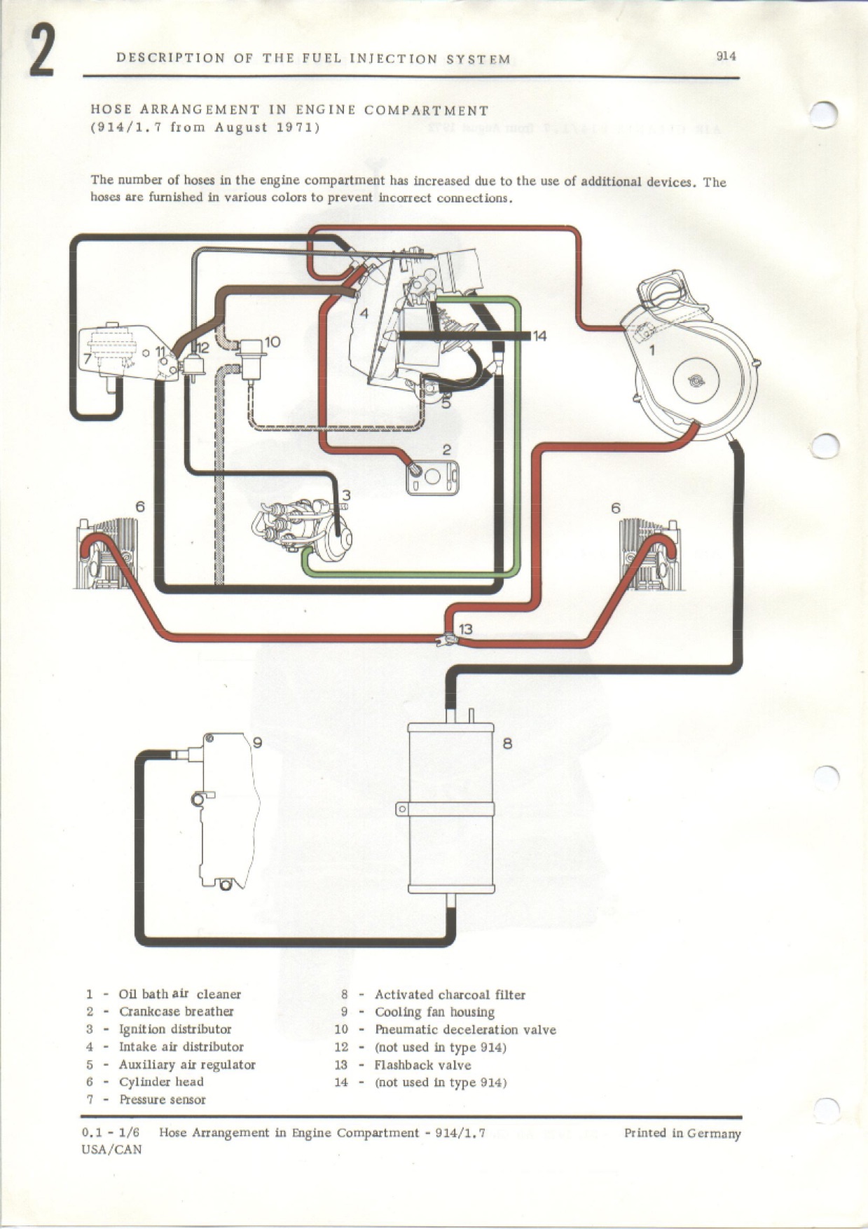

StarBear   @wonkipop Here is a revised layout diagram, show...   Jan 21 2021, 11:51 AM

wonkipop   of interest re evap emissions plumbing. 73 beetle....   Jan 22 2021, 11:04 AM
wonkipop   researched this last year when replacing vacuum ho...   Jan 22 2021, 11:21 AM
wonkipop   re mr sb's thoughts on emissions engineering/w...   Jan 22 2021, 12:35 PM
wonkipop   74 emmission warranty material.   Jan 22 2021, 01:05 PM

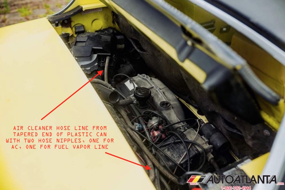

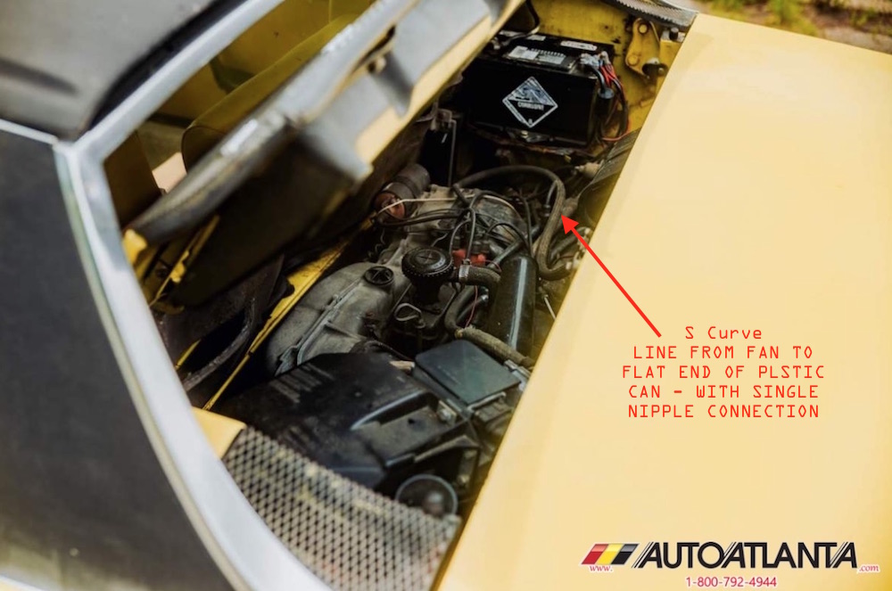

StarBear   @dr914 @autoatlanta.com George - might you have an...   Jan 24 2021, 09:17 AM
StarBear   Another hose layout - presumably (?) a 74 1.8L wit...   Jan 24 2021, 09:49 AM
wonkipop   Evolution of the porsche evap system 1969-78 for 9...   Jan 24 2021, 02:23 PM

Mark Henry   Is the hose sizes correct in the pic below, are th...   Feb 22 2021, 02:38 PM
StarBear   Is the hose sizes correct in the pic below, are t...   Feb 23 2021, 07:19 AM
JeffBowlsby   Here you go Mark, if you choose to use my hose dia...   Feb 25 2021, 03:18 AM
Mark Henry   Excellent! Thank you Jeff I have four 2.0 buil...   Feb 25 2021, 11:52 AM
