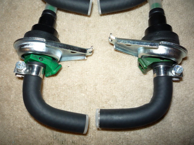

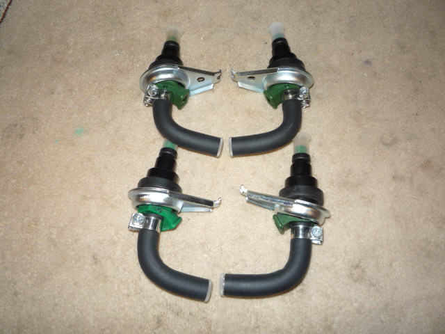

Just a little side note about installing the clamps on your fuel injectors. Set them up so your screws are to the outside in the event you need to tighten them. Otherwise you might have some fun getting to them., two to the left, two to the right.
