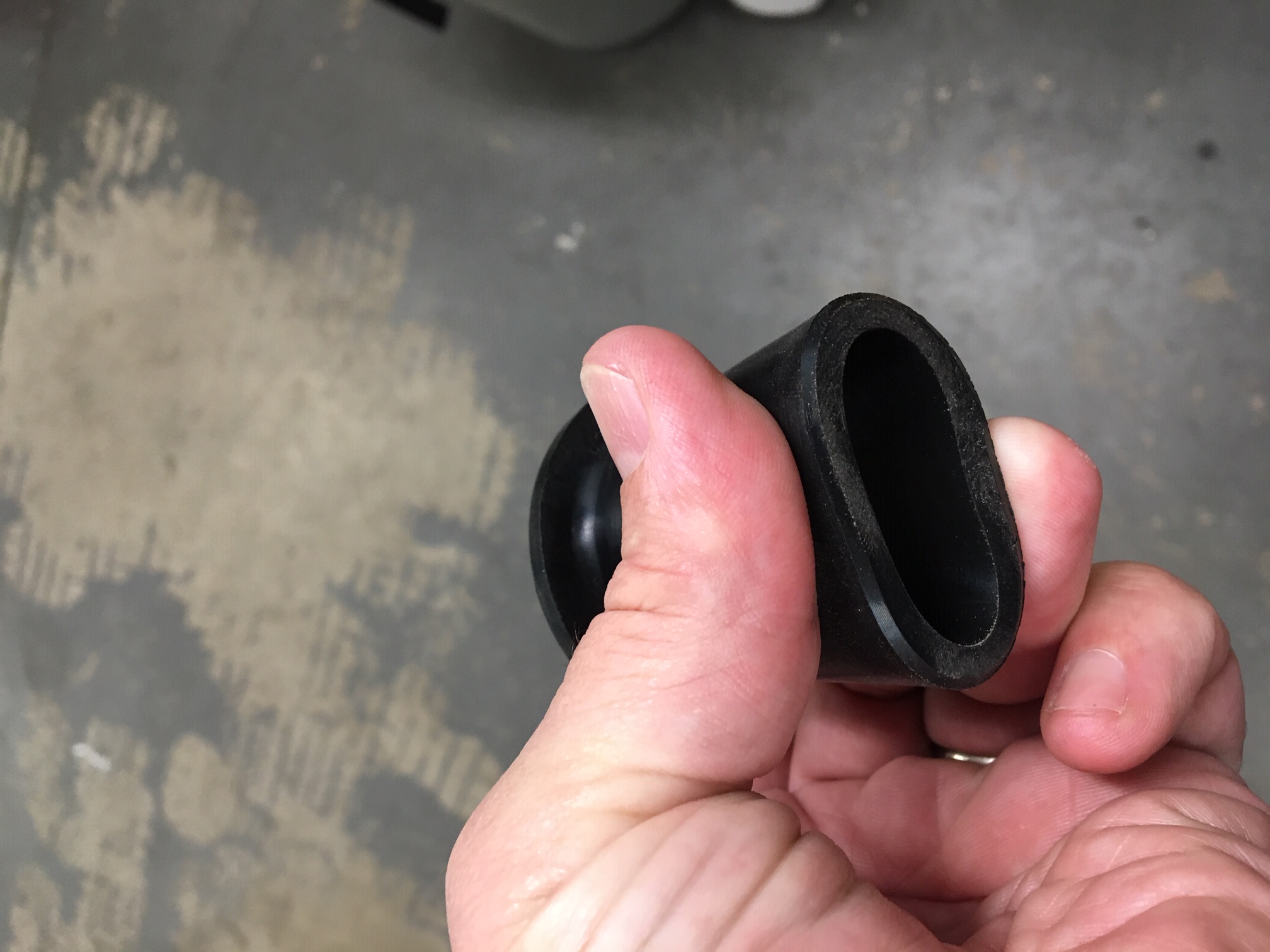

QUOTE(Montreal914 @ Sep 7 2020, 12:33 PM) *
I got a set of 914Rubber with the group buy not too long ago. I haven't installed them yet. But they are rubber. Attached Image
Uh...back on track (IMG:style_emoticons/default/dry.gif)

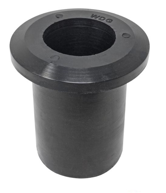

So I need to do a Trail arm rebuild for a customer & I looked up the offerings
ER are indeed pricey at near $400 for their "Kit" only..
Rubber lists an item for bush'es only, but no description & the pic doesn't look like a rubber part
more like a poly part?
