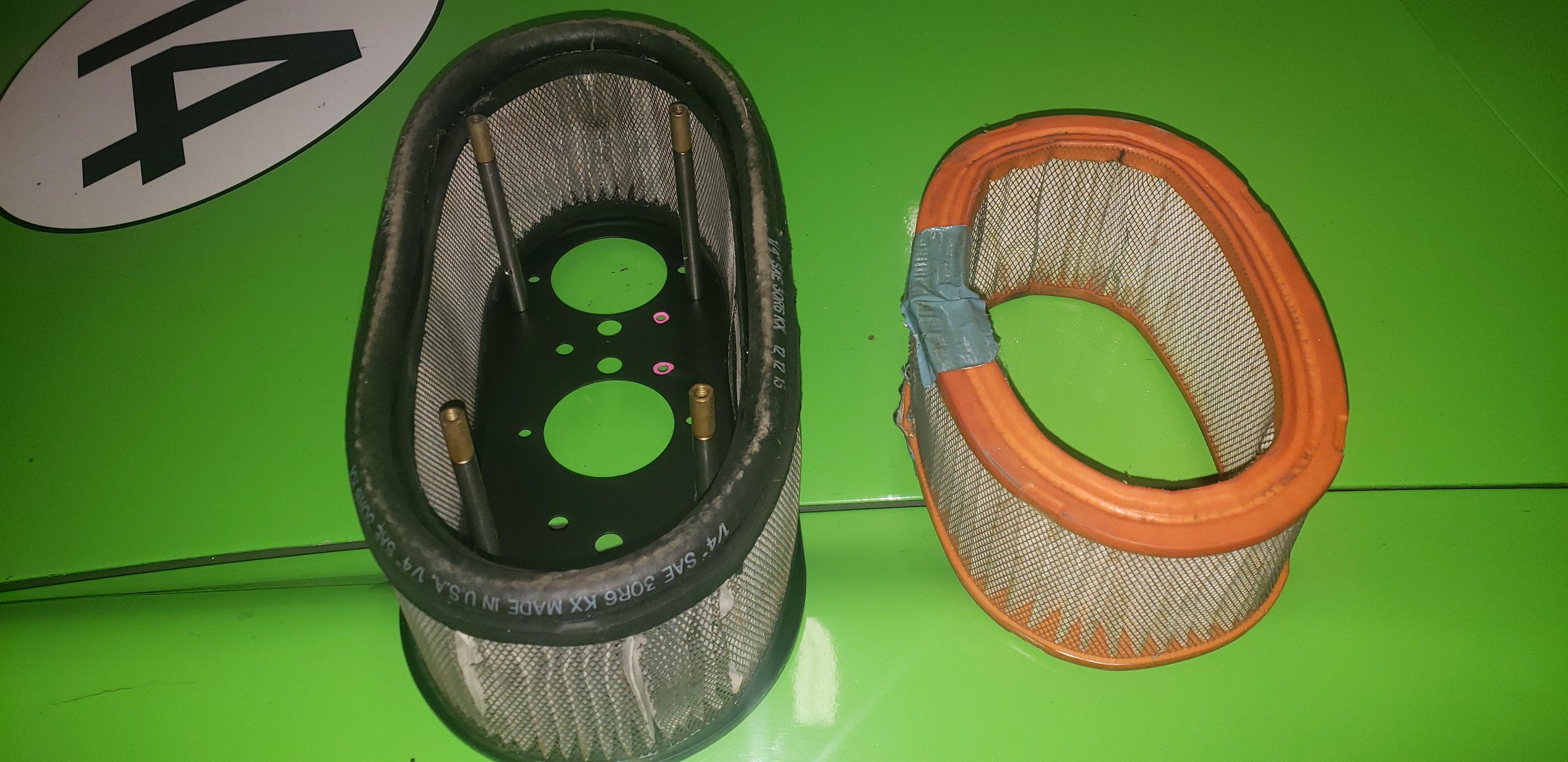

[quote name='mb911' date='Sep 9 2020, 03:45 AM' post='2849697'
Yes K&N is crap.. Wish I could by a paper element for my webers..
[/quote]
Well...you can, sort of...here's a pic of what I did to make up paper filters for my /4 and /6. Takes some research on the WIX filters dimensions pages (https://www.wixfilters.com/Lookup/FilterBySize.aspx) to find the closest height and diameter of the round filters, then squash it to oval. This worked for the /6 on the left and you can see that I added height via some fuel hose glued to the top to get the lid further from the velocity stacks, also had to put in spacers on the uprights to match....Attached Image
For the /4 I found the closest match on height but had to cut & splice the element to reduce the circumference to fit where the lame K&N was--not elegant, but does the job...
