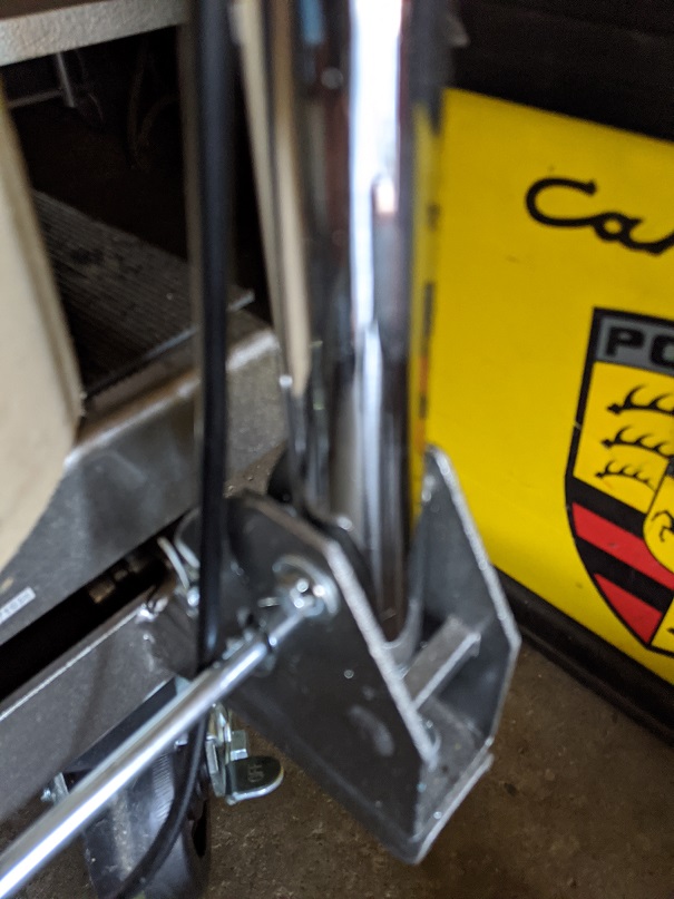

They work well for 911 instal and removals. Because the engine and trans and balance point are further towards the center of the 914, they don't work as easily but they are fine if you unscrew the handle so the table can roll further forward and under the car. You can still use it with the handle detached.
Grab a 20-25% off coupon and get one. You will wonder why you didn't buy one earlier.

I fixed the handle problem by turning around/flipping the handle base mount on each side. It's only 4 bolts to remove and reinstall.
This makes it so the handle will lay down flat which helps centering the lift under the 914.
The release works fine in that position.

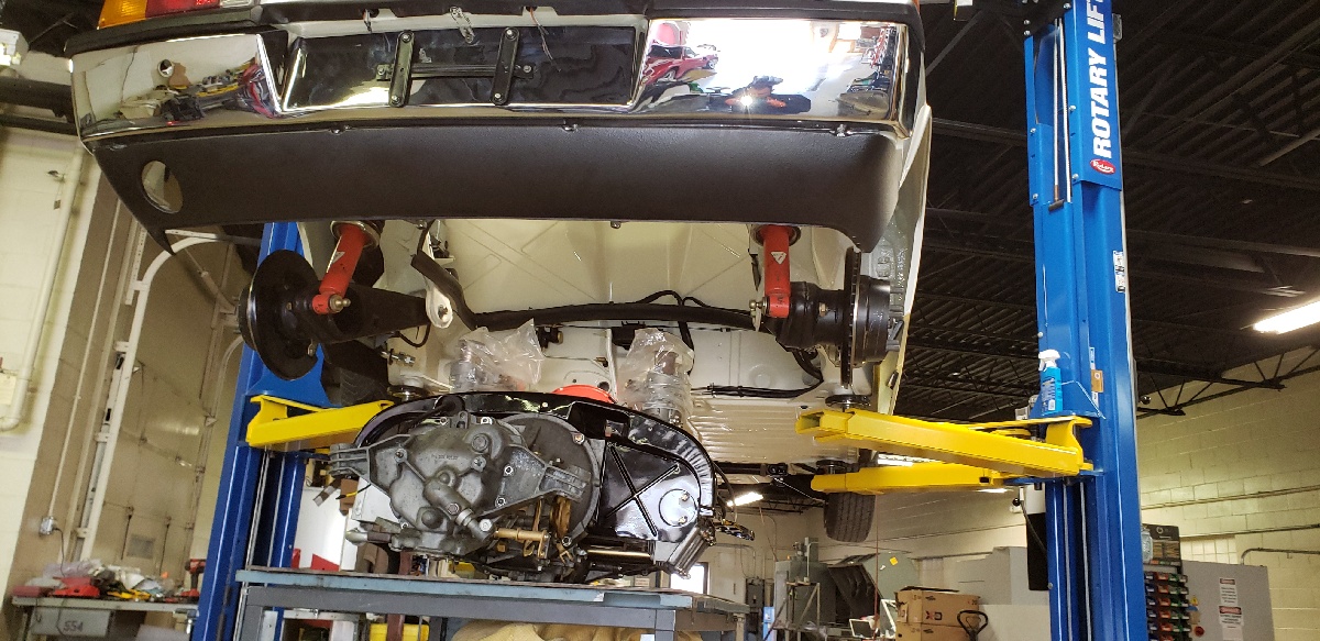

The shop where I used to work has used the HF lift tables for years for 911 engine and trans drops. They have six of them. None have ever failed. They just buy more because they are so useful. That’s about 600-700 lbs on a 3.6 with trans. I’m betting there is no difference in the hydraulic cylinder from harbor freight compared to any others. Use what you feel comfortable with but know that most of what differentiates different brands is only the name and the price.
The tangerine plate is excellent, but only works on a four cylinder.

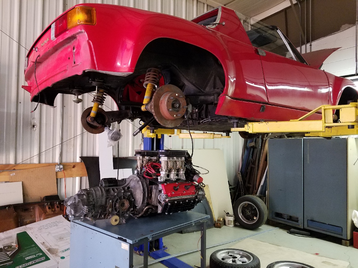

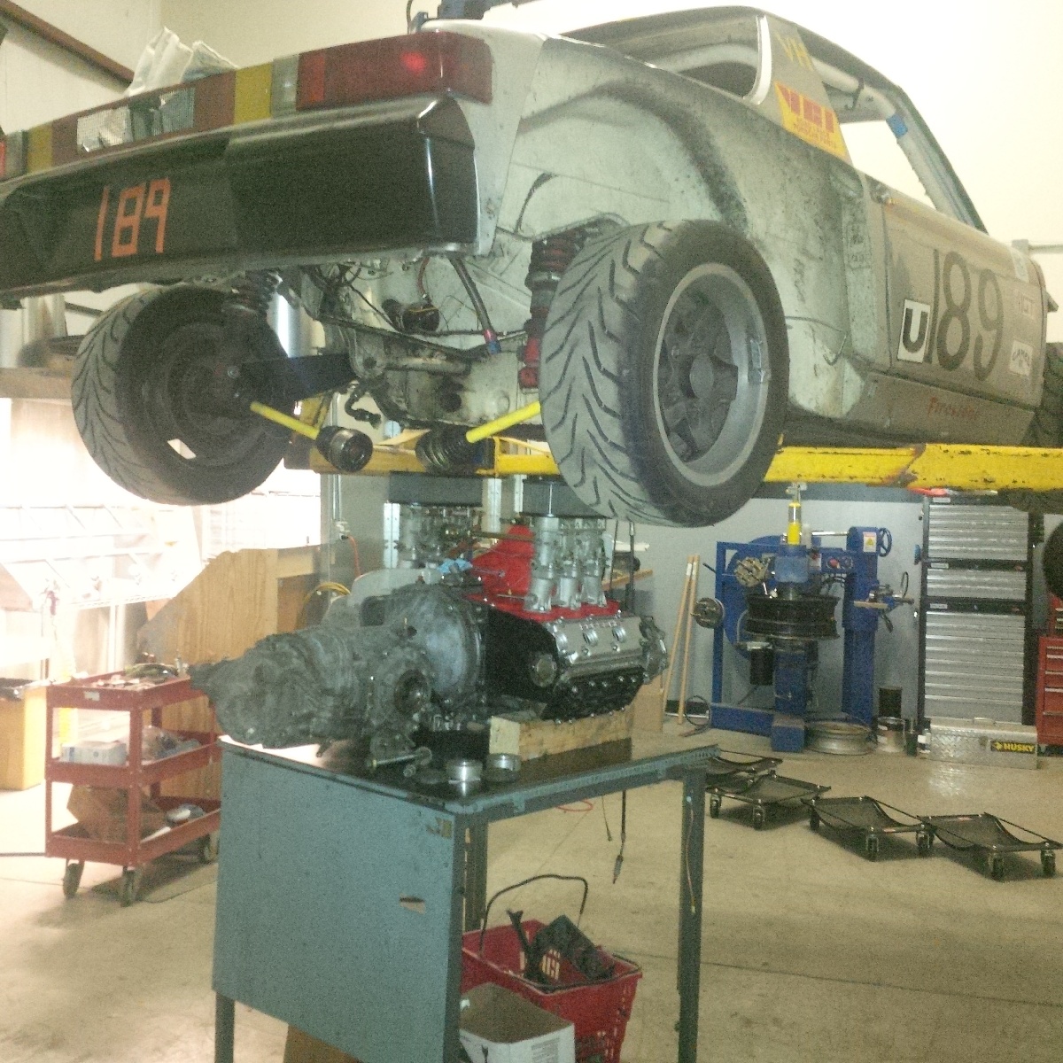

Build a table with casters that will hold 2000ish lbs, put engine on table, put car on your lift, slide table with engine under car and lower car onto engine...easy peasy

QUOTE(gms @ Sep 8 2020, 12:02 PM) *
Yes - as I said that is how I did it last time but don’t have a lift for this one. Nice table, bet that is super handy. Engine looks tasty!

Since I have a lift, I put the car on the lift and the engine on jackstands underneath. I use a plumb bob to align the motor and trans mounts with the chassis. Then I slowly and carefully lower the car on to the motor. Once the mounts are close enough, I bolt up the engine and trans to the body. Then I lift everything back up and hook up all the bits and pieces.
The only hard part is crawling under the car to bolt up the engine and trans mounts. The front mounts are definitely easier on a -4 than a -6.
