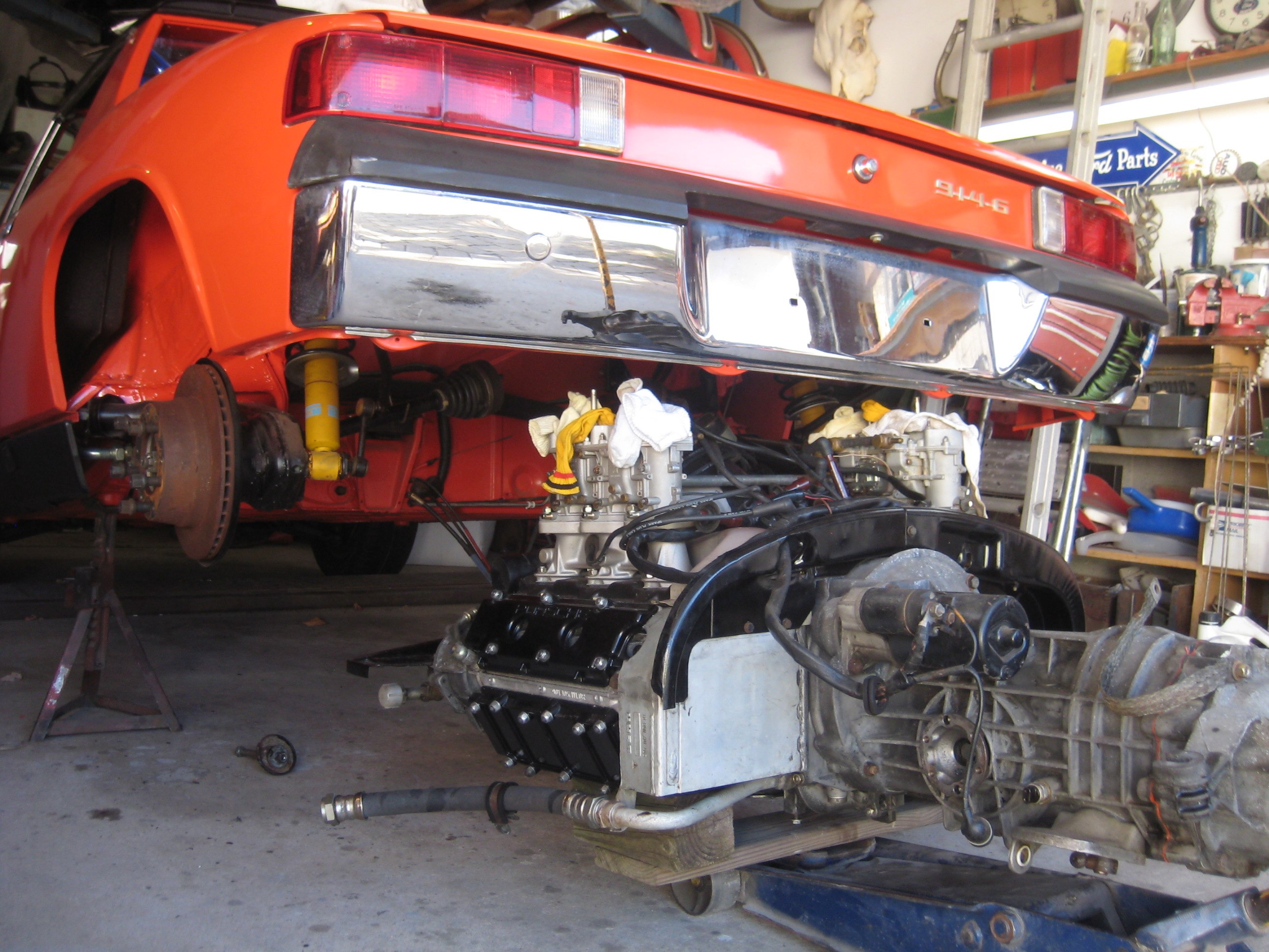

The OP wants to install his 6 engine on the floor using jackstands.
Carbs, alternator and exhaust make a pretty tall package.
What is the collapsed height of the HF lift table ?
How high can you raise your car on jackstands safely ?
Two are stable.....four ? not for me thank you.
A 6 drivetrain has it's largest mass at a distance from the installer which
makes it very unwieldly. With the nose of the car on the ground you'll have the
height, but raising the package between the inner suspension ears has a large pucker
factor.
I've done it in recent times using a heavy floor jack with the exhaust off using a H
shaped wood assembly that supports the engine at the bottom of the cam carriers.
adjust the cross piece fore and aft till it balances.
Lift slowly. Use a long drift pin to guide the front mount into position.

If I were to do it using jackstands, I'd remove carbs for the additional clearance, 4 or 6.

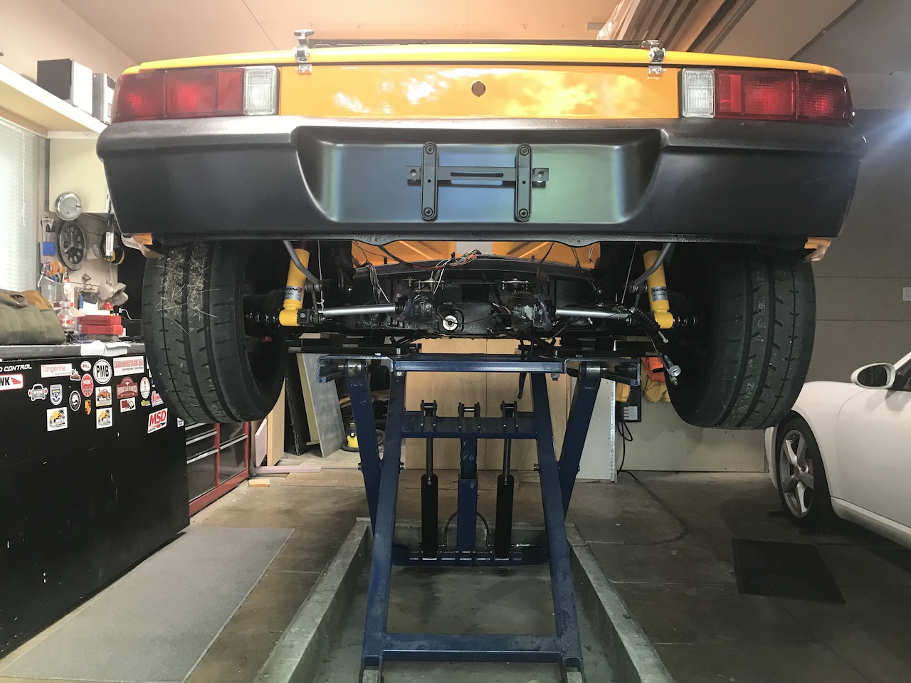

This subject is just in time. With the scissors lift I have I'll build a low table with caster and roll under car per GMS. Thanks, MarkAttached Image

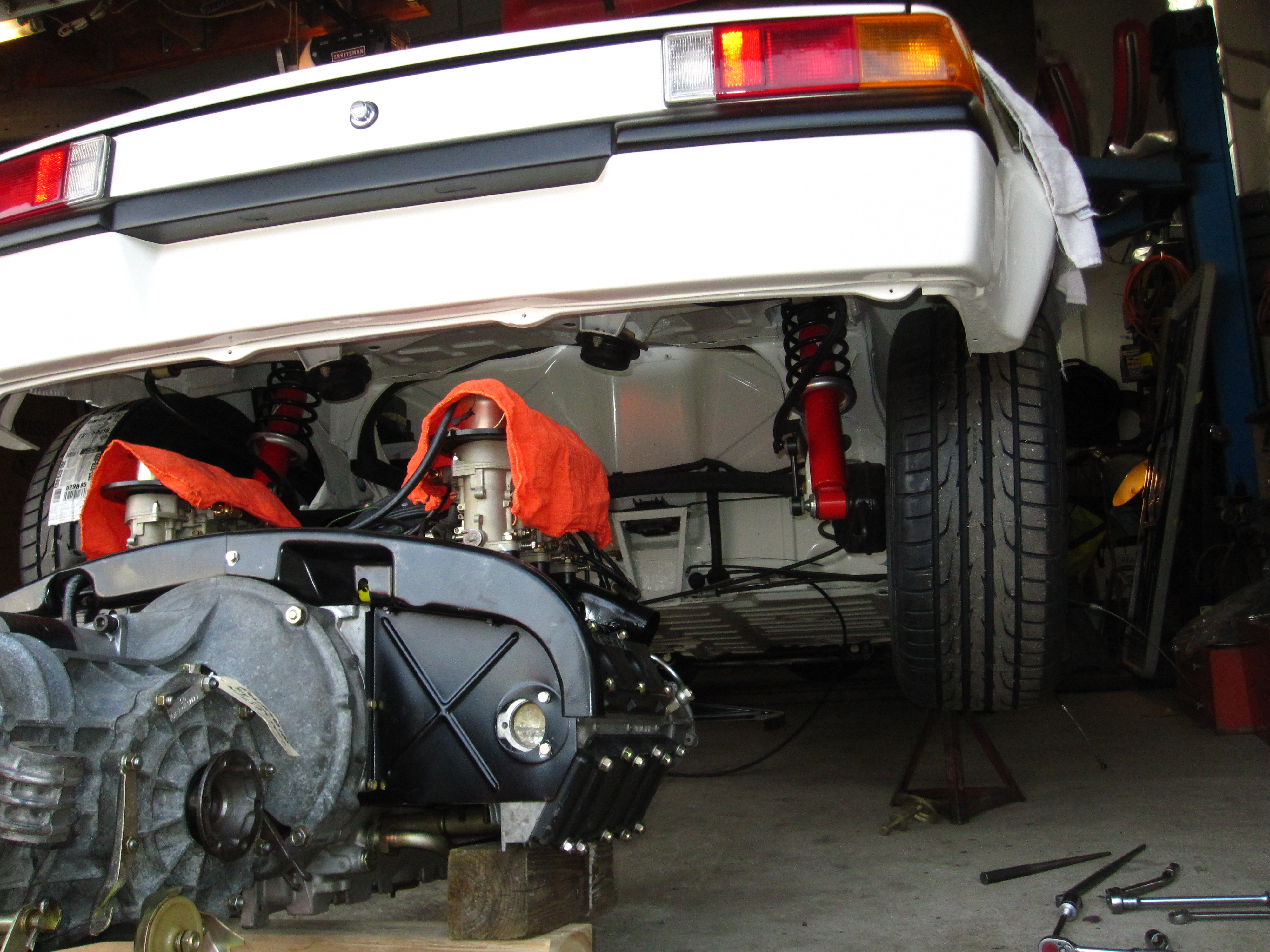

Rear tires and carbs off. Take the carbs off as a unit from the intakes. Preserving your current X bar setting. Furniture dolly with some dunnage. A floor jack under each control arm and take it as high as it will go. Approx the car angle with the dunnage. Roll the engine on the dolly close to where you need to be (drop the outer bar bolts down from the top thru the outer mounts. Helps lining it up). Lower the car slowly down over the engine. Slightly Angle the FJs so you can release both valves at the same time. The car needs be on jack stands to start with the FJs. Mine are the ratchet type but I secure the handles with a few zip ties and just cut them off when finished with them.
