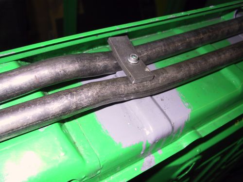

So far, I've used clamps I made from simple flat stock. Not sure what I'll do in the end.

The exact shape and positioning of the lines is quite finicky, I found, in terms of getting the outer rocker cover to fit correctly.
I still need to weld some end fittings on the lines. I'm pretty sure I know a place where I can find fittings with the proper 30 x 1.5 thread. (mm)
Finally the other big challenge will be to get the inside of the lines spotlessly clean. I plan to use lots of mineral spirits and a brush that I'll run through the lines, then to coat the inside with POR-15 fuel tank prep material, after further proper paint prep. The temperature rating of the Por-15 stuff is at least twice what the oil temp is ever likely to reach. I'll probably coat the exterior with regular POR-15 paint.
The steel (as opposed to brass) and all the POR-15 are likely to reduce the cooling capacity of the lines themselves, but I figure that that function can't have been a huge factor to start with, in this particular application, since these oil lines see very little airflow under the outer rocker covers. The situation of the early 911 oil lines was quite different in this regard. Besides, one of the good things about living in Canada is that oil cooling systems don't need to be nearly as efficient here !

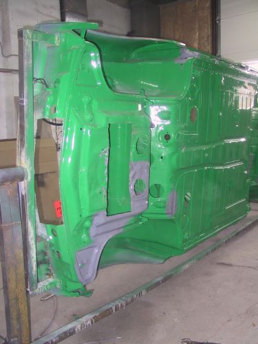

I decided to pay my bodyman a visit earlier today. He was in, and said he was real close to taking my car in. Talked about it a little more, phoned the tow truck and bang, the tub is back in his shop to have the flares welded on and the exterior of the body finished and painted. The fiberglass parts I bought from Getty design should be delivered pretty soon, directly to him.
So, the tub is at the body shop, and the engine is at the mechanic's shop !

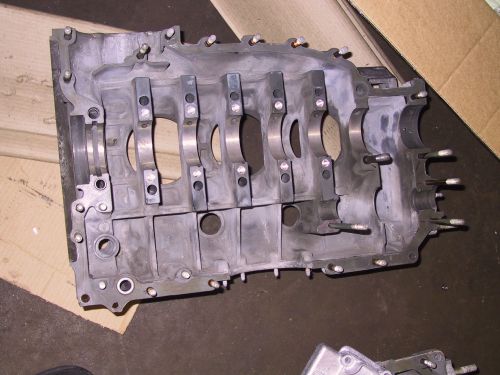

A lot of parts I ordered in ove the past few weeks have started arriving. A bunch of engine parts from EBS, including a 7R case, shuffle pinned, time certed and quite nice,

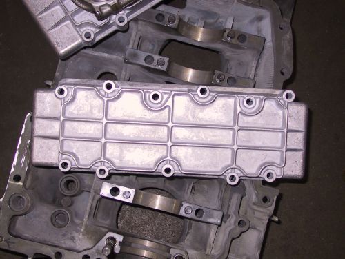

Here's the other half, with lower turbo valve covers. The covers will need to be machined to take the extra set of spark plugs:

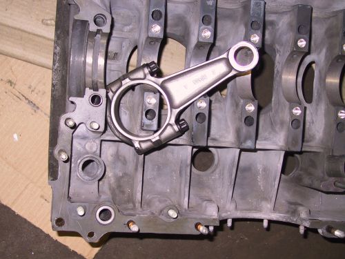

2.0 rods, rebushed etc . . .

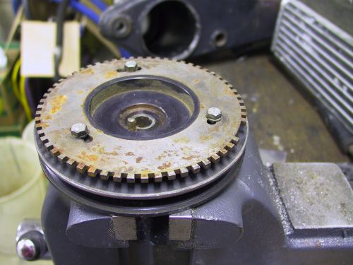

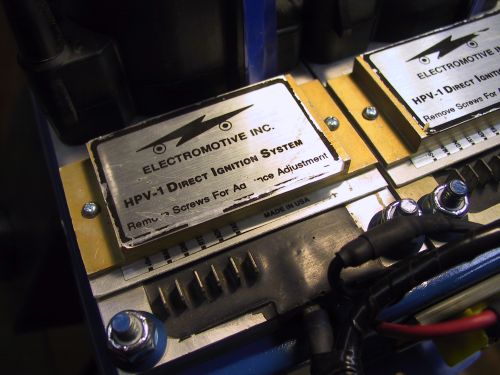

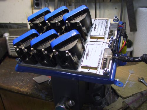

Plus, I got a bunch of ignition stuff. I would have liked to use a big 12 plug distributor, for the vintage look, but they're very expensive (even the recent alternatives) and can't b as reliable as this electronic system. Here's the coils:
michel richard
post Jan 31 2006, 07:52 PM
Post #133
Posts: 1,291
Joined: 22-July 03
From: Longueuil, Québec
Member No.: 936
and the trigger wheel:
michel richard
post Jan 31 2006, 07:53 PM
Post #134
Posts: 1,291
Joined: 22-July 03
Member No.: 936
Here's the detailed id of the system:

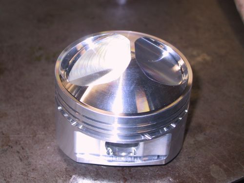

Gratuitous pic of one of my new pistons.
It's a JE piston, 10.5 to 1 (nominal) compression, 90mm.
