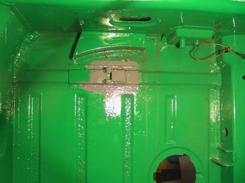

More things done on the tub tonight:
I worked a little more on preparing the driver side long: I cut out most of the threshold plate supports. This may seem radical, but I found that what's left seems be largely enough to keep the plate stiff.

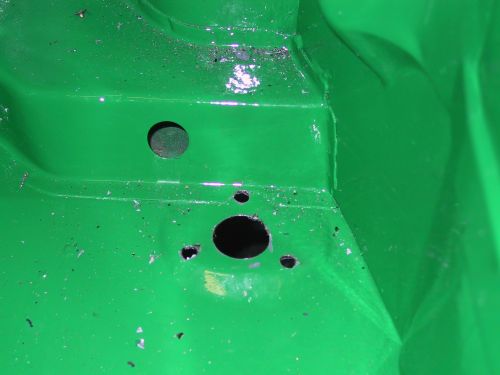

And put the holes in for the front swaybar:

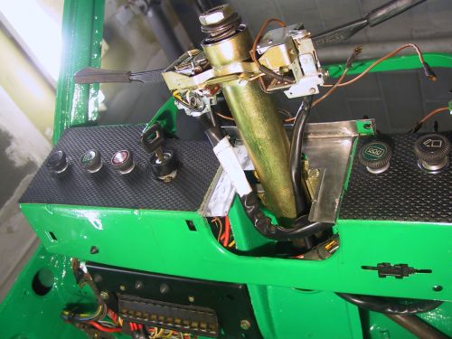

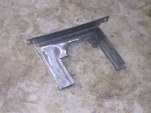

As to the steering column, I'm not sure I will end up using the following, but the current reasonning is that I need to fill-in some of the area around the steering column, on the dashboard, so I made the following piece:

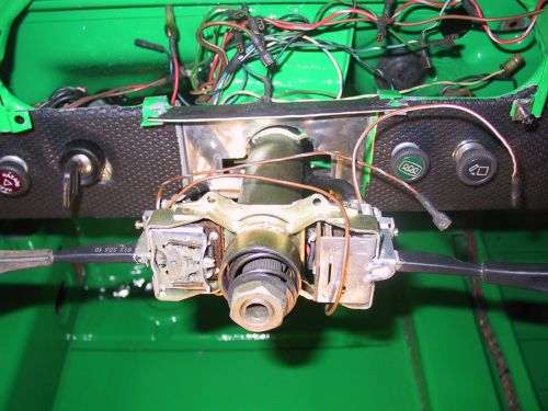

And installed like so:

and so:

The little wings on the side hook up behind the steel sub-dash, the piece's face rests on the steering column support and the top "wings" on the piece will be retained by the same screws that hold the instrument facia.
The plan is to glue some dashboard face material to this, and then to fabricate a pair of the "eyebrow" pieces. We'll see how it turns out. I'm experimenting in public, here !
