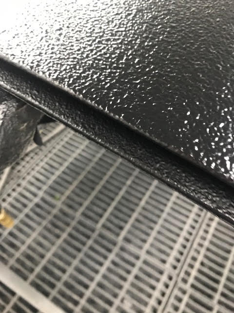

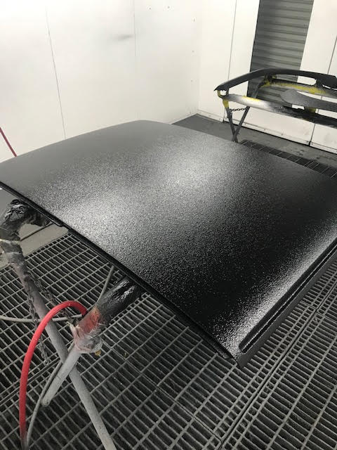

So my top is nearly done... dug through old threads here and ended up using Wurth black SKS with their special gun... then shot with satin (semi-gloss) black--looks real shiny in these pics because it was literally just sprayed, the "shiny" will die down quite a bit as it dries (IMG:style_emoticons/default/beerchug.gif)
Should be picking it up from him next week, need to get new aluminum for the window seals next and pick up the other seals from 914rubber (IMG:style_emoticons/default/beer3.gif)

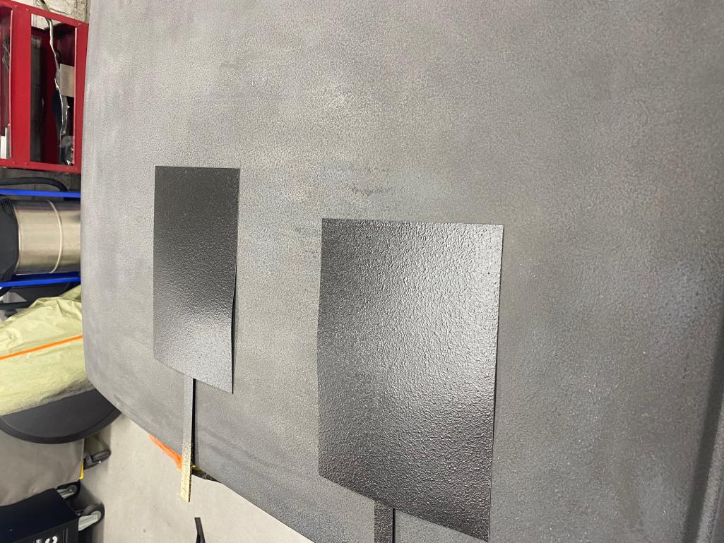

I'm curious what you guys think, I know it's in the bright lights of a paint booth and the paint is wet and more reflective than it will be in real life...but is the texture too thick? Also should I have them remove the texture from the rib that goes into the windshield section?
When I go out and look at my other roof that's factory it looks smoother, but I'm not sure if I'm just being picky. I might have to take my other one up and compare it.

The 1st attempt was too thick IMO, so I brought them up another spare roof with factory texture and we're working on spray outs to get the Wurth SKS to the right consistency...we're getting close, I'll share whatever the magic dilution rate is when we get it exactly right
