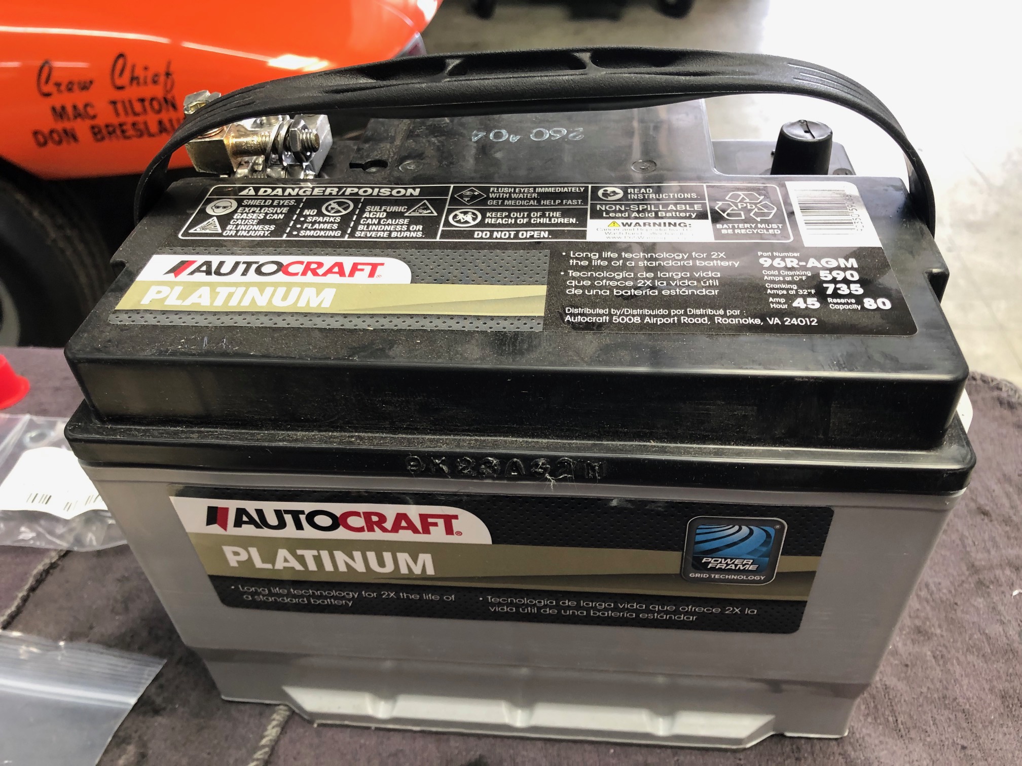

Couldn’t find a 42R in AGM so went with a 96R and the fit is perfect. Haven’t tried the recall cover yet because the battery handle has yet to be removed.
